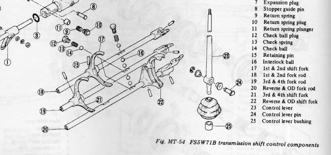

Excuse the crude drawing since I couldn't find any pictures online, but this is a cross section of my striking rod guide and what I saw. When it rotates into 1st or 2nd, the detent pin goes up that ridge and holds it there. But with 5th and R, it stays on that ledge and the force of the return spring and pin pushes it back to center.

Are you using the shifter stick from the F4W71B 240Z transmission or the one that came with the FS5W71B transmission?
There are different lengths between the horizontal achor pin (with the two plastic bushes) and the lower cup bush that fits jnto the striking rod. If that distance is too short it can slipe out of the striking rod in 5th and you will experirnce what you are describing.
If you look at the striking rod. The hole for the shifter is machined in a round striking rod. That means on the left and right side of the hole there will be a curved arch. This is where the cup can slipe out. I hope that makes sense.....
This could be your problem.

Not clear how this could happen considering how the system works.  How does the end of the shift lever get past the 3rd gear rod fitting?  The 3rd/4th rod should be centered and therefore in the way.  I see roll pins.  Maybe something is loose.
It confused me as well. It's impossible to see how it is moving while the tail housing is installed. I did notice the fork where the striking lever engages 5th/R is much larger than the 1st/2nd and 3rd/4th
