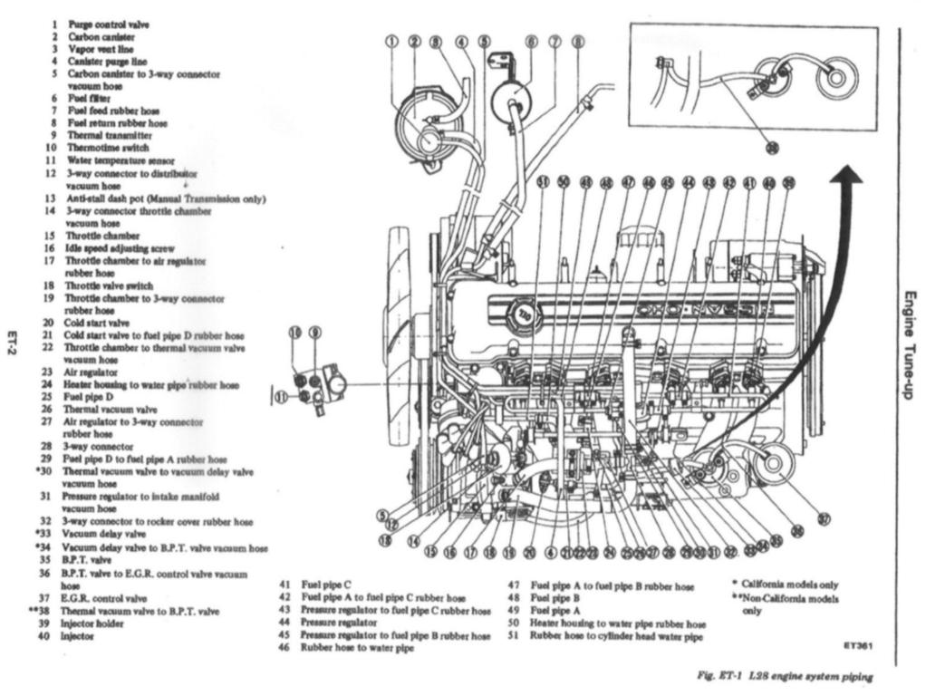

I found an old roll of vacuum hose in my toolbox and it seems like it will work, but the ID feels a tad bigger than the original hose and the OD is much larger. The box is marked 7/64"  It will work for now, but it still doesn't seem like the correct match. I only care about the OD where it goes through the firewall grommet. The thick wall hose will never go through.
