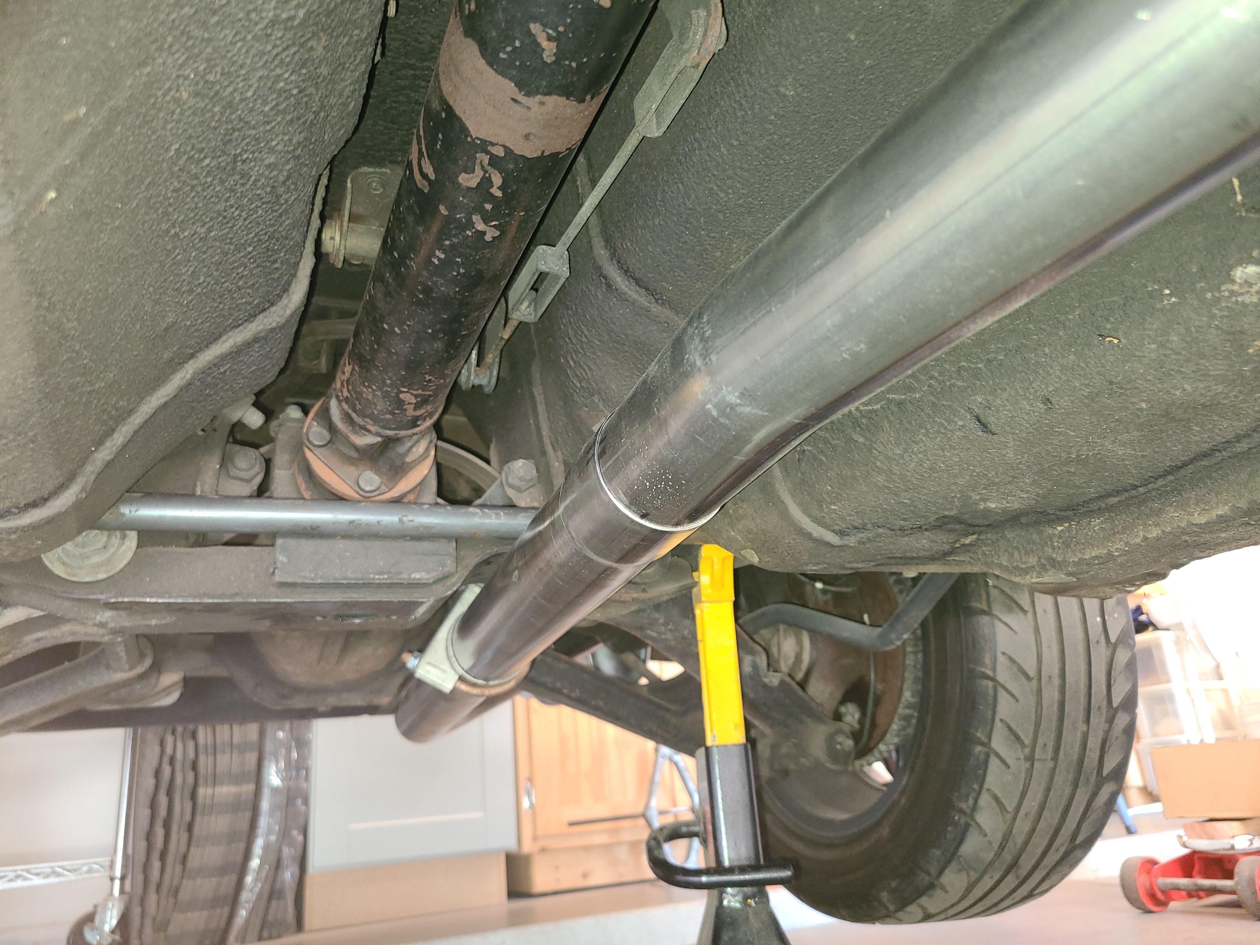

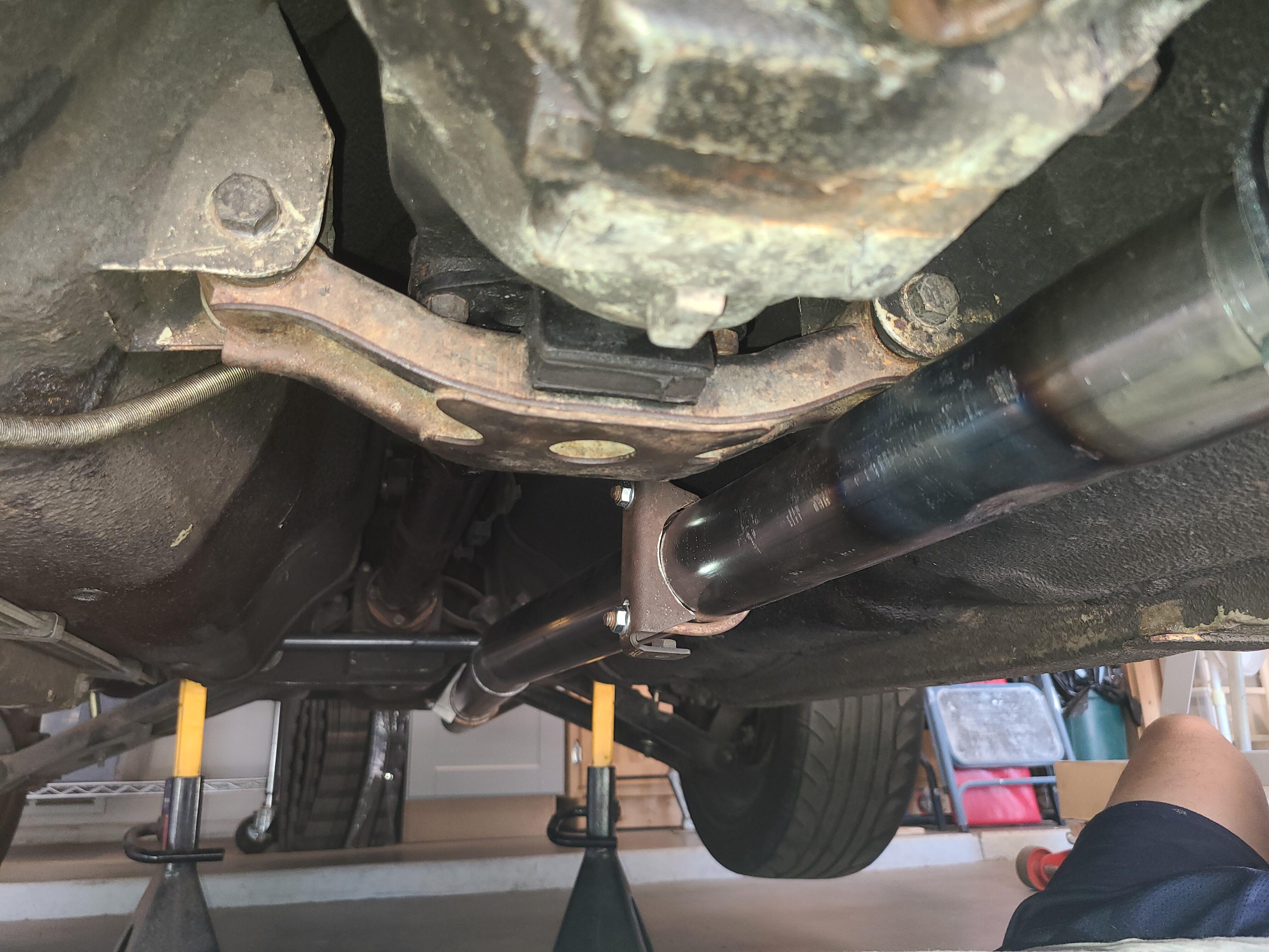

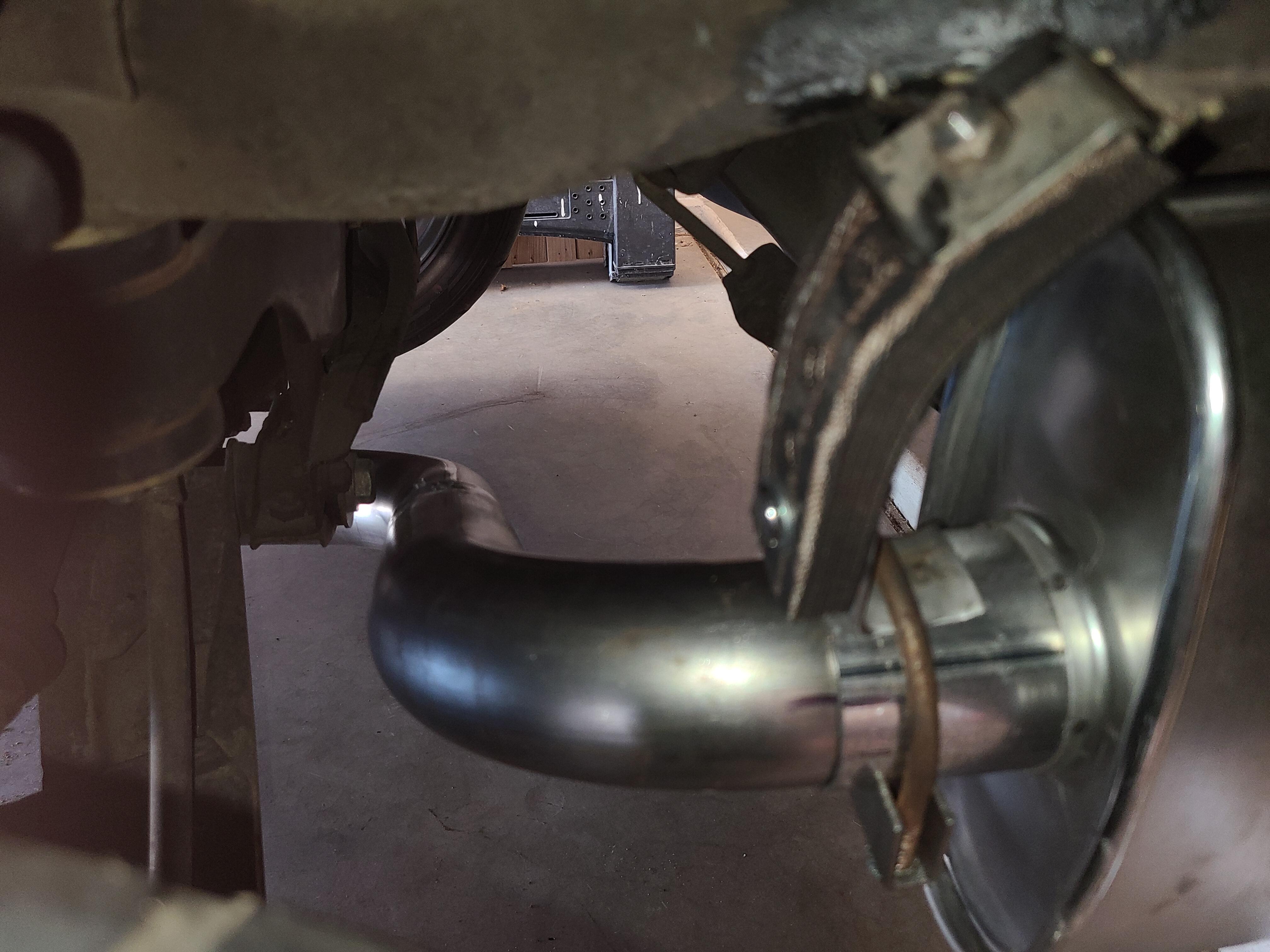

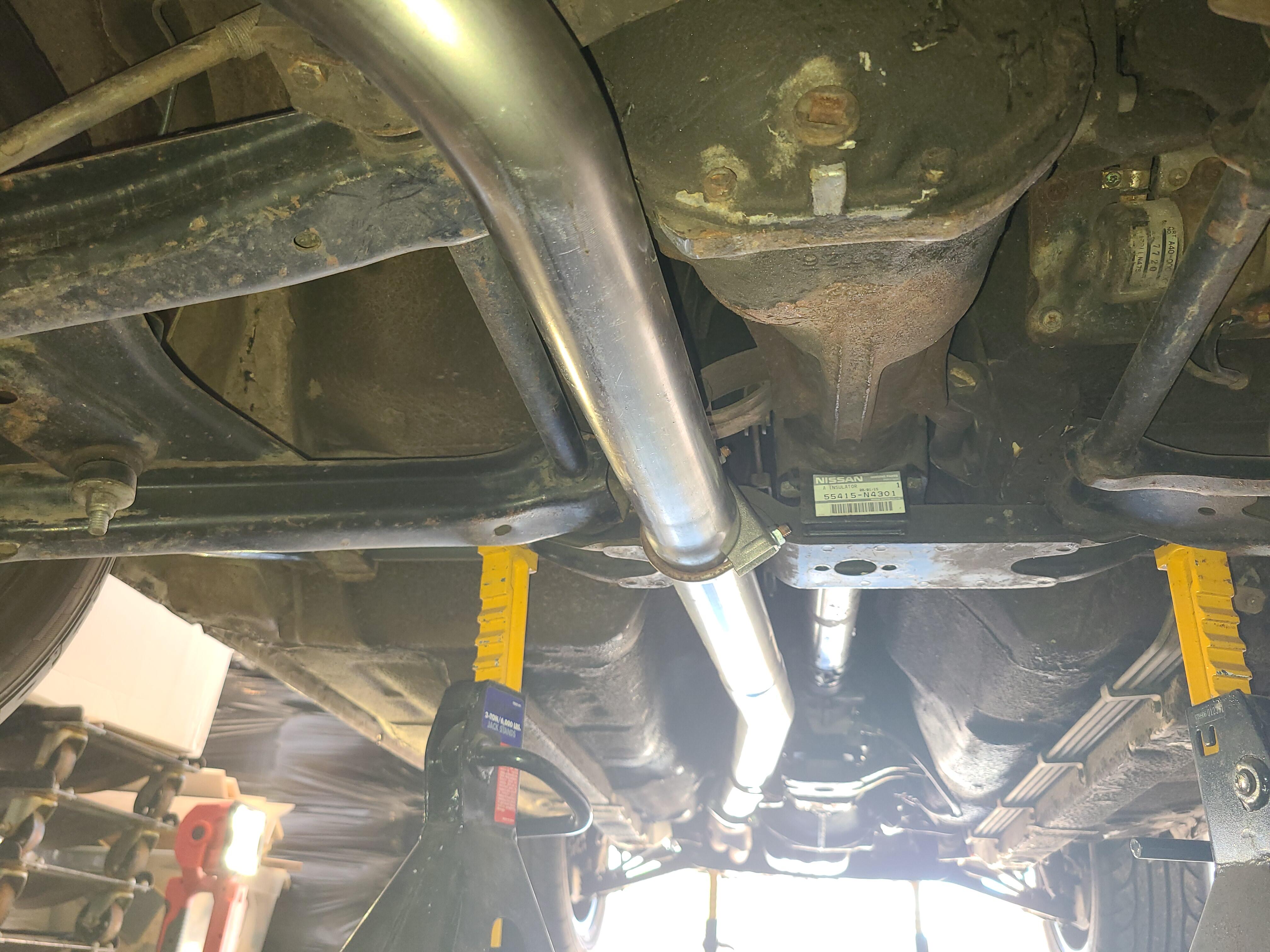

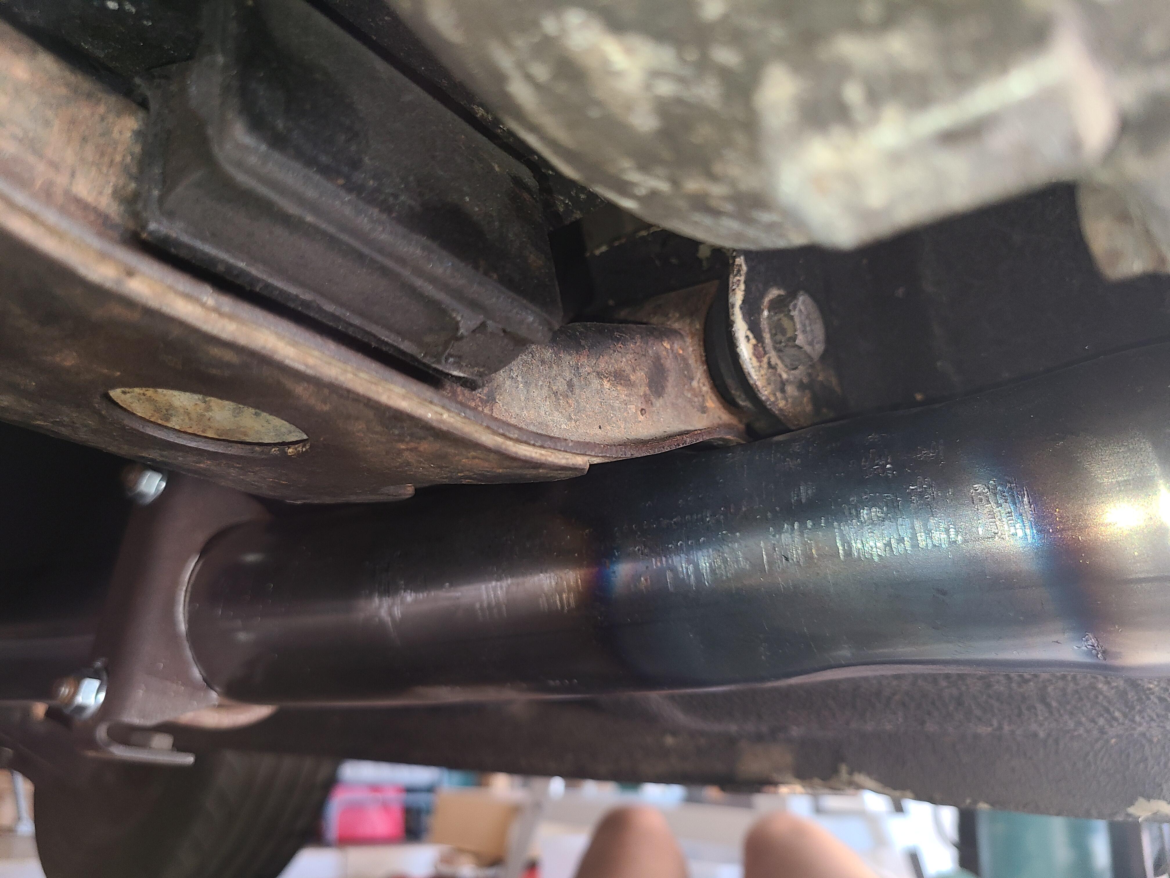

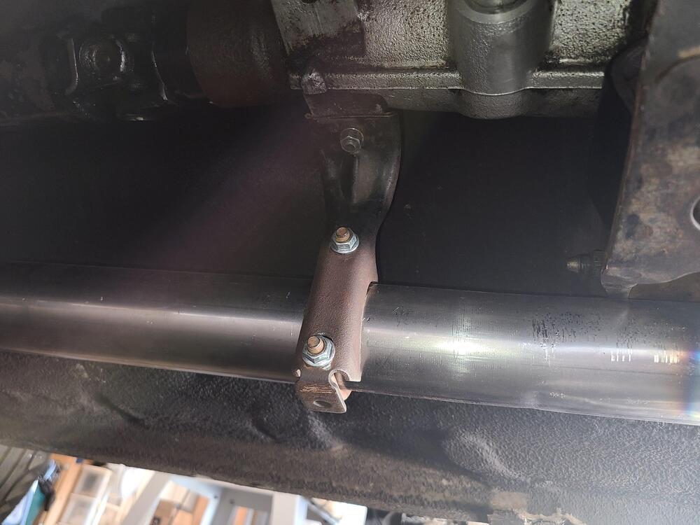

September 30, 20231 yr comment_657637 I got my 2-1/2" collector from Jegs, so I got the exhaust on today. The AZ Z Car header is terrible. The outlet points right at the trans cross member, so I had to heat and beat the MSA pipe a lot to get it to fit. I modified the OE exhaust hanger to fit the 2-1/2" pipe and, of course, I had shortened the Z pipe between the axle and the muffler. Overall, the system now fits great everywhere except right behind the header, where it is still too tight to the trans crossmember. I just need to go buy two more exhaust clamps. I ordered MT90 (or so I thought) from Amazon and it arrived this morning. I opened the box and saw MTL. Somehow, I put the wrong one in the cart, so back it goes. My MT90 will be here tomorrow, so I can't get it off the jackstands and hear the exhaust yet. Link to comment https://www.classiczcars.com/forums/topic/68064-2023-what-did-you-do-towith-your-z-today/?&page=7#findComment-657637 Share on other sites More sharing options...

October 1, 20231 yr comment_657645 I installed the missing U bolt clamps and changed the engine oil before I fired it up to see if it had any leaks or groundouts. It's still on jack stands and there is no oil in the trans, so I kept the clutch disengaged. I think it sounds really good at idle and throttle blips. Time will tell if I have any drone, but maybe the heat and beat I had to do will break up the sound waves enough to keep the drone away. 🙂 Link to comment https://www.classiczcars.com/forums/topic/68064-2023-what-did-you-do-towith-your-z-today/?&page=7#findComment-657645 Share on other sites More sharing options...
