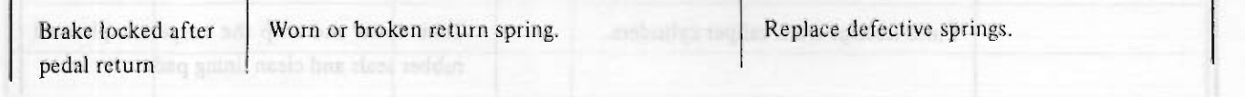

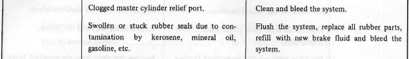

Pretty easy to unbolt the MC from the Booster without removing the hydraulic lines.  Unbolt the warning switch so you get more flex in the lines.
The warning switch does not block flow like it is proposed to do some times.  It just moves the plunger to turn on the light.
There's a troubleshooting chart in the FSM.

I took out the MC and turned the nut in on the booster. There was a good bit of preload on the MC from the booster so hopefully that will fix it. I did take apart the switch and it was absolutely disgusting inside. When I first rebuilt the front calipers I noticed there was a lot of gunk in there, so I'll probably have to take them apart again...
