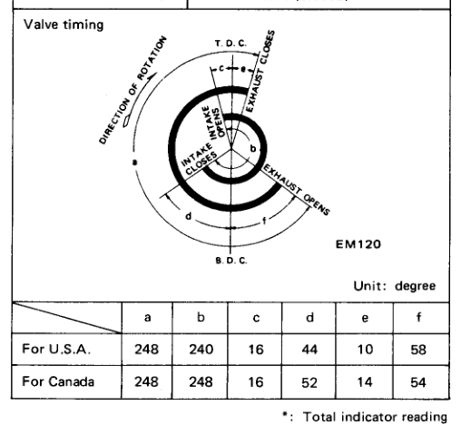

The lift is the same, the valve openings and closings chnage by just a few degrees.
Here's 1982.

I just wanted to know if it was the original cam in the 280ZX L28. I looked at the 1982 FSM but couldn't find a reference to the code on the end of the cam. The AtlanticZ Club cam index shows a "F" code for the NA 280ZX, it doesn't list a "K" code. I have read that the "K" cam was a L24e cam which has very different specs. I haven't decided what to do with this engine but if I can find some flat-top pistons for the F54 the plan is to mill the P79 head 0.080" and build a higher compression L28. At that point the cam will either be reground or simply replaced with a more aggressive one.
