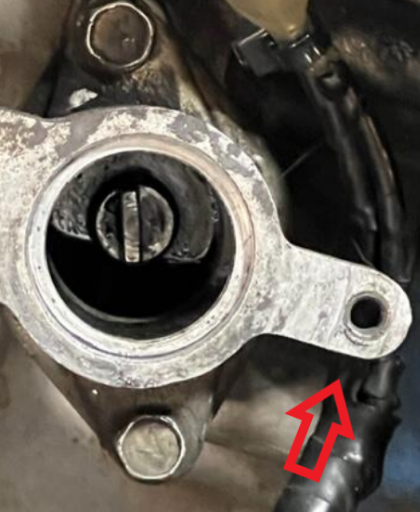

Replaced the distributor cap and had the whole thing out. At TDC,  I looked at the distributor drive, and it looks to align directly with the mounting bolts. I am getting older, but my memory is that the "line" should be off the left edge of the upper bolt with the angle.
I have attached a picture.
So, am I off or should I drop the oil pump and take it over one "tooth"?

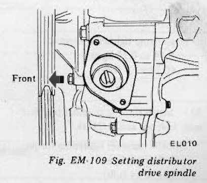

In my serv.man. it says: (page EM20) it should be on 11:25 hour and smaller bow-shape should be facing towards the front.. so.. it looks good!

Looks like the mounting pedestal is backwards.  The clamping screw screw should be to the front.  Might be some other things not quite right.
It's funny how hard it is to find a simple good picture of how the drive quill should be oriented.  Probably why so many people have problems with it.  Nissan never really got it right throughout ll of the years of the FSM.  1978 isn't bad though.
Thanks for the feedback.
Yes, I do run a 240z distributor, so that's why it look like the mounting looks that way. The current distributor has electronic aftermarket in it, but I do have another one with points. Need to clean up the vacuum plate on that one.

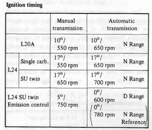

On the initial timing, you need to know what's in your distributor and if it's working right.  Looks like Nissan used a different distributor for emissions engines, according to the FSM.
When you have your timing light on, watch the mark as you rev the engine.  Estimate how high it goes above about 2500 RPM.  It should rise to well above 20 pretty quickly.  If you have a dial-back light you can get an exact number.
p.s. also not uncommon for the old damper/balancer rubber to be bad.  The timing marks might be incorrect.
Here's the 1972 tune-up specs.
