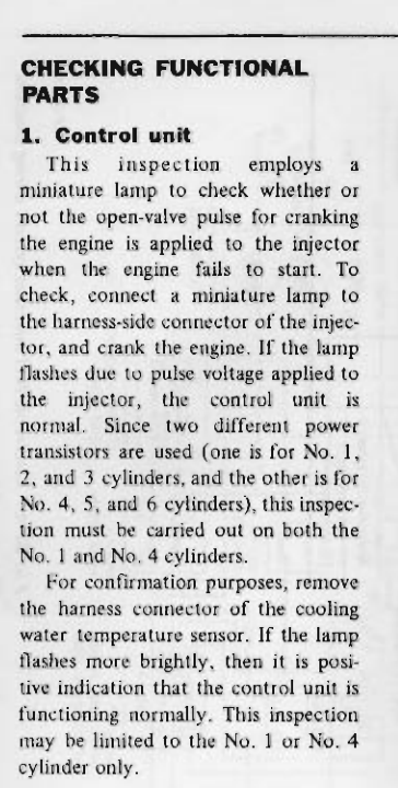

March 7, 20232 yr comment_651119 On 3/7/2023 at 2:08 AM, milligan21 said: Also through the ECU tests This is the most important one. It shouldn't be an also, it should be the first thing. Have you checked for injector activation using the lights? Over here we call them "Noid" lights for some reason. Link to comment https://www.classiczcars.com/forums/topic/68110-efi-datsun-z-only-runs-with-throttle-slightly-pressed/?&page=6#findComment-651119 Share on other sites More sharing options...
March 7, 20232 yr Author comment_651125 On 3/7/2023 at 2:14 AM, Zed Head said: This is the most important one. It shouldn't be an also, it should be the first thing. Have you checked for injector activation using the lights? Over here we call them "Noid" lights for some reason. Yes I checked using a Christmas tree light Link to comment https://www.classiczcars.com/forums/topic/68110-efi-datsun-z-only-runs-with-throttle-slightly-pressed/?&page=6#findComment-651125 Share on other sites More sharing options...
