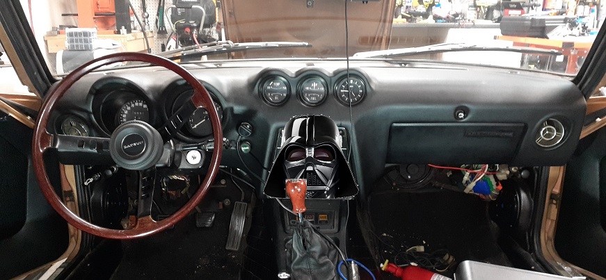

February 1, 20232 yr Popular Post comment_649906 Probably just me, but when I see the 240 dash, I see this: Link to comment https://www.classiczcars.com/forums/topic/68116-differences-between-240z-and-260z-dashboards/#findComment-649906 Share on other sites More sharing options...
February 2, 20232 yr Author comment_649952 The dash cover supplier agreed to take care of the issue and I just mailed the 240z leather cover back to them in the UK. Hopefully, they will send the right one now. The door card covers and center console covers from them worked out well. Captain Obvious: Yes, you are correct, it is just you. SteveJ: Your second picture looks like my dash, except I ran the wires behind the dash ; )  Link to comment https://www.classiczcars.com/forums/topic/68116-differences-between-240z-and-260z-dashboards/#findComment-649952 Share on other sites More sharing options...
