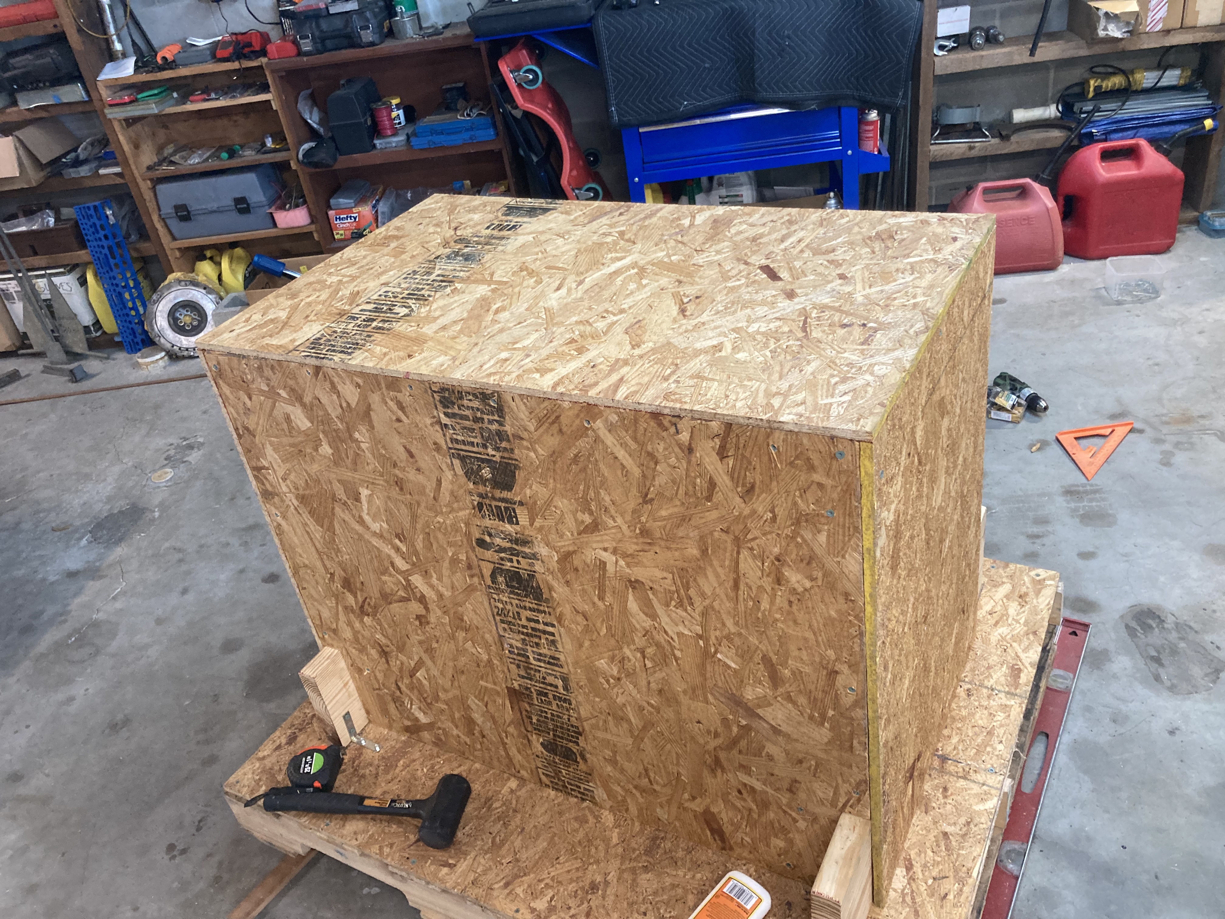

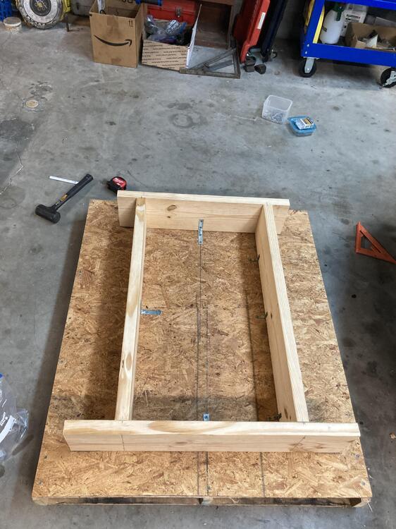

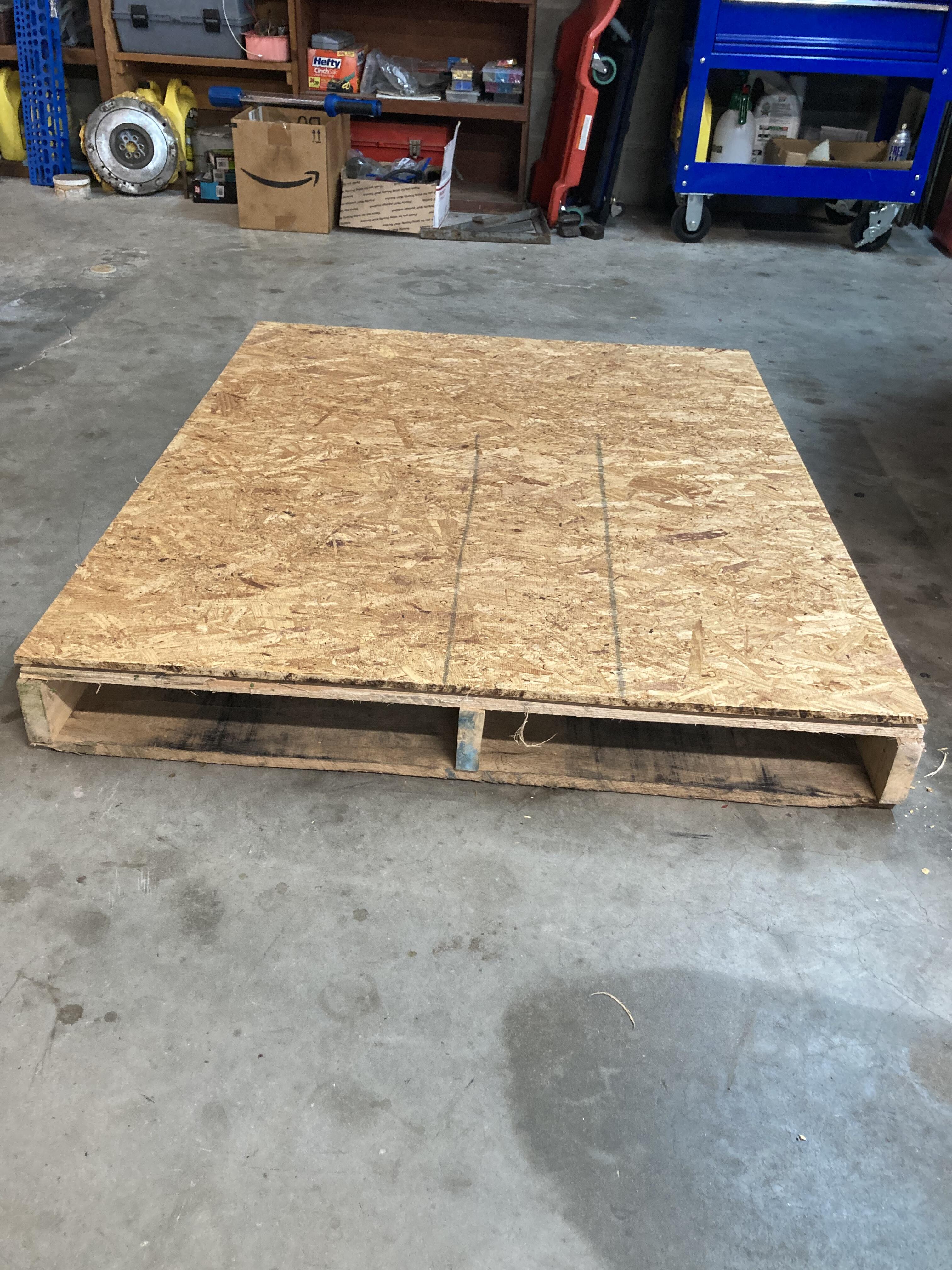

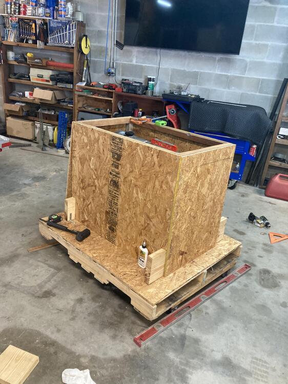

I’m ready to ship my long block to Eiji at Datsun Spirit. Looking for ideas on building a crate for shipment.
seen a few pics out there but most look like a good portion of the oil pan is supported by the wood frame. Any help or advice is much appreciated. This will be a round trip affair. Thanks in advance.
Have you checked with Datsun Spirit for suggestions? I've never shipped an engine but it seams that you would want the engine supported by the points its supported in the car: engine mounts and transmission bellhousing.
Warning: Once again... I don't know what I'm talking about.

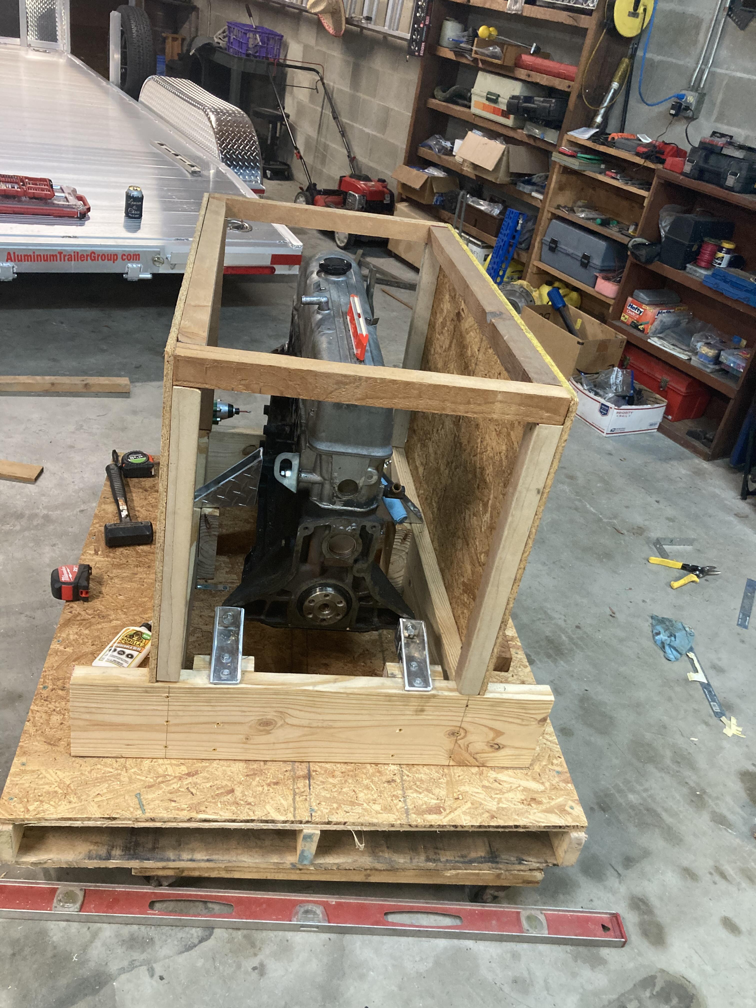

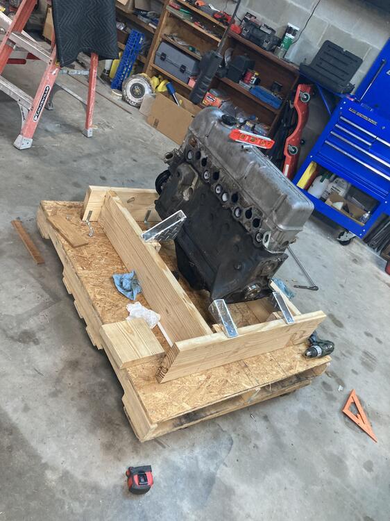

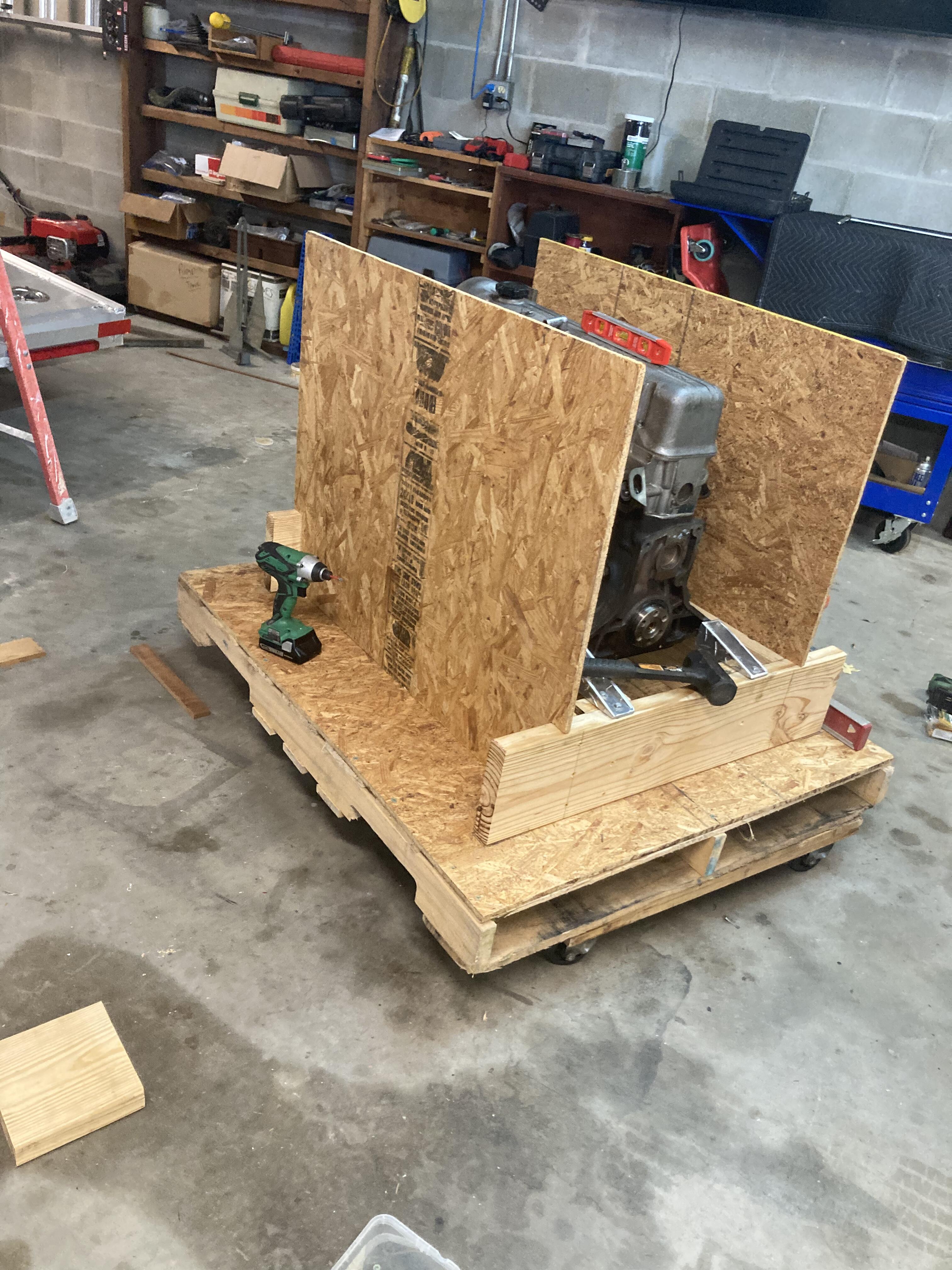

He sent me some pics and his that he makes is pretty much all wood. I’ve got a metal fabricator next door that can make brackets for me if I can make templates. My thought was using the existing motor mount location on each side and the two lower bell housing holes on the rear.
just looking for other ideas out there that others have had success with. Once it’s on the truck who knows what happens. More concerned about the return trip than anything.  Thanks
Put the engine on a block of wood,  that's under the oilpan edge and under the standard mounts, then put it complete in a box made of plywood and do not use nails but glue it together and use screws to put it all together, make a "floor" part and a "cap" part so they can take it apart and not distroy it. they can use it again to send it back to you. you can screw the top or use bands to keep the floor and top together what ever you prefer!
