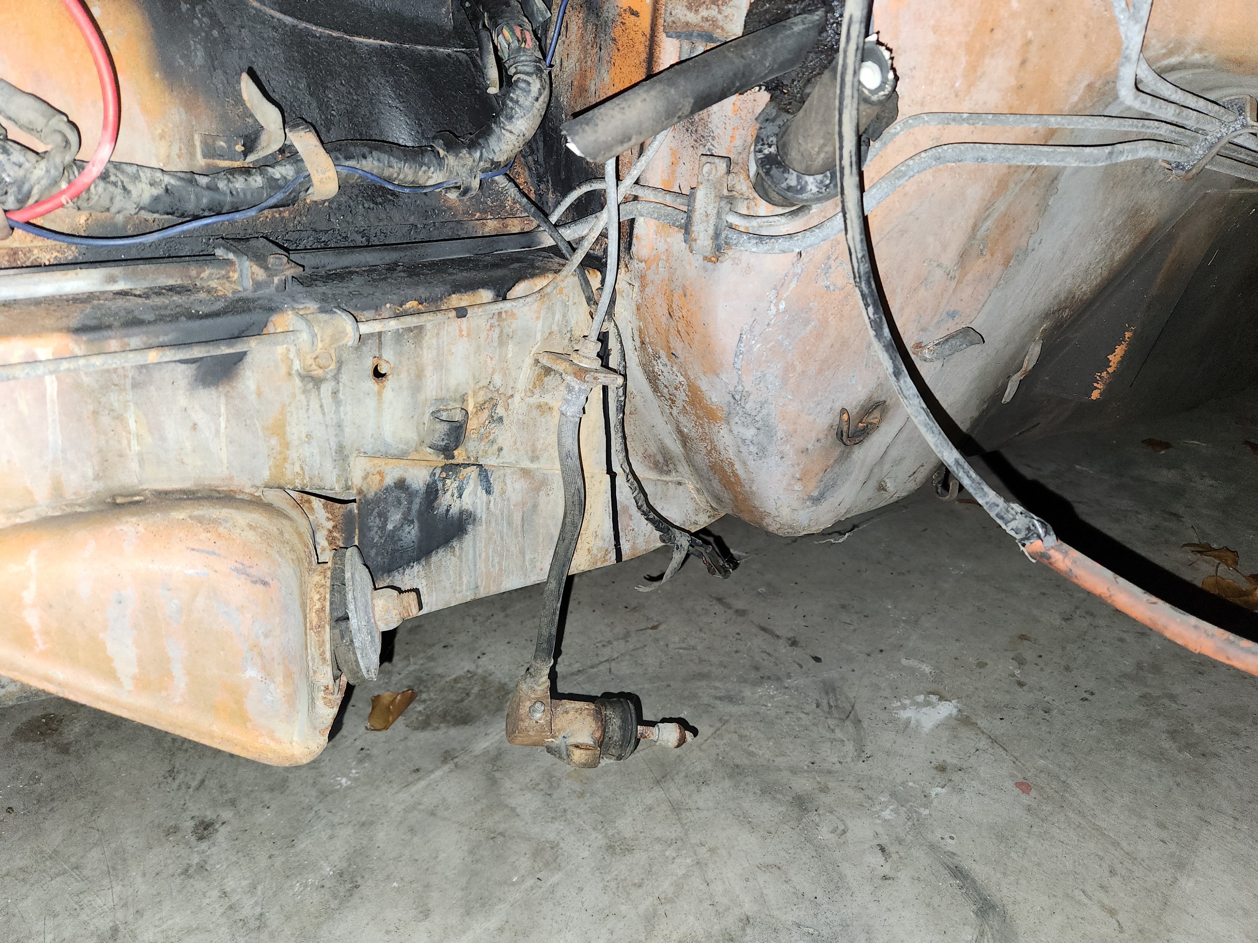

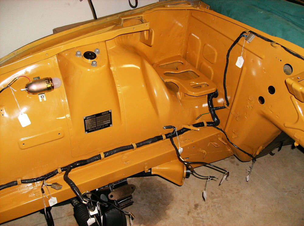

Here are two pics - one without the hard lines and one with them in place. If you can obtain a clutch hard line from a parts car, it should help you to position the bracket on the frame rail. Hope this helps.

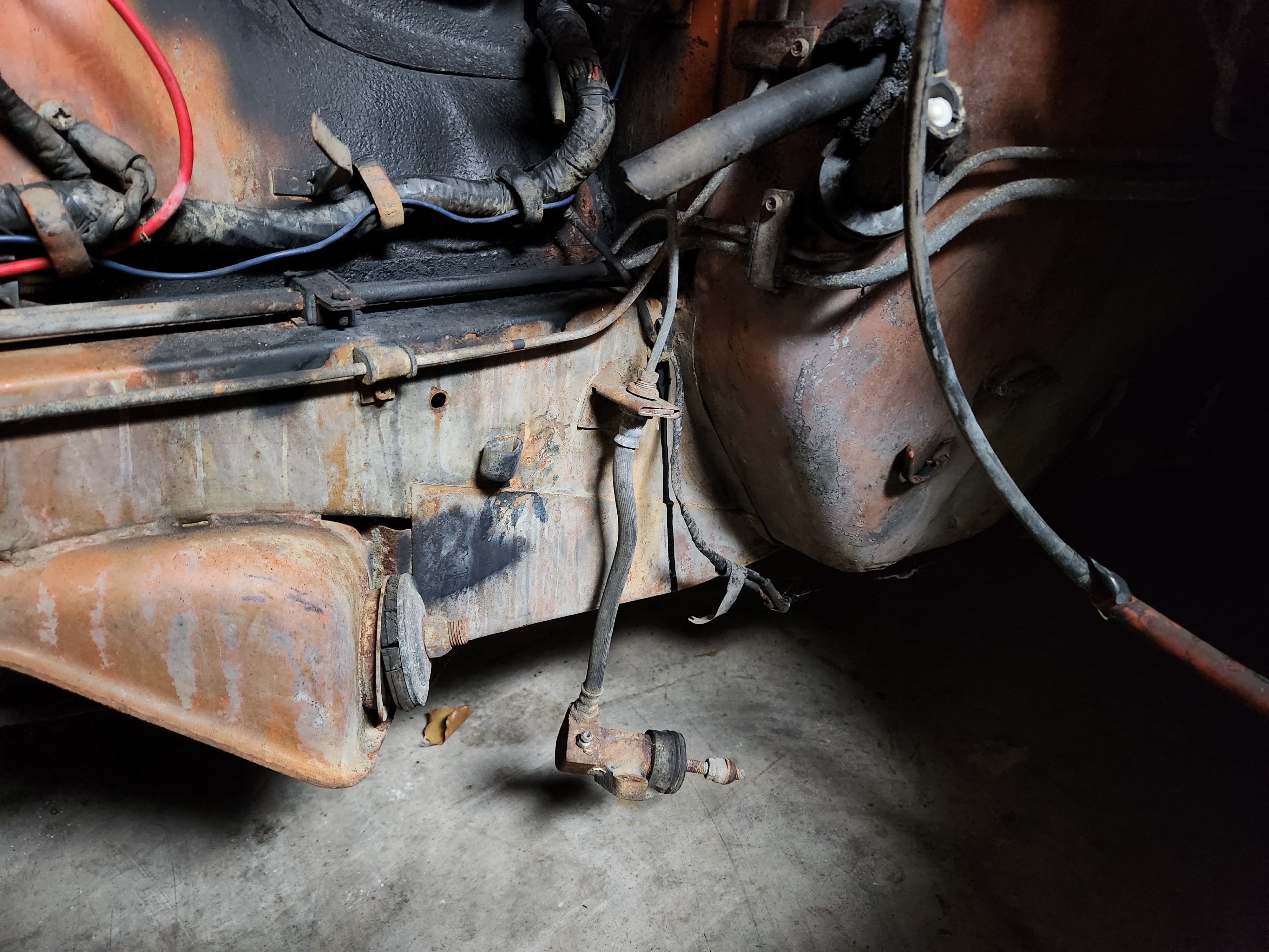

Here are a couple more pix showing this area with a line and slave attached.

Have a look now, I've attached them differently this time.
