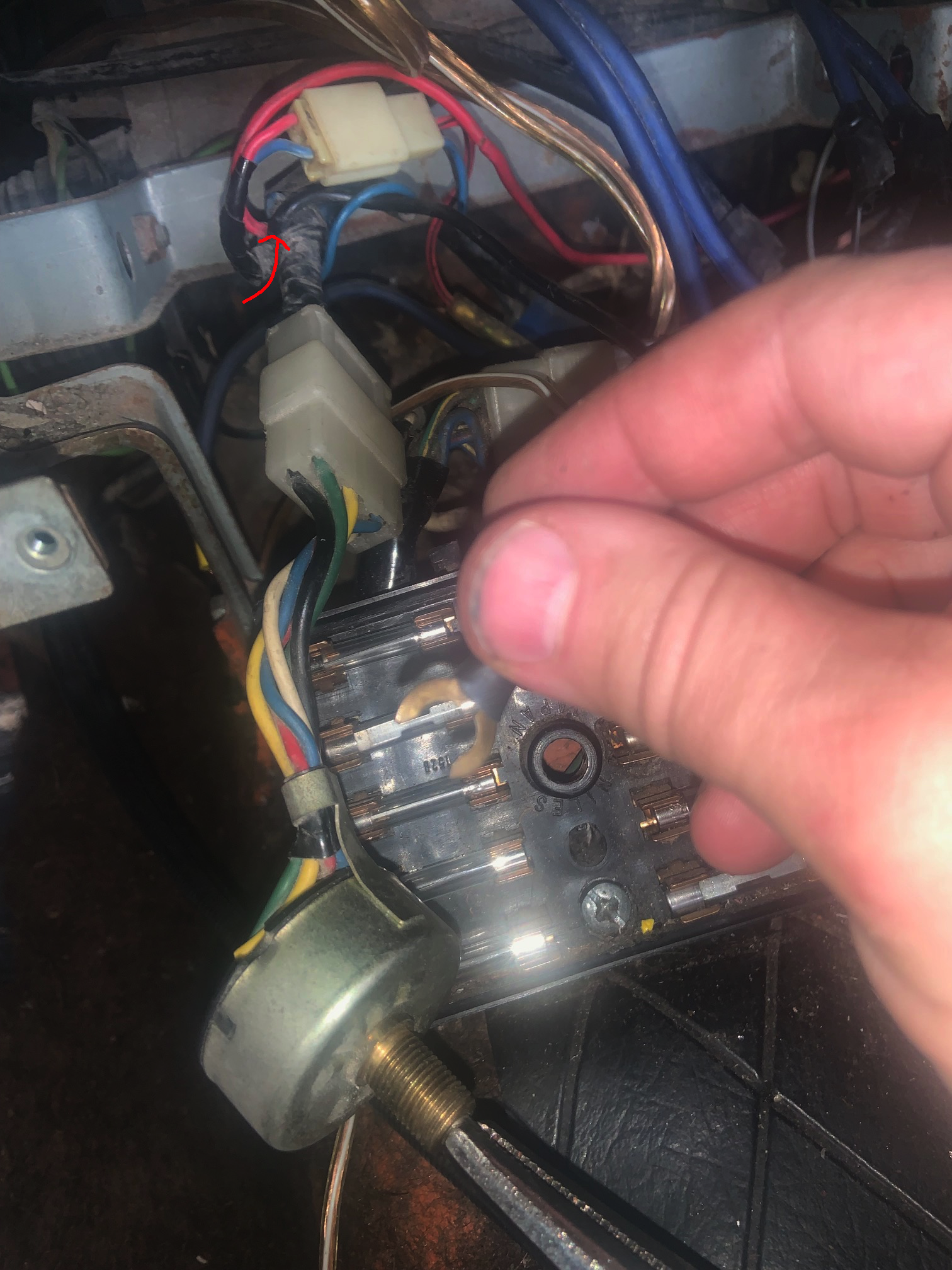

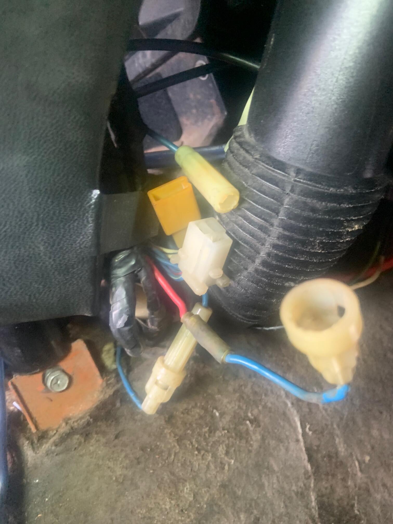

Posted February 15, 20232 yr comment_650311 Guys I am lost here. I was putting my AC console all back together and AC did work when it used to just a day ago. When i turn the switch...nothing. In image 2, this came loose. Looks to me like a ground? Also it comes from wire harness that connects to AC switch. I found a hidden fuse i didnt know existed. It was blown, photo 1, numbered 3. I had ignition on and the above shown wire in photo 2 not grounded. I put a new fuse in, it got orange hot and blew. I turned ignition off. I grounded that wire, hopefully right thing to do? I then put in another fuse. It blew too. Any thoughts. btw, i have 2 connectors number 1 and 2 that dont go to anything. curious what they are. will start trying to look it up, but if anyone knows would appreciate it. Edited February 15, 20232 yr by Wally Link to comment https://www.classiczcars.com/forums/topic/68142-ac-fuse-keeps-blowing/ Share on other sites More sharing options...

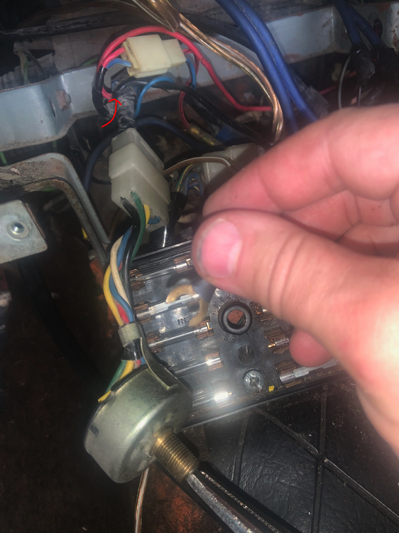

February 15, 20232 yr Author comment_650314 I bought an AC kit from zcd. i think vintage air made it. All new. Had it professionally installed. was working fine. i took panel off to get to instrument panel. when i was done i put things back on like they were. AC wouldnt work. Thats when i started investigating and found those fuse back there kept blowing. The wire i am holding is black... the small red arrow is where its located in the harness. Here is another image with color of wires clear Link to comment https://www.classiczcars.com/forums/topic/68142-ac-fuse-keeps-blowing/#findComment-650314 Share on other sites More sharing options...
February 15, 20232 yr Author comment_650316 Look like the blue part is to blower power, #34? and the red wire #55 short clip of fuse blowing IMG_4711.MOV Edited February 15, 20232 yr by Wally Link to comment https://www.classiczcars.com/forums/topic/68142-ac-fuse-keeps-blowing/#findComment-650316 Share on other sites More sharing options...
February 15, 20232 yr comment_650317 The inline fuse holder is for your fan. The larger three wire connector is for the antenna. The three wire stacked connector is for the radio. Black is typically ground. Link to comment https://www.classiczcars.com/forums/topic/68142-ac-fuse-keeps-blowing/#findComment-650317 Share on other sites More sharing options...
February 15, 20232 yr Author comment_650318 okay. i cant tell from this image you attached as easily as the one i did...but there are 2 inline fuses right beside each other. If the one thats blowing is the fan would that stop any activity from the AC and blower? Because nothing is happening. Link to comment https://www.classiczcars.com/forums/topic/68142-ac-fuse-keeps-blowing/#findComment-650318 Share on other sites More sharing options...
February 15, 20232 yr comment_650319 The other inline fuse is for the radio. The one with red wire is for the fan. Link to comment https://www.classiczcars.com/forums/topic/68142-ac-fuse-keeps-blowing/#findComment-650319 Share on other sites More sharing options...
