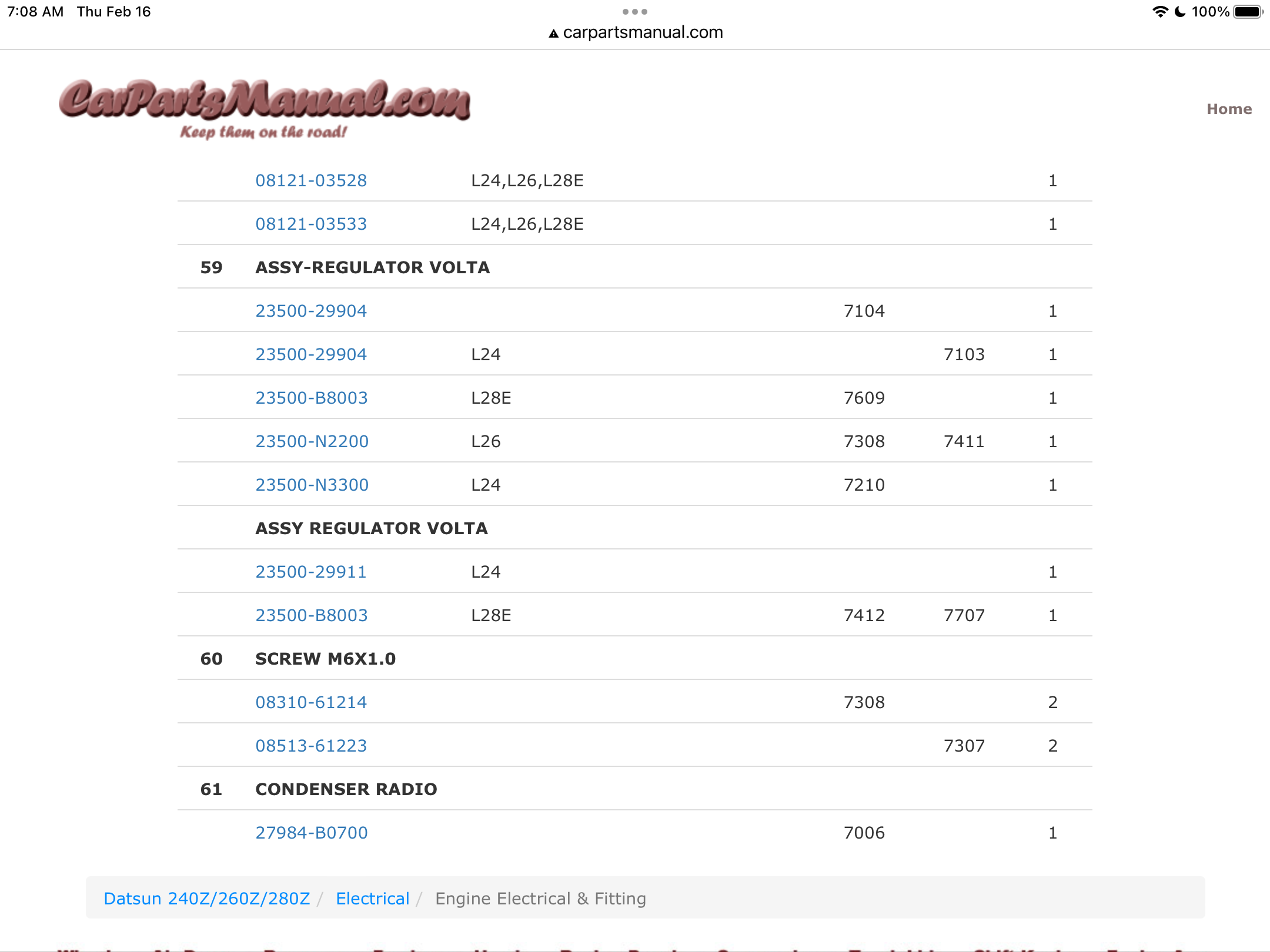

February 16, 20232 yr comment_650344 It is a voltage regulator. The plug style was used 75-78 and possibly late 260. Early 260 had a one time only round solid black plug, all 240’s had a 6 pin rectangular flat pinned plug. The parts fiche gives you an idea of how many unique ones were made and start and stop dates. All do exactly the same thing. You could switch plugs and use a reg from any year technically. At some point in the late 280’s the alternators went to the internally regulated style (designations starting with LR rather than the earlier LT) and the external regulator nonsense was put to rest. Many replacement regulators you buy today have transistor based relays rather than mechanical ones for enhanced reliability if you are stuck with an LT alternator. Common practice now is to use later GM or later Nissan alternators with higher output anyway. Tons of threads here and else suggest what you might use. Edited February 16, 20232 yr by zKars Link to comment https://www.classiczcars.com/forums/topic/68146-what-is-this-part/#findComment-650344 Share on other sites More sharing options...
