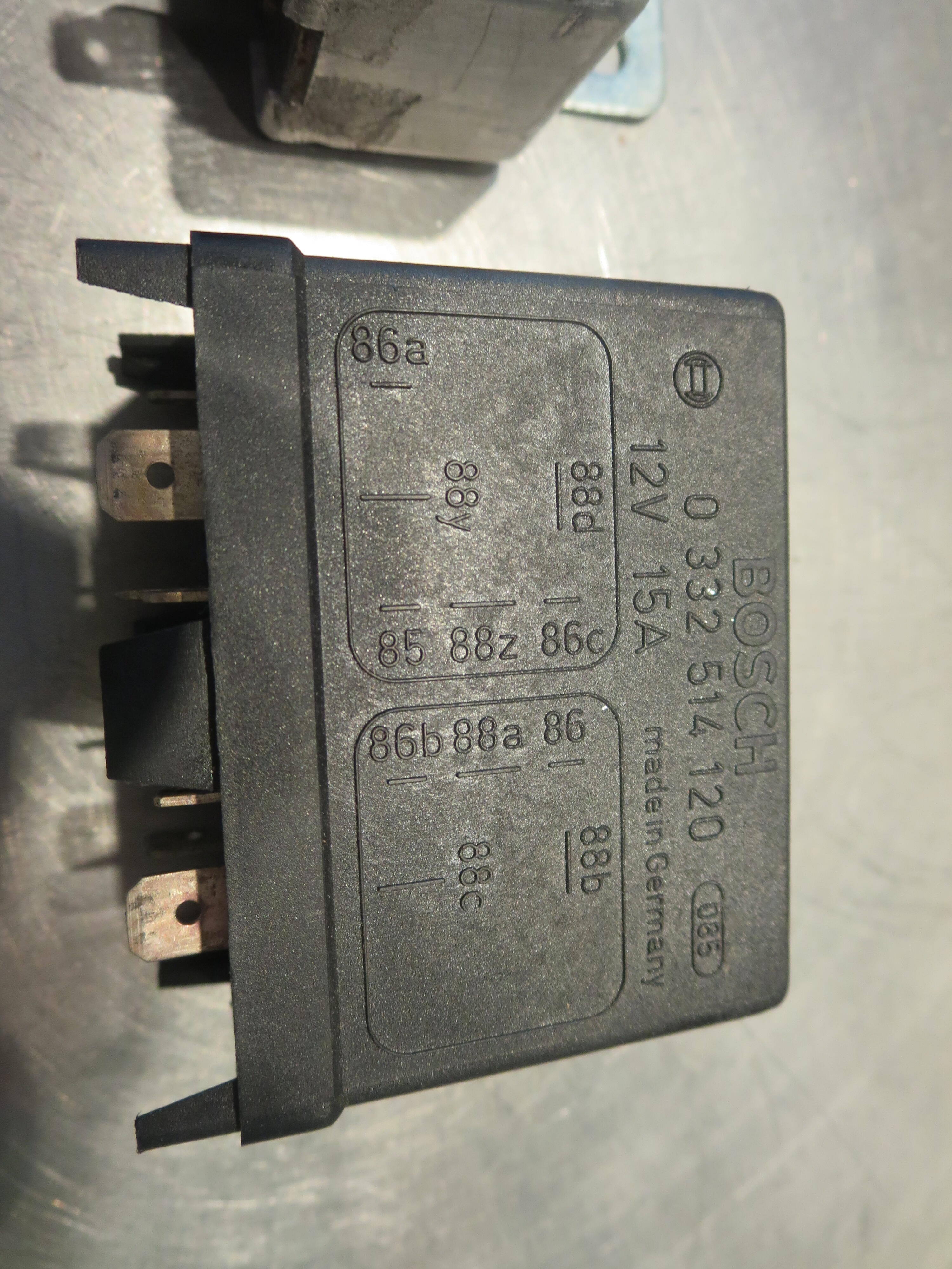

You won't find a single relay to replace the EFI relay UNLESS you use a relay designed for the Bosch system. The nice thing is that you can still find the relays. Just look for the EFI relay on a Beetle. It's the same.
Just google Bosch 0 332 514 120 and you will find them for the Porche 912E, BMW's, Mercedes, Opels, Volvo, Peugeot etc.
It will plugin and work perfectly.

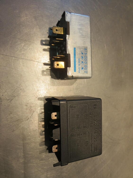

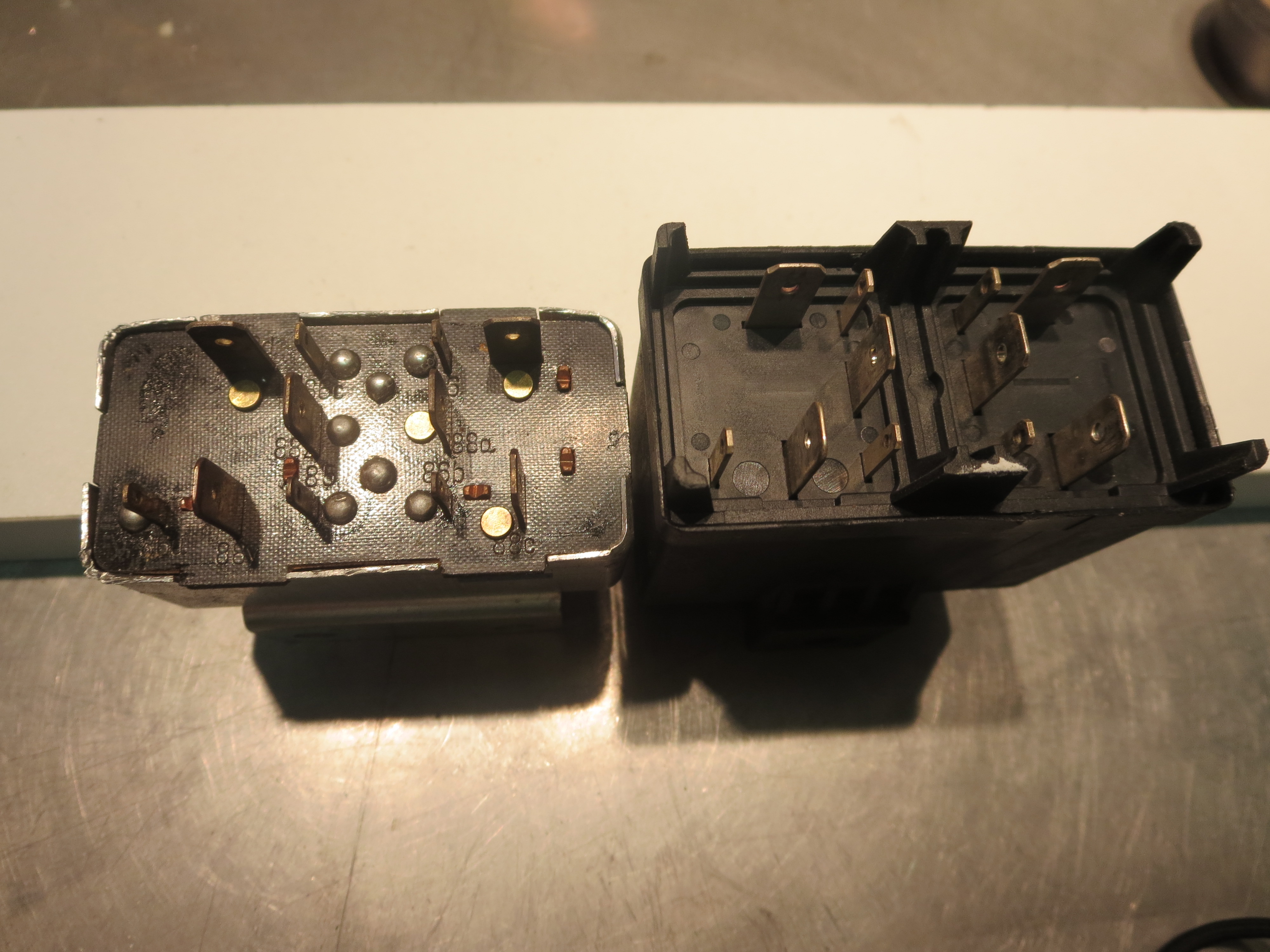

My car was built 08/1977 - I think I have a different relay layout. Or we are talking about different relays.
Edited by JagoBlitz
That was the change over to 78. Yes, you have different relays. The good news is both are available as new, old stock, (NOS) for reasonable cost.

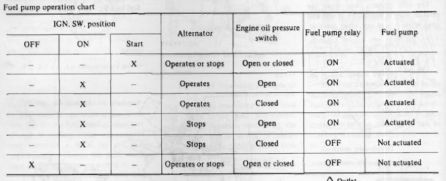

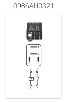

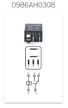

If you break the Fuel Pump Control Relay in to two separate relays I think that you'll find that you can build the circuit easily with two common relays.  The EFI relay is a very simple relay with one actuator controlling two circuits.  You could also go to the fuel pump control section of the FSM and build your own circuit based on their pump control chart.  Nissan just combined them for convenience.
https://www.boschautoparts.com/g/relays
The only question I'd have is whether the standard micro relay rating (25a) is sufficient for an external fuel pump. It may be safer to use the standard cube/mini relay for that?
Edited by HusseinHolland
I was just using the schematics of those relays to show the possibility.  The web page has the option of setting your specifications.
Just have to put the work in.
