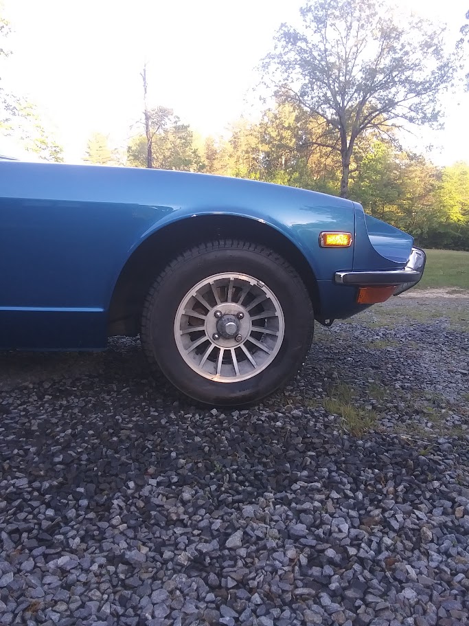

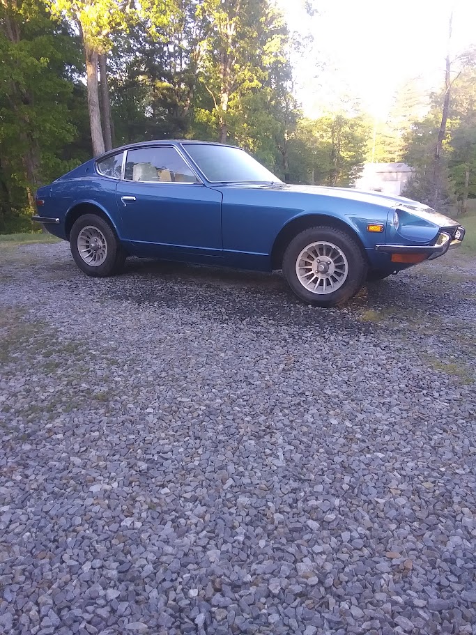

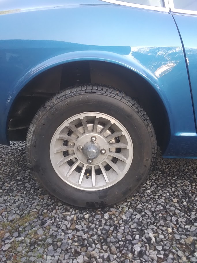

June 6, 20231 yr comment_654129 Here are a few pics of my car with the Arizona Z Source "stock height" springs. AZS assured me that they were correct and tested for the 240-Z. I like the firm ride, but not the 4x4 look. I recently purchased a pair of NOS rear springs and will continue my search for NOS fronts. (The fronts carry two different part numbers BTW) I have also recently acquired a full set of springs from a 48,000 mile car and wonder if they are still, after 50 years bearing the weight of a '71 Z, a viable (wise) option. Any thoughts...? Edited June 6, 20231 yr by Tirnipgreen Link to comment https://www.classiczcars.com/forums/topic/68165-suspension-rides-too-high-what-are-my-options-72-240z/?&page=2#findComment-654129 Share on other sites More sharing options...

June 6, 20231 yr comment_654146 The Tokicos are gas shocks also. There are some threads out there about how the gas shocks raise the car about 1/4 to 1/2". It's not much. You can push the shaft in easily by hand, it's probably only 20-30 lbs of lift. Who is Arizona Z Source? Did you mean Z Car Source? Or Arizona Z Car? 13 hours ago, Tirnipgreen said: Here are a few pics of my car with the Arizona Z Source "stock height" springs. AZS http://www.zcarsource.com/ https://www.arizonazcar.com/ Link to comment https://www.classiczcars.com/forums/topic/68165-suspension-rides-too-high-what-are-my-options-72-240z/?&page=2#findComment-654146 Share on other sites More sharing options...
June 7, 20231 yr comment_654147 58 minutes ago, Zed Head said: The Tokicos are gas shocks also. There are some threads out there about how the gas shocks raise the car about 1/4 to 1/2". It's not much. You can push the shaft in easily by hand, it's probably only 20-30 lbs of lift. Who is Arizona Z Source? Did you mean Z Car Source? Or Arizona Z Car? http://www.zcarsource.com/ https://www.arizonazcar.com/ Yes. Any or all of the above. Sorry if I stated their name in error. Not sure what kind of "testing" they did on these springs, but I am not the only one who got the "lifted" stance. I'll write it off as a mistake and move on...Ryals Link to comment https://www.classiczcars.com/forums/topic/68165-suspension-rides-too-high-what-are-my-options-72-240z/?&page=2#findComment-654147 Share on other sites More sharing options...
June 7, 20231 yr comment_654148 12 minutes ago, Tirnipgreen said: Yes. Any or all of the above. Sorry if I stated their name in error. Not sure what kind of "testing" they did on these springs, but I am not the only one who got the "lifted" stance. Who is "they"? "Any or all of the above" doesn't mean anything. Z Car Source is out of business, AZC is more of a performance shop. Did you get them from eBay? Maybe you just bought from the wrong place. Link to comment https://www.classiczcars.com/forums/topic/68165-suspension-rides-too-high-what-are-my-options-72-240z/?&page=2#findComment-654148 Share on other sites More sharing options...
June 7, 20231 yr comment_654149 3 minutes ago, Zed Head said: Who is "they"? "Any or all of the above" doesn't mean anything. Z Car Source is out of business, AZC is more of a performance shop. Did you get them from eBay? Maybe you just bought from the wrong place. No...I bought them from Z Car Source of Arizona. Again, I apologize for mis-stating their name. I waited months for them to confirm their testing of what I was told were "stock ride height" springs. When I received the springs, they weren't marked as to front or rear (other than a purple marker slash). When I called to ask which were which, I distinctly remember the young man being short and condescending. This thread began based on the fact that ZCSA's springs are not right...I agreed based on my experience. I did not buy them on Ebay...I bought them from a company with whom I had spent over $5,000 that year and trusted their integrity. I was wrong. Link to comment https://www.classiczcars.com/forums/topic/68165-suspension-rides-too-high-what-are-my-options-72-240z/?&page=2#findComment-654149 Share on other sites More sharing options...
