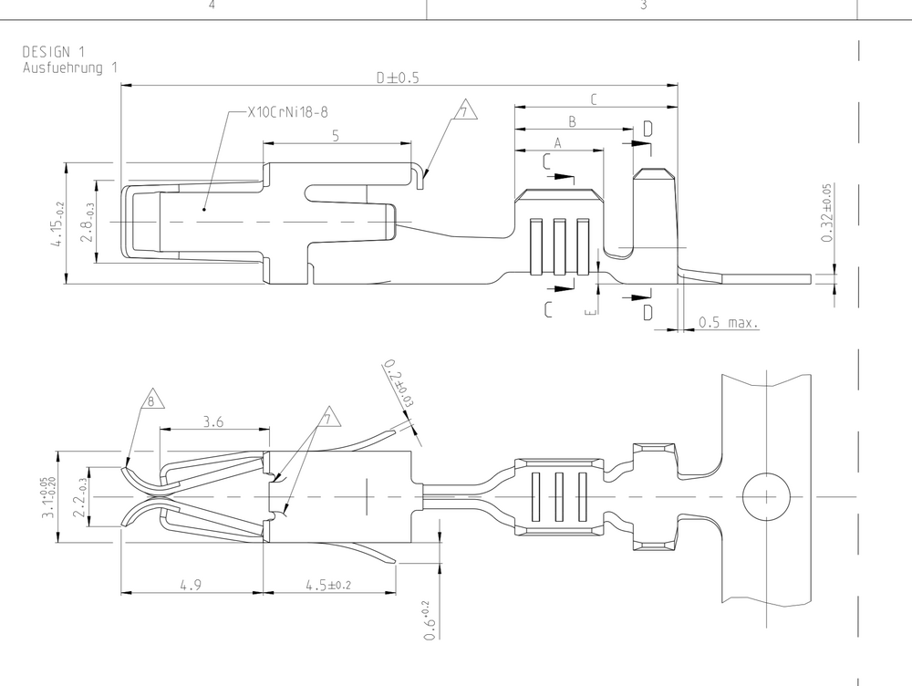

does anybody know what contacts are the correct ones for the 280Z 35Pin ECU connector? It is an AMP connector, but I cannot find the correct contacts. At first I thought it were the Junior Power Timer contacts, but they don't have the exact same dimension - they seem to be a little too small...according to the drawing that I found.

Maybe the JPT are the correct ones or at least compatible, I just ordered them to test if they might work.
But on the drawing I found a width of 2.80mm and I measure 3.00mm.
Because I don't have the correct extraction tool right now I could not compare other dimensions yet.
Edited by JagoBlitz
I could easily attribute a 0.2mm difference to manufacturing tolerances or measurement variability.
Maybe there's a burr kicked up on the piece you measured as a result of the shearing or forming operation?
I agree, it is not much difference, but there is a difference compared to the drawing. And all contacts are 3.00 +/- 0.03mm.

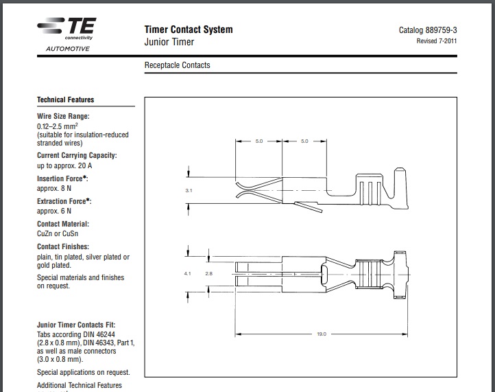

And here's an example of the female junior timer contacts:

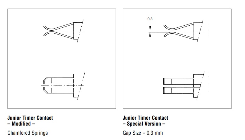

I took a look at the harness I have here and it appears the contacts have a gap between the fingers, and this modification shows up in one of the catalogs as a "special version". Looks like this:
