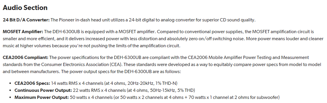

March 23, 20232 yr Author comment_651700 I was able to find the model number - the head unit is a Pioneer DEH-6300UB Link to comment https://www.classiczcars.com/forums/topic/68210-low-voltage-to-speakers/?&page=3#findComment-651700 Share on other sites More sharing options...

March 23, 20232 yr comment_651704 1 hour ago, chaseincats said: I was able to find the model number - the head unit is a Pioneer DEH-6300UB From the owner's manual: "Use speakers over 50 watt output value, between 4 and 8 ohm rating." I see in the specifications the output is 50 watts into 4 outputs (two front, two reatr). The Rockford Fosgate speakers you have had fail twice are rated at 30 watts and 4 ohms. These might be better suited to the stereo: https://www.crutchfield.com/p_20647KSC40/Kicker-47KSC404.html?tp=105 Link to comment https://www.classiczcars.com/forums/topic/68210-low-voltage-to-speakers/?&page=3#findComment-651704 Share on other sites More sharing options...
March 23, 20232 yr Author comment_651705 2 minutes ago, Racer X said: From the owner's manual: "Use speakers over 50 watt output value, between 4 and 8 ohm rating." I see in the specifications the output is 50 watts into 4 outputs (two front, two reatr). The Rockford Fosgate speakers you have had fail twice are rated at 30 watts and 4 ohms. These might be better suited to the stereo: https://www.crutchfield.com/p_20647KSC40/Kicker-47KSC404.html?tp=105 These speakers showed up at my place the other day so if the wattage was the problem, this should fix it: https://www.amazon.com/dp/B00G9T0RJU?ref=ppx_yo2ov_dt_b_product_details&th=1 Just out of curiosity, why would lower wattage speakers in this car fail? Link to comment https://www.classiczcars.com/forums/topic/68210-low-voltage-to-speakers/?&page=3#findComment-651705 Share on other sites More sharing options...
