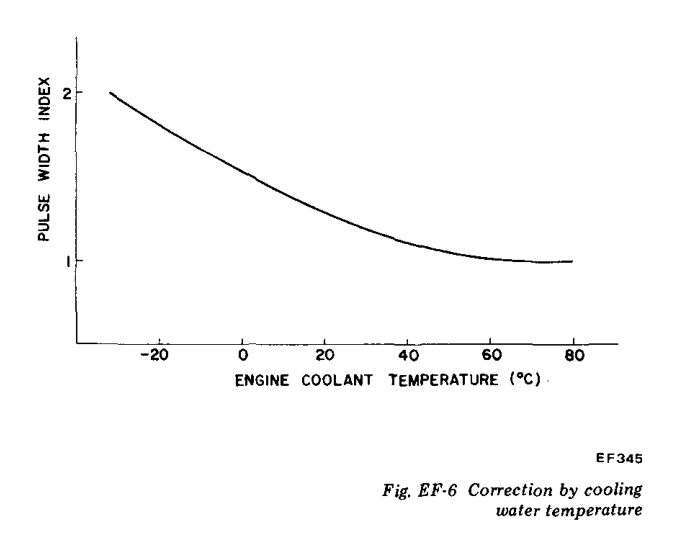

March 31, 20231 yr comment_651952 It's just a way to richen the mixture across the whole temperature range, and air flow range. It's a constant. Edited - I'm not sure that the actual curve is as flat at the end as Nissan shows it. Maybe it is though and with added resistance the ECU never sees a fully warmed up engine. The whole curve will get shifted to the right. Edited March 31, 20231 yr by Zed Head Link to comment https://www.classiczcars.com/forums/topic/68237-temp-sensor-resistor/#findComment-651952 Share on other sites More sharing options...

April 1, 20231 yr comment_651995 The EFI does depend on the coolant temperature sensor for correct fueling. As the coolant temp goes UP, the resistance DROPS. The FSM shows a table for expected temp vs. resistance values in the Engine Fuel section (page 53). Why would you want to ADD resistance to the signal using a variable resistor? Else, why would you remove the coolant temp sensor (thermistor) by replacing it with a manually controlled variable resistor? The aged wire and connectors in your engine harness may already be skewing signal with additional resistance. Additional resistance which would fool the ECU into thinking the engine was running cooler that it actually is. I think a more productive route would be to measure the resistance at the sensor, and then at the ECU - to see how much additional resistance wiring and connectors might be adding. If the skew is significant, a new wire and connector from the sensor to the ECU might beneficial. In my years with this early EFI and ECCS in S30's and S130's, I've found 90% of the problems to be in wiring and connectors. I've always advised: Clean both sides of your connectors, then do it again, Ya... then do it again. and don't forget the ECU... Most people ignore me and just go straight for the AFM. When you know everything there is to know about that Bosch L-Jetronic AFM, go ahead and bust it open. Trouble is, if you did know everything there is to know about that AFM, you'd never actually do that... Link to comment https://www.classiczcars.com/forums/topic/68237-temp-sensor-resistor/#findComment-651995 Share on other sites More sharing options...
April 1, 20231 yr comment_652004 42 minutes ago, cgsheen1 said: Why would you want to ADD resistance to the signal using a variable resistor? Because it has been shown to work, very well. There is much discussion around the EFI Z based forums about why old EFI Z's very often have lean condition intake popping problems that are then cured by adding resistance to the coolant temperature circuit. Fuel quality, electronic component drift, etc. have been proposed as potential reasons that the system doesn't work the way it was designed to. But, whatever the cause is, the added resistance is the cure. There aren't many reasonable aging reasons for resistance to drop in the coolant temperature circuit. Maybe something in the ECU changes. Who knows. But cleaning connections in the coolant sensor circuit will only lower resistance, making the air-fuel ratio leaner. I know that you moved on to the ECCS system and other more developed Nissan EFI control systems long ago. The primitive 280Z EFI system has its own idiosyncrasies. The 280Z EFI has a fever and the only cure is more resistance. Link to comment https://www.classiczcars.com/forums/topic/68237-temp-sensor-resistor/#findComment-652004 Share on other sites More sharing options...
