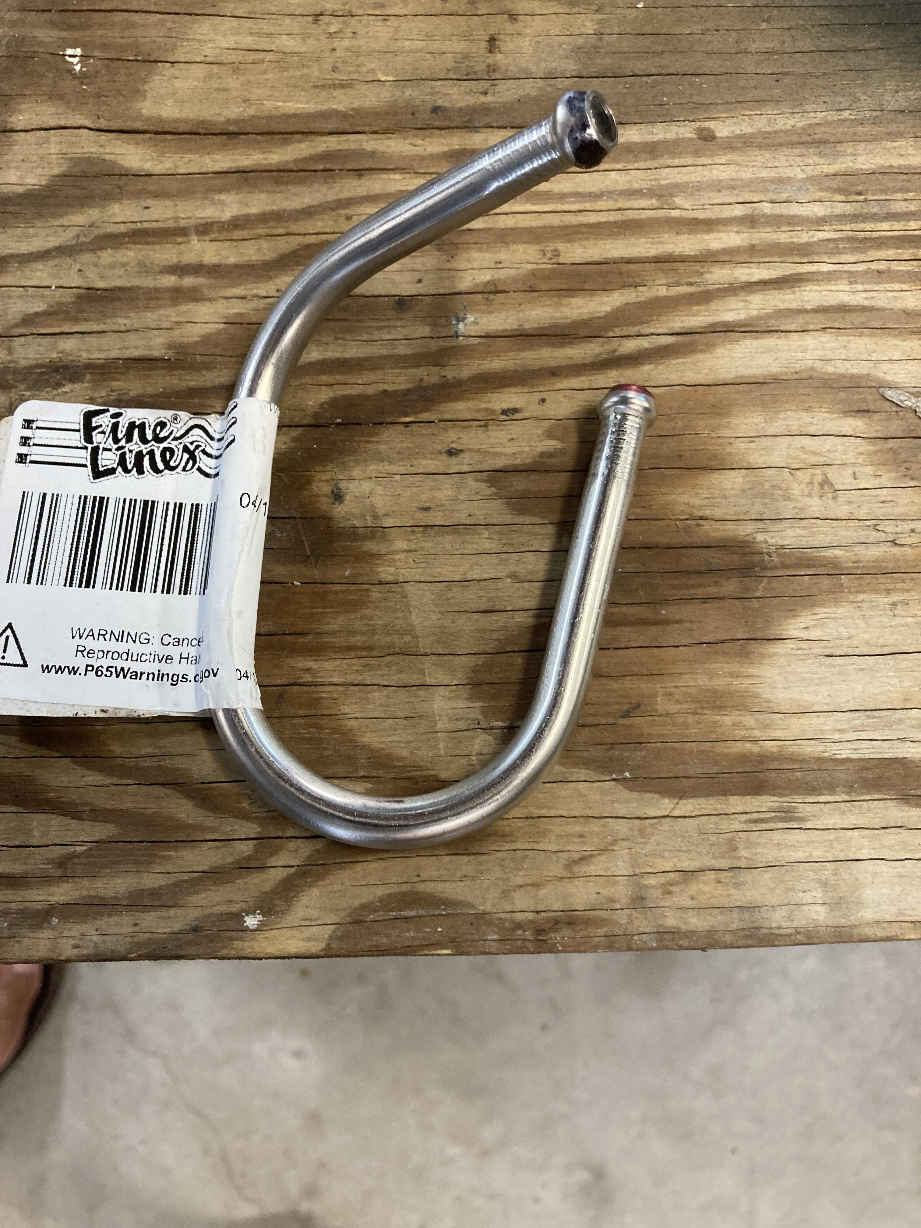

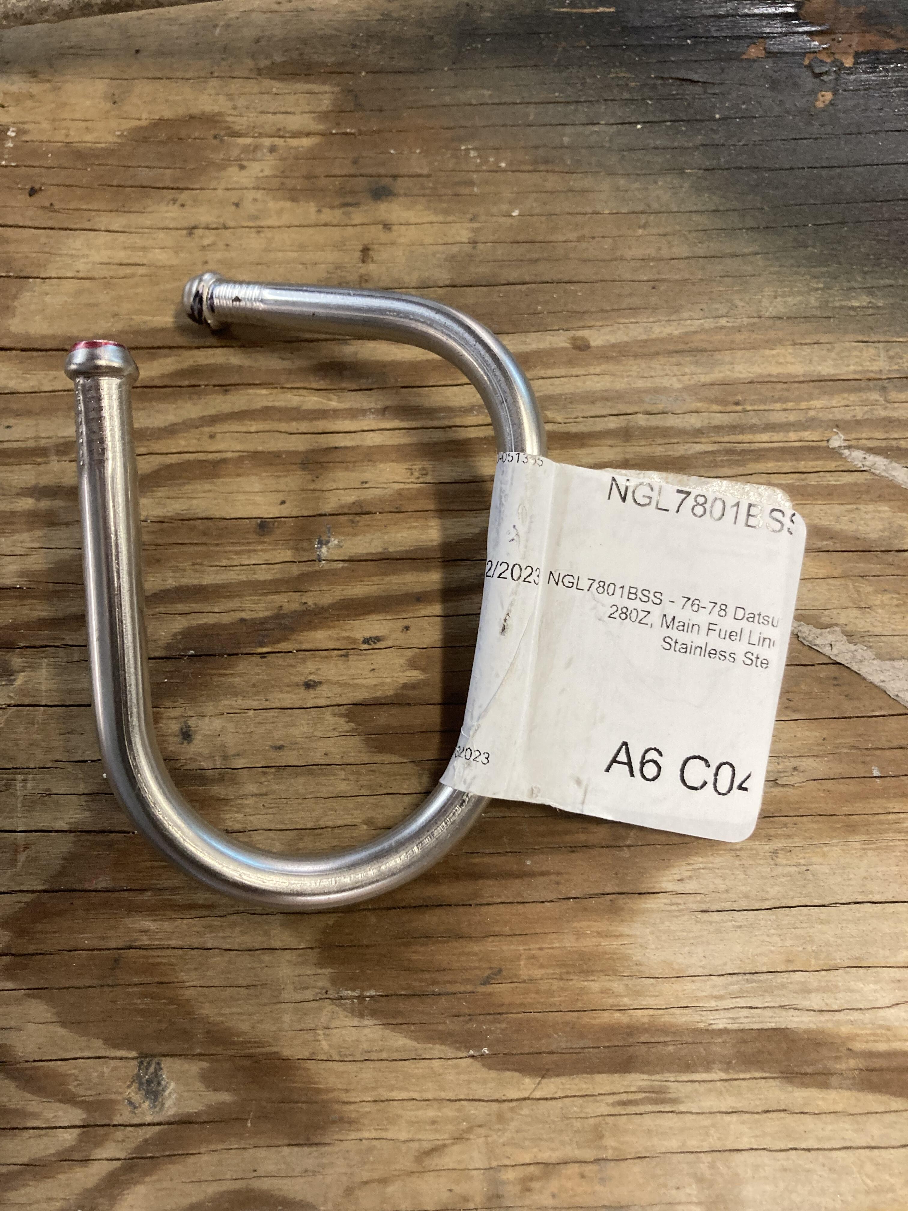

This just came to mind when you were talking about a “side winder hose”. Here’s a couple of pics of a line that came with my fuel line kit from SS Tube. Hooks to the factory pump configuration but might work on other applications. You can order it separately and possibly continue on with straight hose. Just a thought. Good luck with your project.
