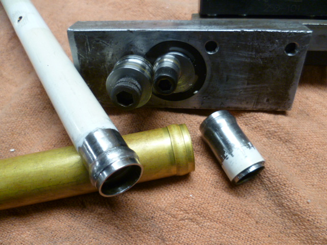

5/8 Stainless pipe for the heat pipe along the block, & bead roller tool arrived, along with the bulkhead fitting I'm going to use
5/8" hose barb to 10AN bay side fittings

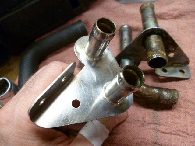

And since I can do pics again, here's my solution to the bulkhead feedthru. Not as glamorous as what you did, but more stock-ish. I made a stainless version of the original feedthru. Used the bead roller for this too.
New stainless version with old crusty original in background:
Yeah, that tool looks great. Probably much more durable than what I cobbled together. I didn't heat treat my dies and I'm not sure how many shots I'm going to get out of them before they start showing damage. Let's just hope I don't need to do a lot of bead rolling.   :excl:
14 hours ago, HusseinHolland said:
I tested the bead roller yesterday. I wish I had room for a lathe, there is certainly many an item I could use one for. In any event, this tool works very nicely
So inquiring minds want to know make and model of the bead roller...
Graham Tool Co - Medium Tube Beading Tool
Not cheap by any stretch, however I'll need to do a fair amount of tube bead rolling on the V8-into-Volvo-Pickup that I have underway
