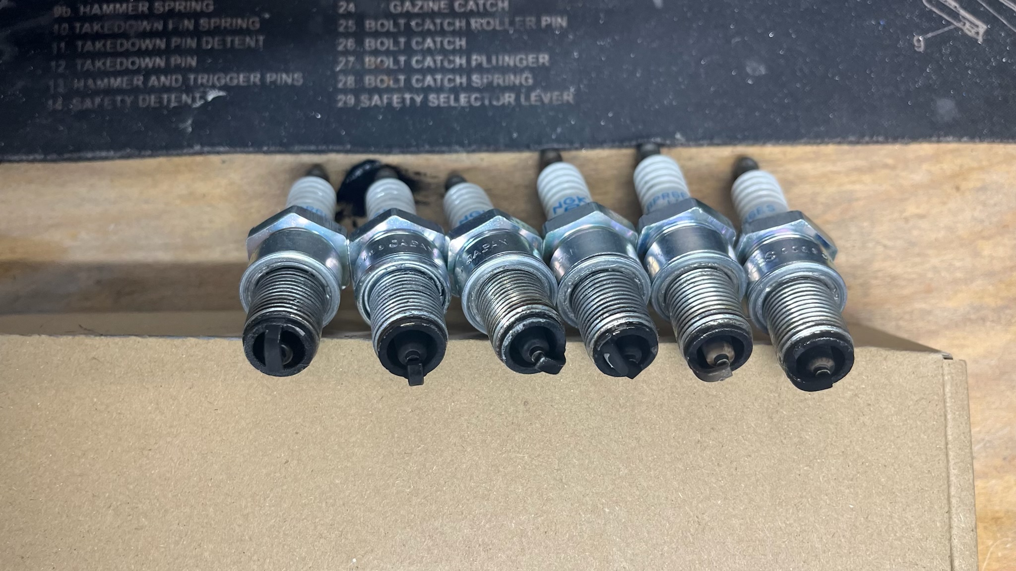

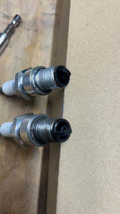

April 16, 20232 yr Author comment_652594 Good ideas, So yes I have checked the FPR. When idling I pulled the vacuum line off the FPR and the fuel pressure increased to around 40 psi +/-2. I already shocked the heck out of myself when pulling each spark plug wire of the plug when running, didn’t feel to good. The spark is strong, and jumps over an inch I’d say. Rockers are are good, pulled the valve cover and inspected the entire valve train. Here is a data point when I pull either the #6 plug wire or the #6 injector wire there is no charge in engine idle condition. When I pulled any others I do notice the engine running worse. I suspect #6 could be the culprit but don’t want to assume just yet. I pulled the plugs to look at them and they look terrible. They have maybe 400 miles on the and are pitch black and heavy soot. See pics below. This may be the problem. It verified what I already knew…..that I’m running very rich. Maybe it finally started to manifest in fouling. In my quest to solve the rich condition I’ve done several things. Replaced the AFM and ECU with good known tested combo from a car that didn’t run rich when installed. I bench tested the AFM per the FSM and it checked good. I removed the Throttle Position Sensor, opened and cleaned and checked contacts with multi meter, I replaced the AAR with one I bench tested and checked the opening warm and cold to confirm. The car ran well after all those replacements albeit still same rich condition…that didn’t change at all. My next suspect is the Water Temperature Sensor. I have a P79 head so I opted to use the 82’ head temp sensor with my car not one that goes in the thermostat housing. This one is slightly different in that it’s not for “wet” applications as the 280z ones are, but maybe it’s specs are slightly off because of that. I’m guessing the temp at the head between Cylinder #6 and #5 is hotter that the engine water temp….maybe? Or a ZX ECU has a different temp band curve? So I need to confirm the resistance at specific temps. I had to add 2 feet of wiring to run that temp wire around the back of the engine. Could be extra resistance in the circuit or a bad sensor. Might just go back to the putting the right 280z sensor in thermostat housing. I don’t have a compression tester so I’ll get a loaner from AutoZone maybe tomorrow. The first pic is plugs 5&6. Link to comment https://www.classiczcars.com/forums/topic/68273-rough-running-engine-with-no-explanation/#findComment-652594 Share on other sites More sharing options...
April 16, 20232 yr comment_652597 4 of those are pretty dark Link to comment https://www.classiczcars.com/forums/topic/68273-rough-running-engine-with-no-explanation/#findComment-652597 Share on other sites More sharing options...

April 16, 20232 yr comment_652602 On 4/16/2023 at 6:05 AM, Av8ferg said: I’m running very rich. Maybe it finally started to manifest in fouling. This seems most likely. I remember way back in my early car days spending a lot of time and effort trying to figure out a similar problem, only to find that it just needed a tuneup. Really, just new clean plugs. The carbon will absorb moisture while sitting and get more conductive. Then you get no spark. 40 psi is high on the fuel pressure. Many new aftermarket regulators seem to run high. 4/36.3 = 11%. That's a lot of extra fuel. Plus, if you have a new aftermarket AFM it might be running rich also. My MSA reman did, bought back in 2009/2010. And, I've also read that there is a lot of variability in the coolant temperature sensors. An adjustable FPR like Hussein Holland and I were talking about might help solve the running rich problem simply. Watch out for the shiny aluminum adjustable FPR's, they almost all leak pressure rapidly when the pump shuts off. Link to comment https://www.classiczcars.com/forums/topic/68273-rough-running-engine-with-no-explanation/#findComment-652602 Share on other sites More sharing options...
