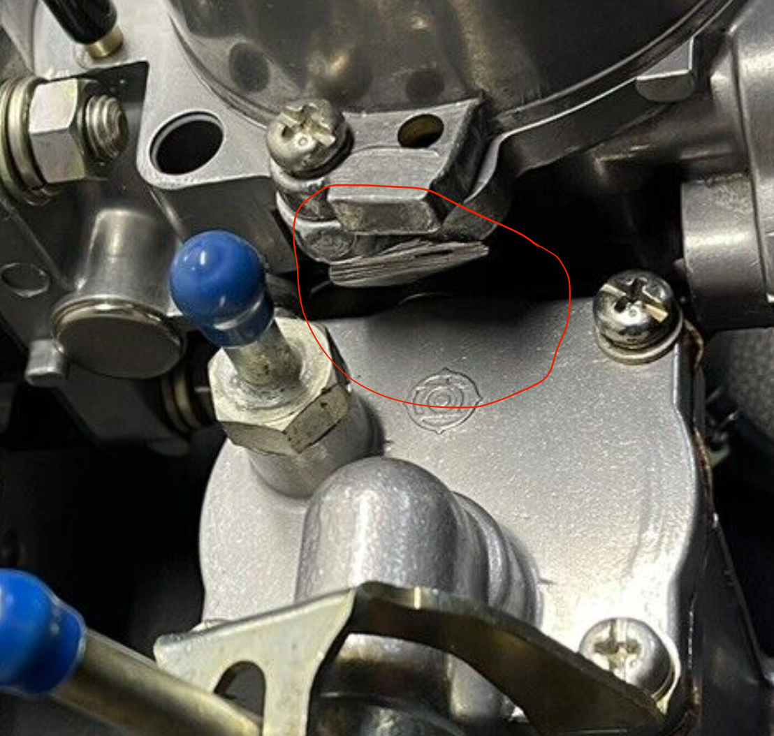

Posted April 16, 20231 yr comment_652622 What is the easiest way to remove the float to check the level on 3 screw carbs? There is a machined ledge that the cap hits after removing the four screws. I circled the area in red in the photo. I loosened the nut that holds the float chamber to the carb to give me enough room but I was just wondering if there is an easier way. Thanks Link to comment https://www.classiczcars.com/forums/topic/68278-adjusting-float-level-on-three-screw-sus/ Share on other sites More sharing options...
April 16, 20231 yr comment_652624 I believe you have to give it a bit of a twist to remove it. I'm not sure about the twist part. I've only worked on 4 screw carbs. @siteunseen Link to comment https://www.classiczcars.com/forums/topic/68278-adjusting-float-level-on-three-screw-sus/#findComment-652624 Share on other sites More sharing options...
April 16, 20231 yr Author comment_652627 Thanks Mark. I tried the twist and I guess my twist wasn't quite right. I was concerned about compressing the float too much trying to get it in and screwing up the level. Link to comment https://www.classiczcars.com/forums/topic/68278-adjusting-float-level-on-three-screw-sus/#findComment-652627 Share on other sites More sharing options...
April 16, 20231 yr comment_652629 Did you get it off? Link to comment https://www.classiczcars.com/forums/topic/68278-adjusting-float-level-on-three-screw-sus/#findComment-652629 Share on other sites More sharing options...
April 16, 20231 yr Author comment_652630 Yes, the only way I was able to remove the lid was by loosening the float bowl from the carb. That gave me enough play to get the lid on/off. Kind of a pain, as that nut isnt very accessible. Hoping there was a secret trick if I have to do it again. Link to comment https://www.classiczcars.com/forums/topic/68278-adjusting-float-level-on-three-screw-sus/#findComment-652630 Share on other sites More sharing options...

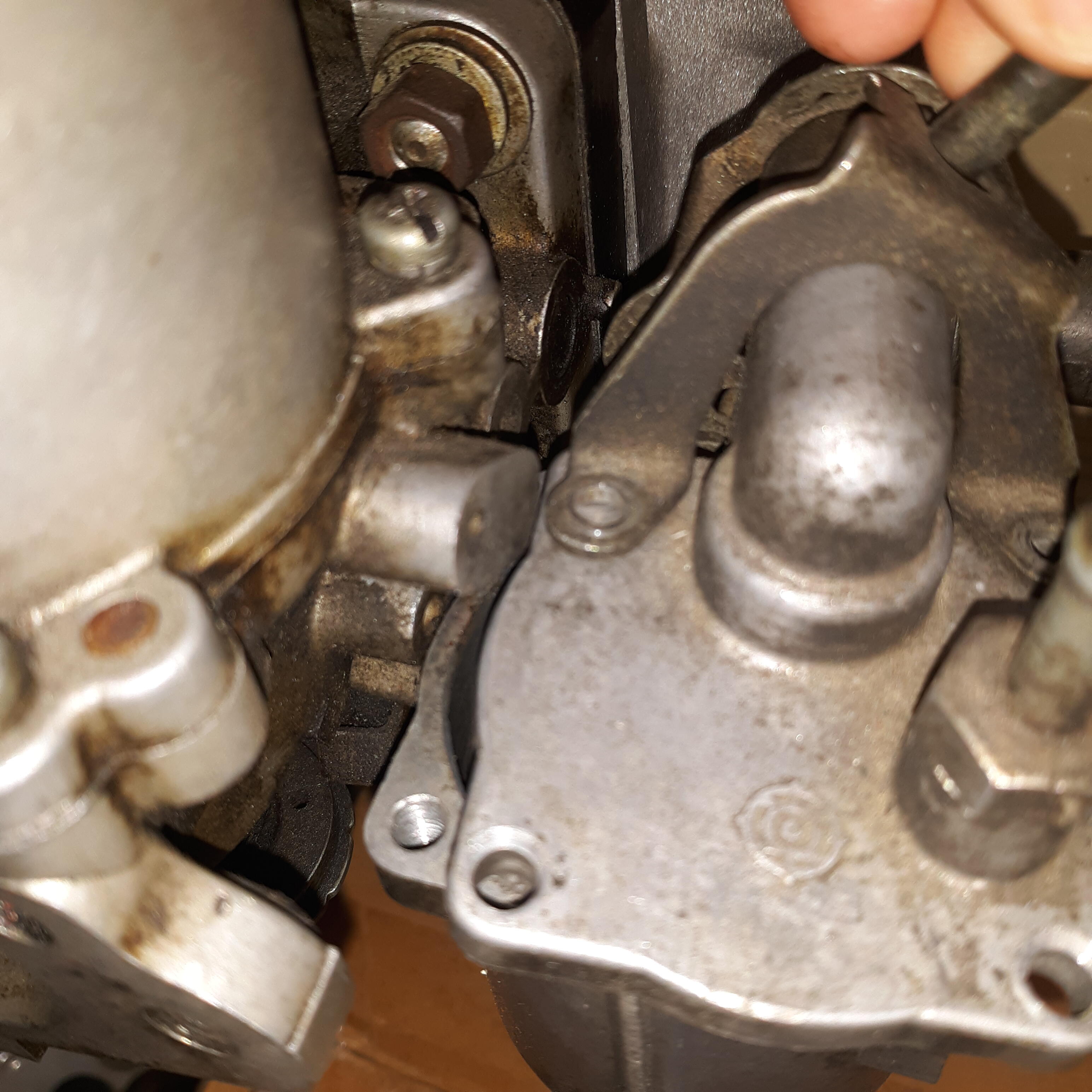

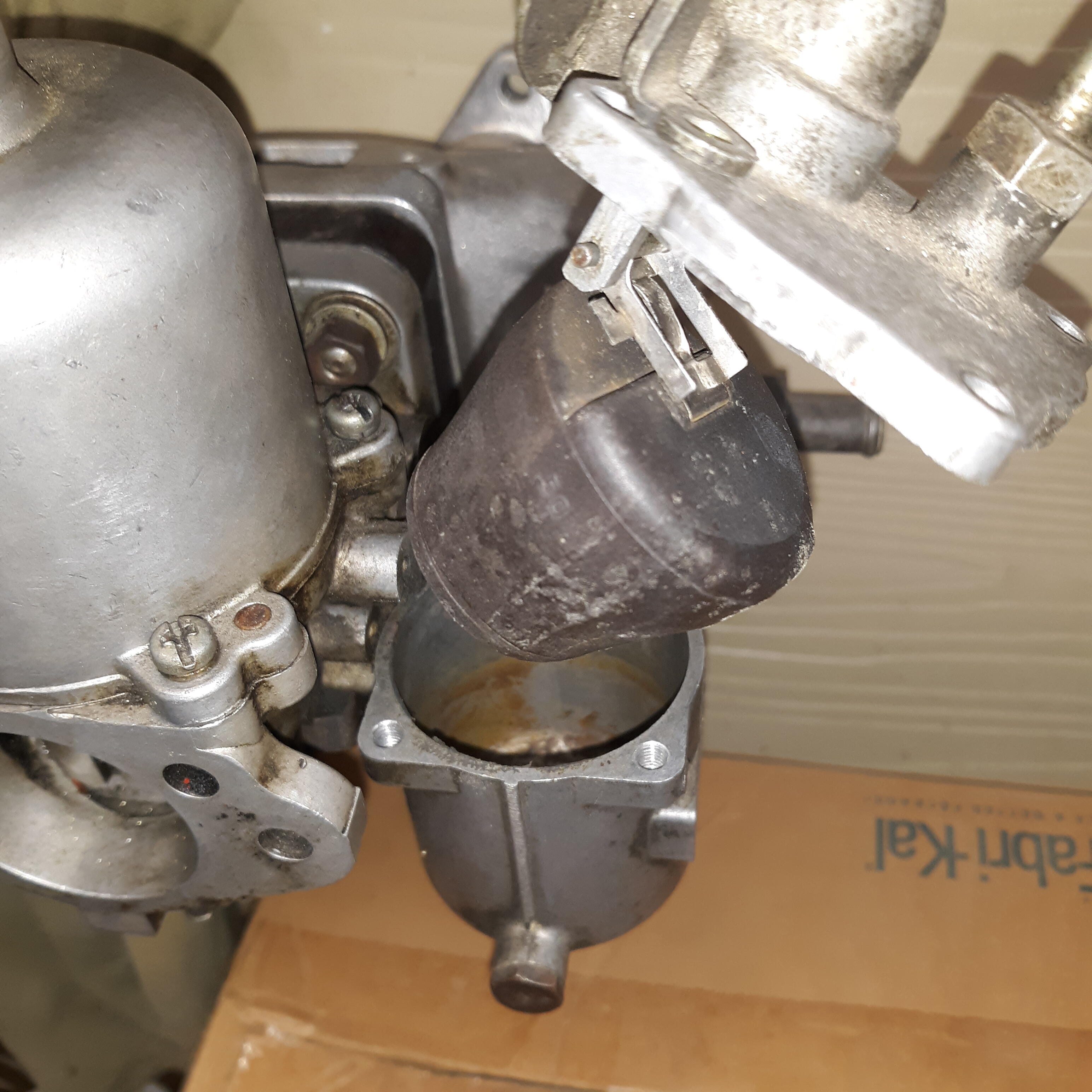

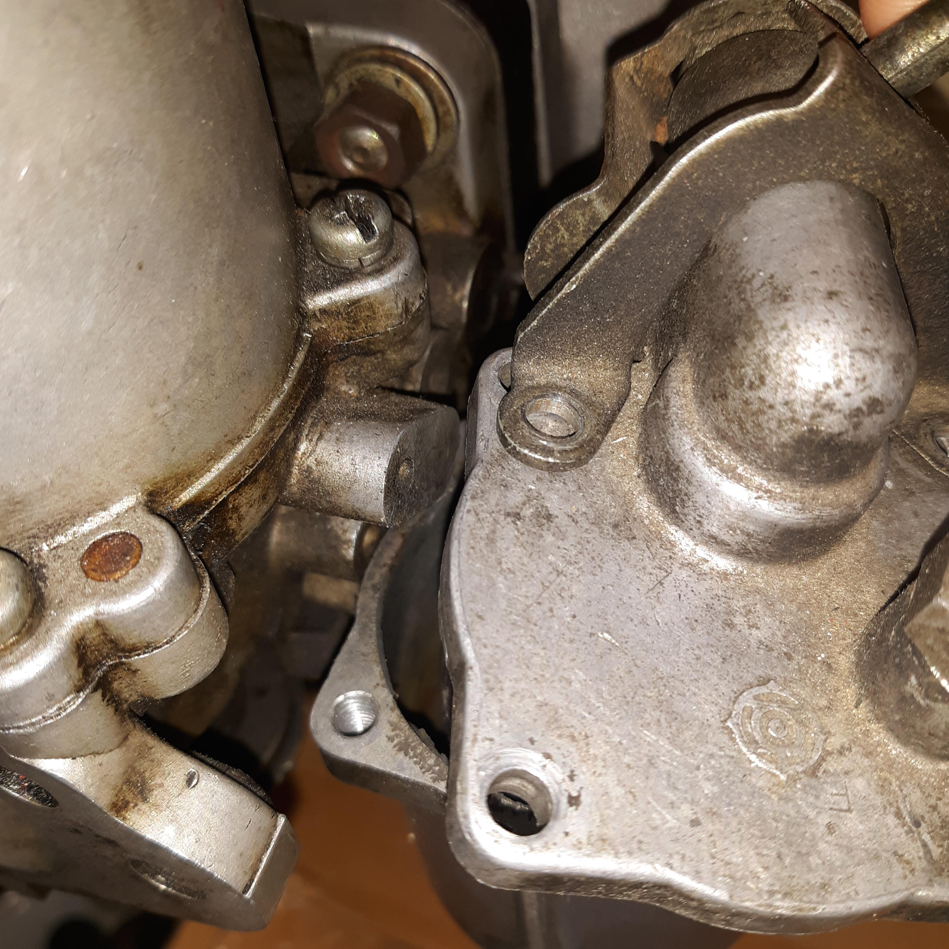

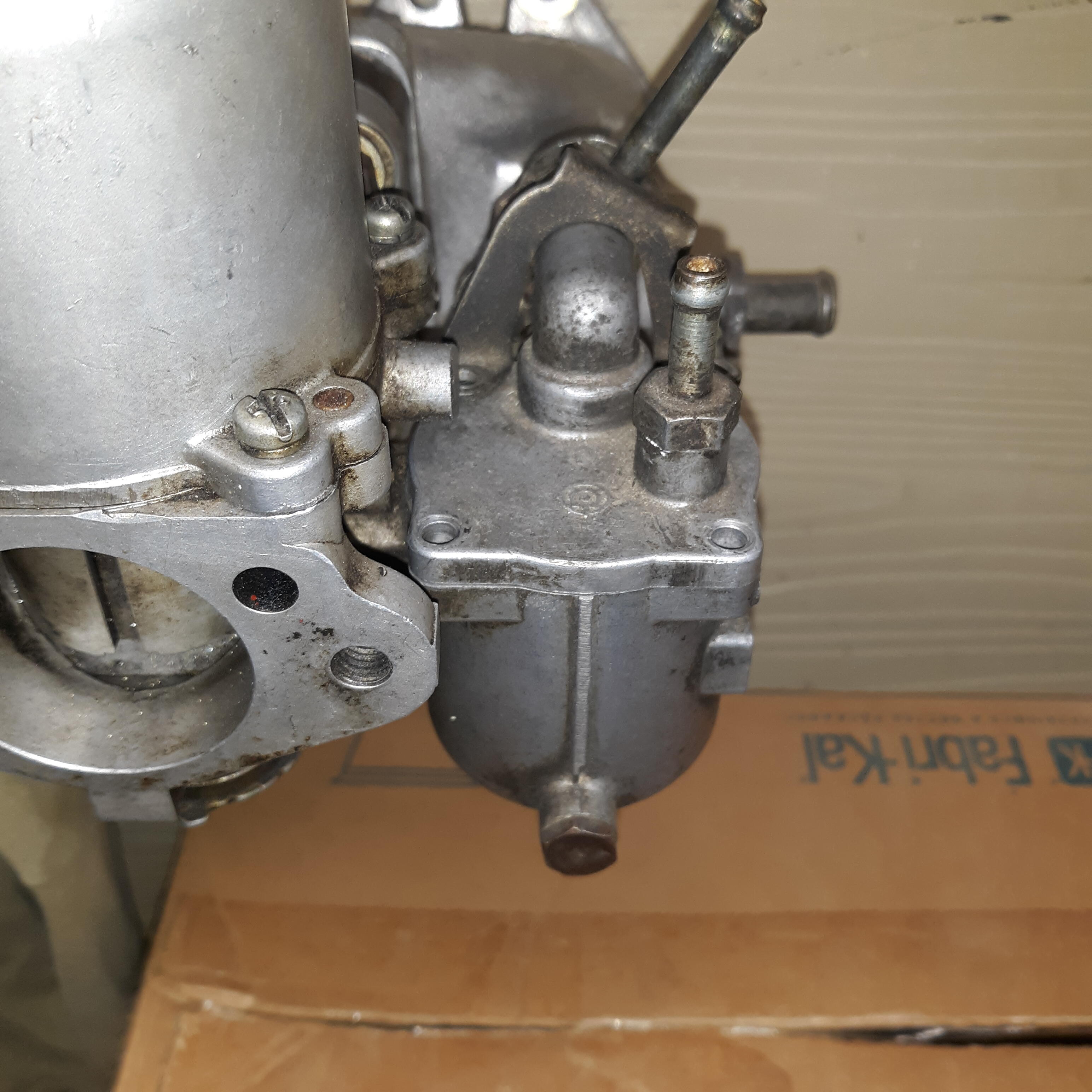

April 17, 20231 yr comment_652665 Take the screws completely out then with the lid still flat on the chamber turn it 90 degrees in the opposite direction of the vent bung. Then turn it just enough to get that indention before the screw hole under the nub under the dome. Once you figure it out it's easy. An "ah ha!" moment. Turned Indention lined up lift up when you can whala Link to comment https://www.classiczcars.com/forums/topic/68278-adjusting-float-level-on-three-screw-sus/#findComment-652665 Share on other sites More sharing options...
April 17, 20231 yr comment_652667 Just realized your pic is a front carb. Mine are the rear. Things look a lot different. Link to comment https://www.classiczcars.com/forums/topic/68278-adjusting-float-level-on-three-screw-sus/#findComment-652667 Share on other sites More sharing options...
April 17, 20231 yr Author comment_652668 6 minutes ago, siteunseen said: Just realized your pic is a front carb. Mine are the rear. Things look a lot different. Thanks for the pics. That is just what I needed to know. The pic I posted was just one I got from online and it looks like someone "modified" that one. Mine actually look just like the pictures you posted. I turned it 90 degrees but didnt think try to get it in the notch. Makes sense now. It might be useful to glue the gasket to the lid. Thanks!! Link to comment https://www.classiczcars.com/forums/topic/68278-adjusting-float-level-on-three-screw-sus/#findComment-652668 Share on other sites More sharing options...
