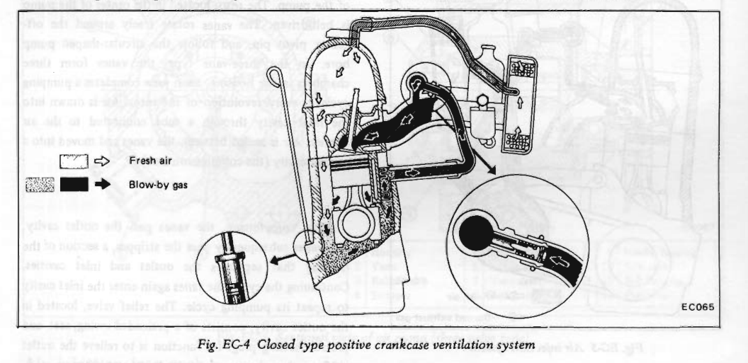

Good points. PCV is clear, and oil was 5qts and to the full mark.
