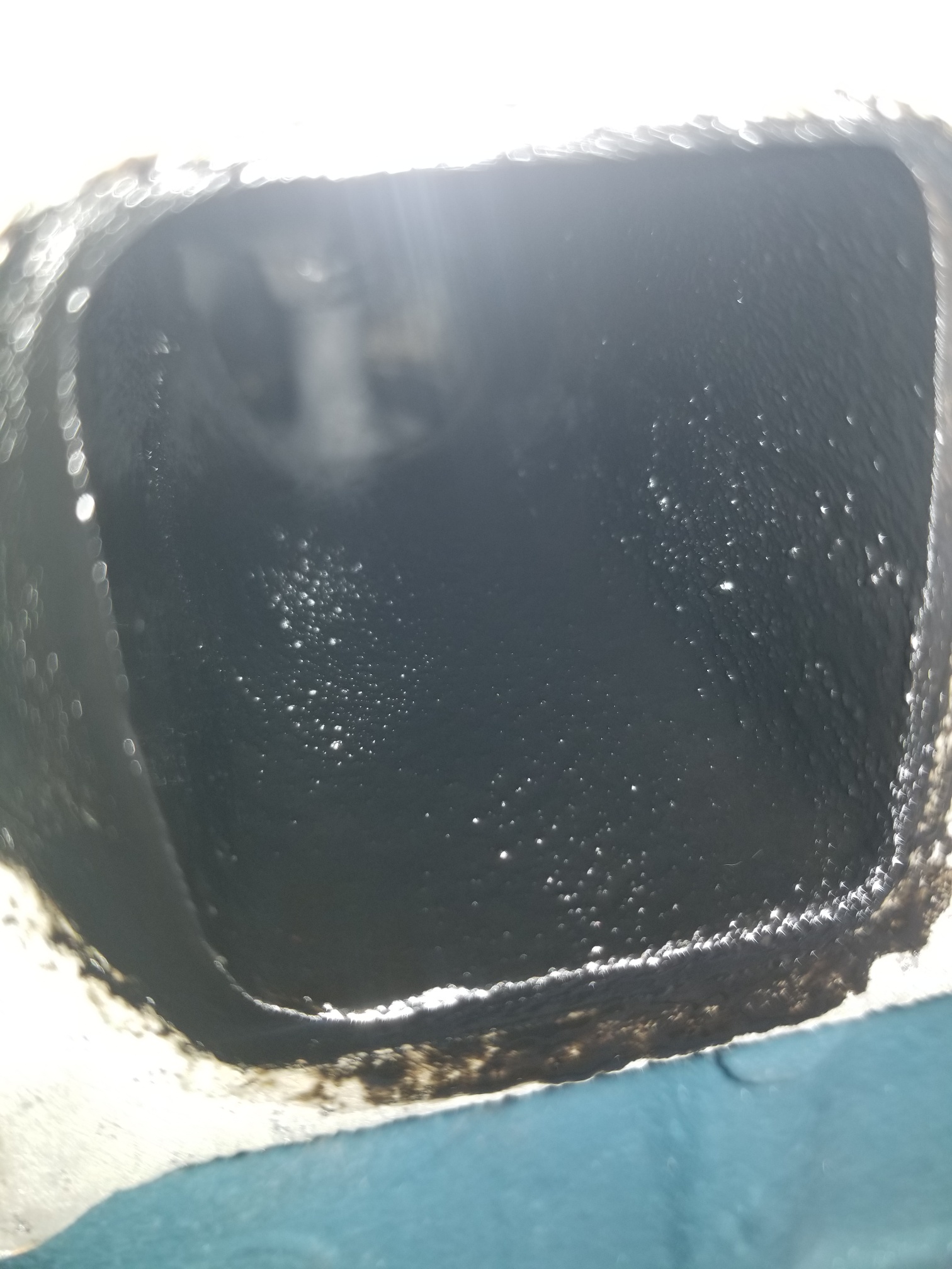

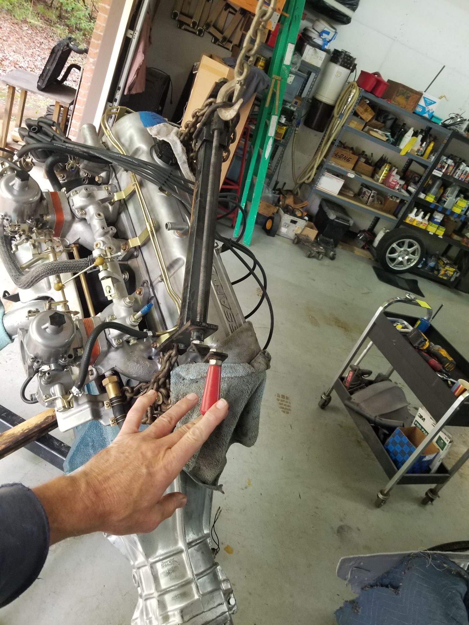

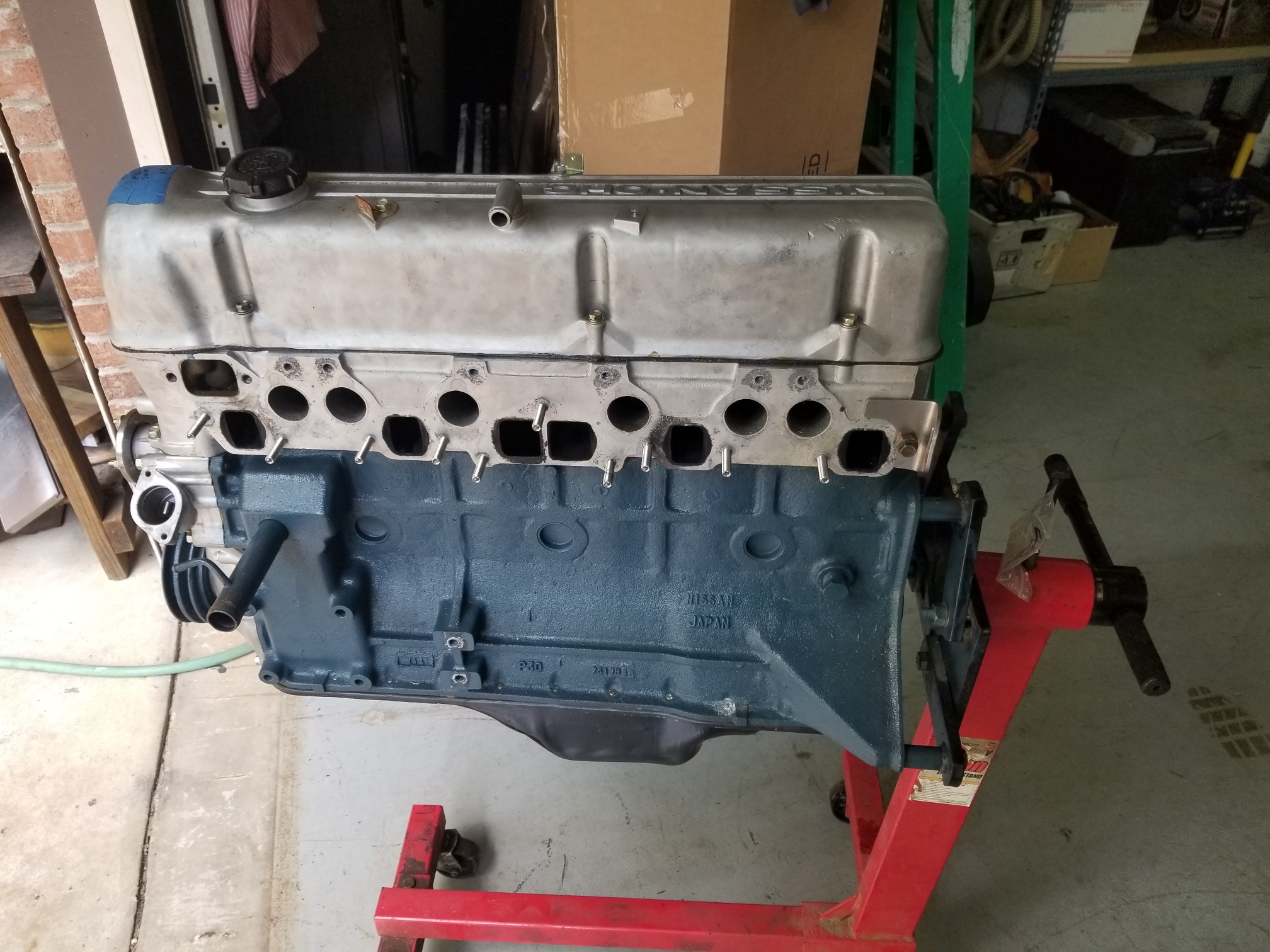

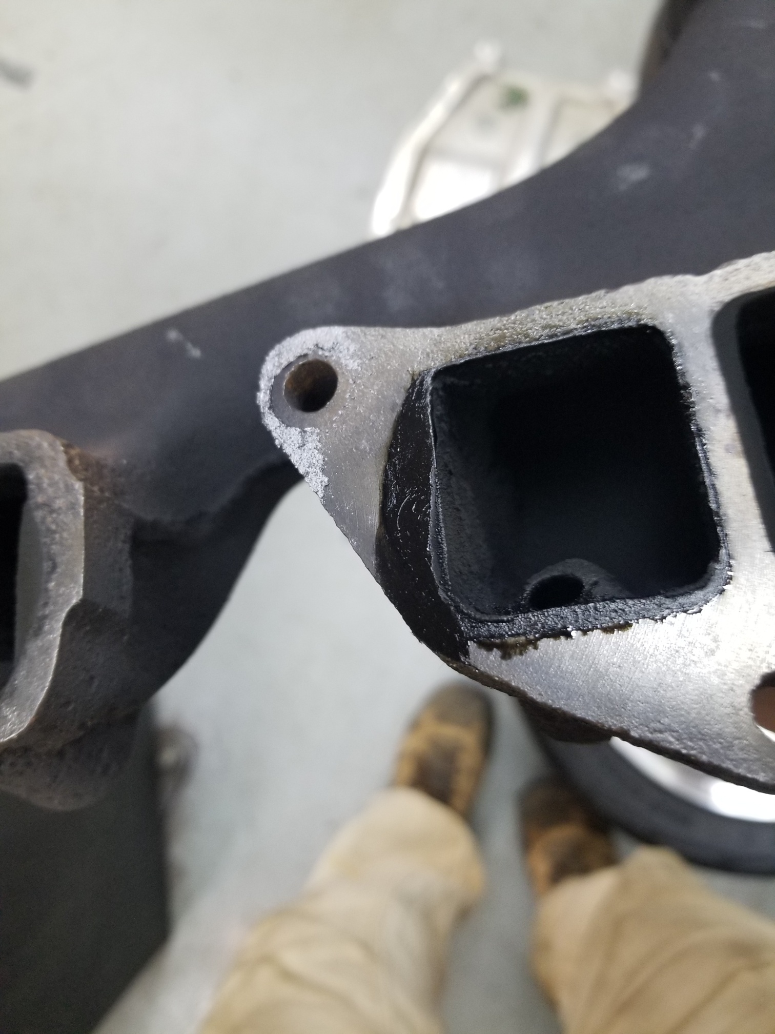

April 28, 20231 yr Popular Post comment_653144 So I don't want to get ahead of Ernest but I'll post up some info from today. I went and helped him get the engine out. We tore it down to the long block The intake valve stems were really clean looking. The exhaust ports looked really wet! It's a little hard to see in this picture. That is actually a puddle of oil in the exhaust port! This is actually liquid like oil that was seeping down under the gasket. Pretty much all of the ports had the same situation. The PCV hose was nice and clean. I would say all of this is coming from the bottom end and it's not isolated to one cylinder. To me that rules out a broken ring or bad ring indexing or something isolated like that. This is an issue across all the cylinders. I also don't believe the engine builder is going to be the issue. He's apparently been building races engines for probably 40+ years. If I had to guess, I would suspect the oil rings destroyed themselves. Possibly poor quality rings... Will be interesting to see what he finds when he tears it down Link to comment https://www.classiczcars.com/forums/topic/68280-engine-rebuild-smoking/?&page=5#findComment-653144 Share on other sites More sharing options...
