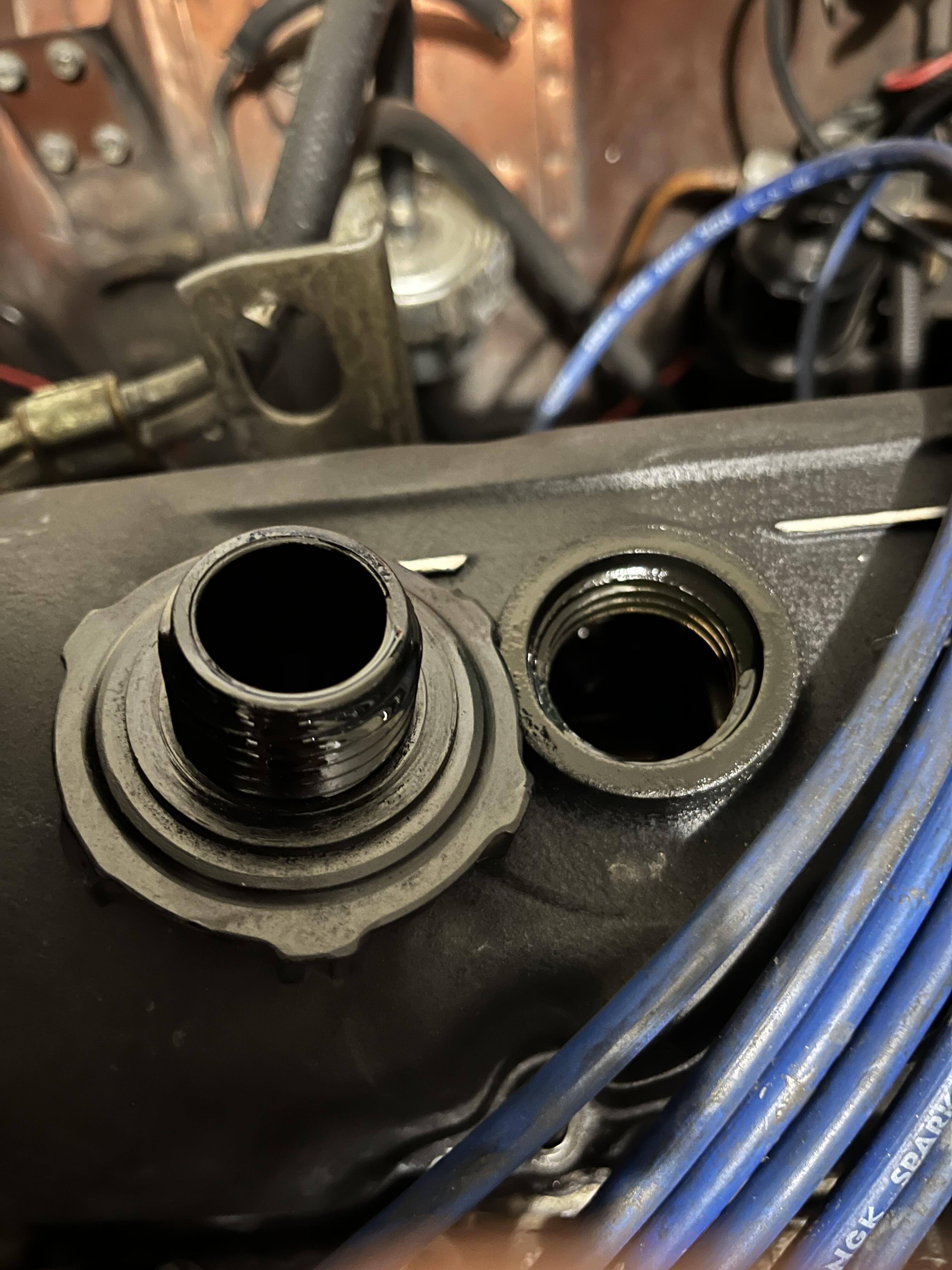

April 18, 20231 yr Author comment_652719 Just pulled the oil cap and it seems like there's neither an indentation on the valve cover nor in the oil cap. What looks like a seal is molded plastic and you can see on the lip where oils been sneaking out. I pulled my PCV valve and it's good - also the valve cover breathing hose is hooked up to the AFM boot so there shouldn't be any pressure building up in the valve cover to the point it would be blowing out of the cap which is what's really confusing... Edited April 18, 20231 yr by chaseincats Link to comment https://www.classiczcars.com/forums/topic/68282-impossible-oil-leak/?&page=2#findComment-652719 Share on other sites More sharing options...

April 18, 20231 yr comment_652724 9 hours ago, chaseincats said: Just pulled the oil cap and it seems like there's neither an indentation on the valve cover nor in the oil cap. What looks like a seal is molded plastic I know it's hard to believe, but this is a separate piece: "Are you sure about that five minutes??" Link to comment https://www.classiczcars.com/forums/topic/68282-impossible-oil-leak/?&page=2#findComment-652724 Share on other sites More sharing options...

April 18, 20231 yr Author comment_652733 2 hours ago, Captain Obvious said: I know it's hard to believe, but this is a separate piece: "Are you sure about that five minutes??" Wow really? I'll get a flat head and hammer and try to bash it out or something tonight then. Could I just go to home depot and grab a thick oring if they have it in its stead? I really don't want to spend $20 to ship a 2 dollar part from thezstore haha Edited April 18, 20231 yr by chaseincats Link to comment https://www.classiczcars.com/forums/topic/68282-impossible-oil-leak/?&page=2#findComment-652733 Share on other sites More sharing options...

April 18, 20231 yr comment_652740 So, none of you people live in Arizona?? Our oil cap seals were dried up, hard as a rock, and leaking 30 years ago. I still haven't found a replacement seal that I really like - most work but are a bit too soft. 2 hours ago, chaseincats said: Yea the whole thing is powder coated minus the lettering of course. You might be right about that but what's done is done I guess. There's always 400 grit and a hard block... Link to comment https://www.classiczcars.com/forums/topic/68282-impossible-oil-leak/?&page=2#findComment-652740 Share on other sites More sharing options...
