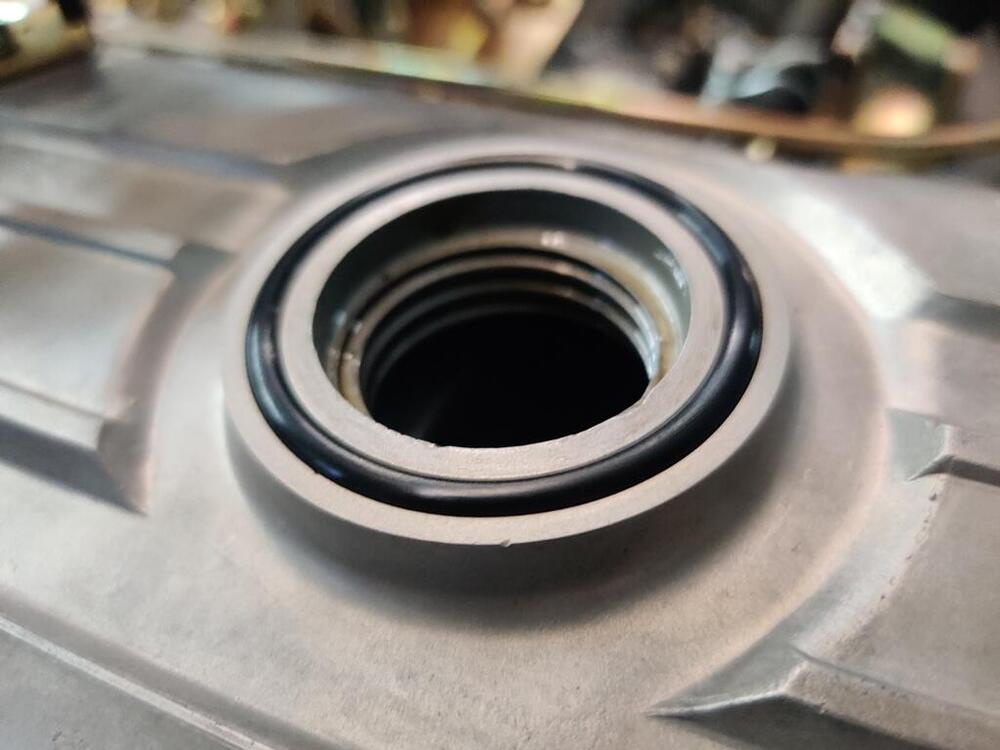

So the O-ring for the early 2400 valve covers. Anyone got a source for those?
Fits in this groove as pictured above:
I assume it would be easy to measure the size and find a suitable replacement, but I also assume someone has already done that work so I don't have to do it again?

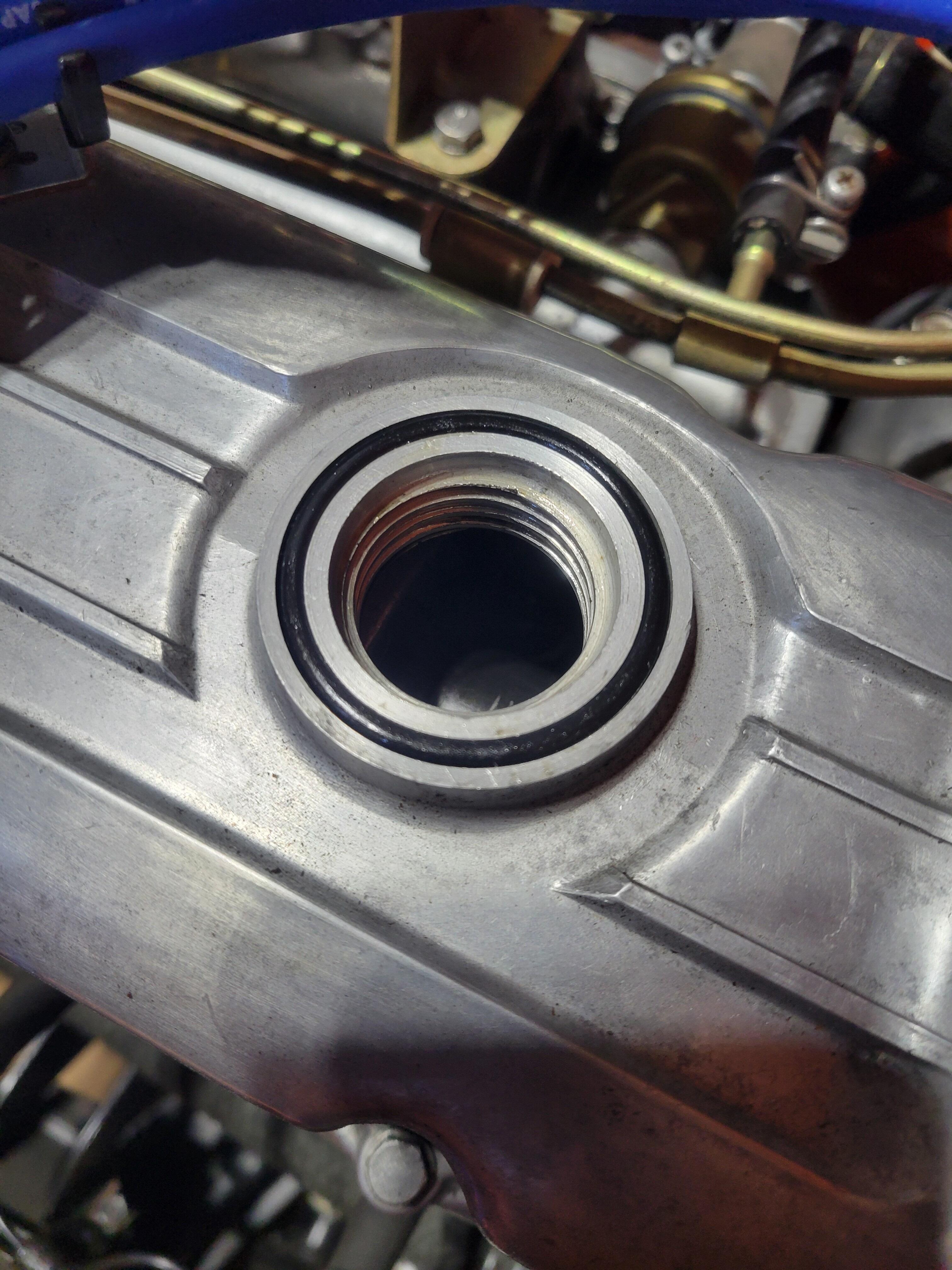

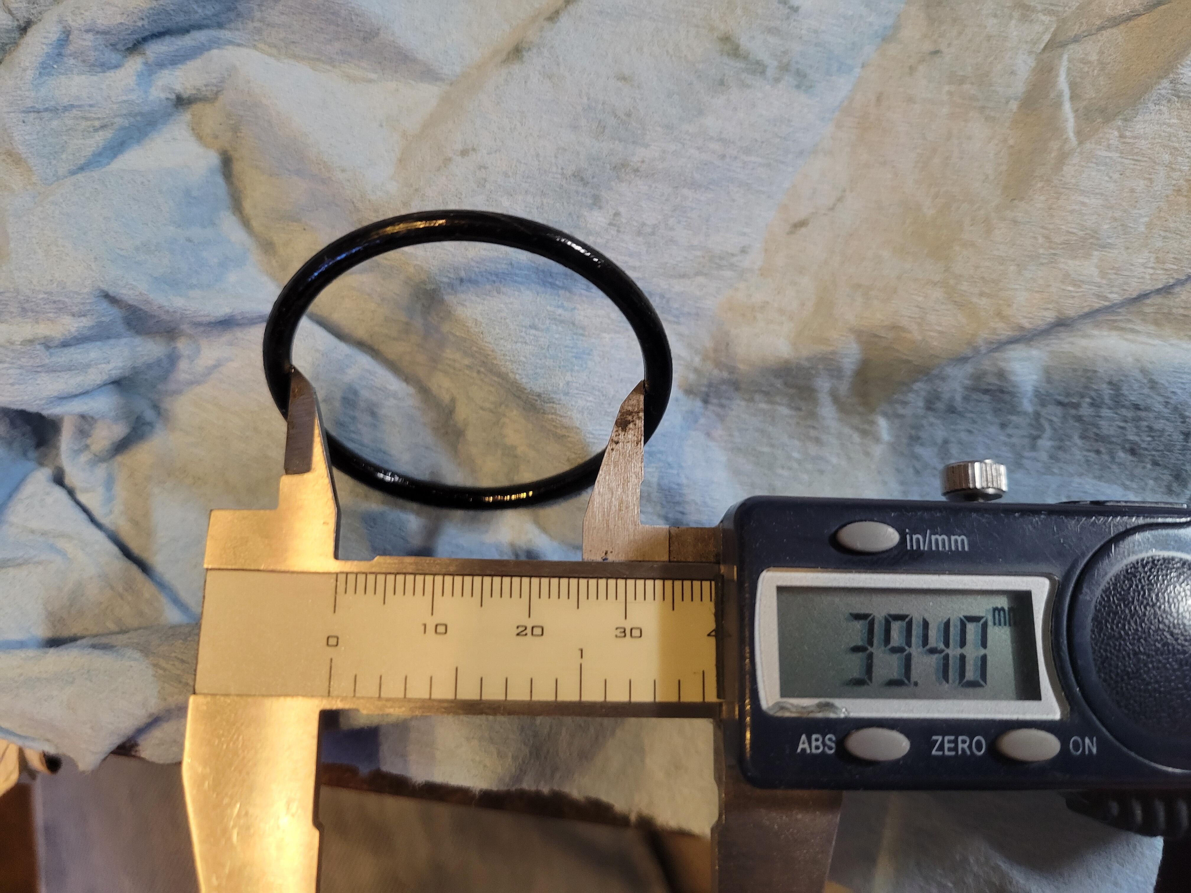

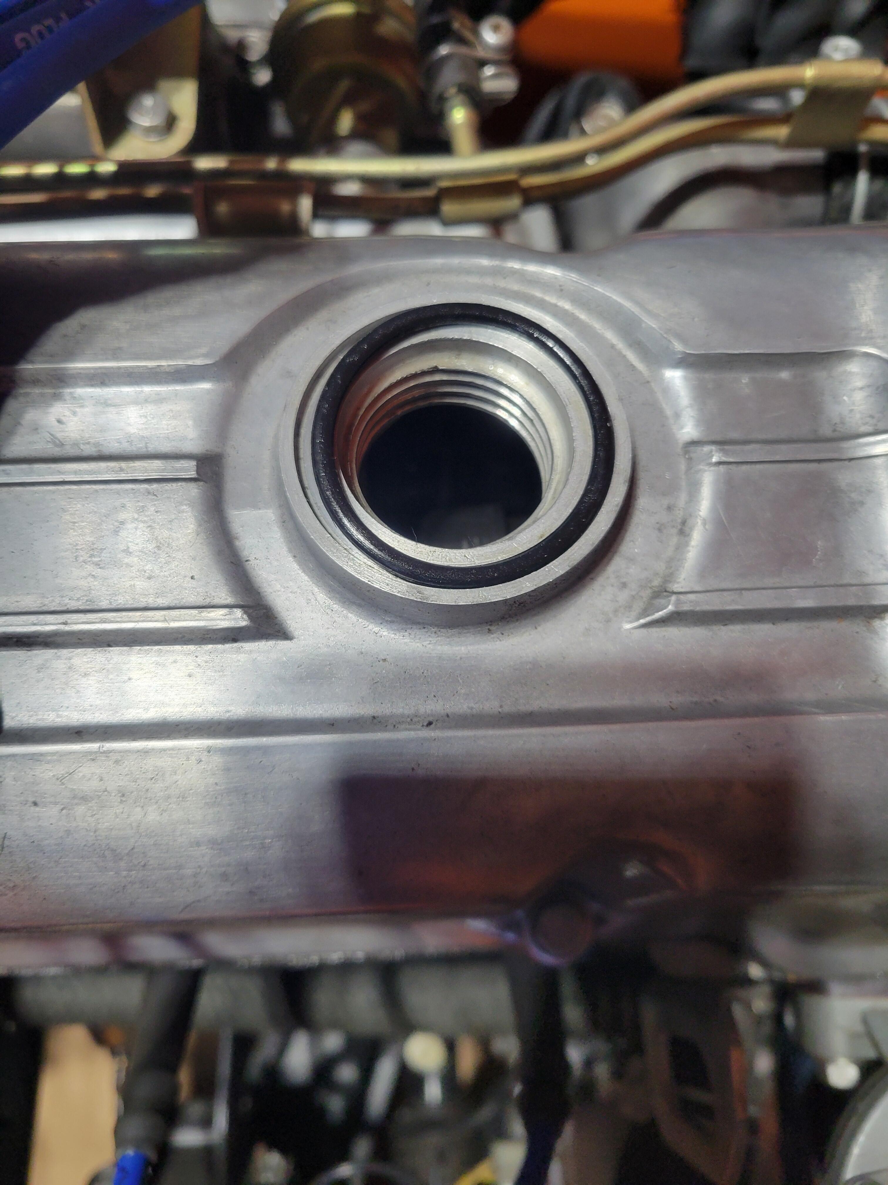

Posted (edited)

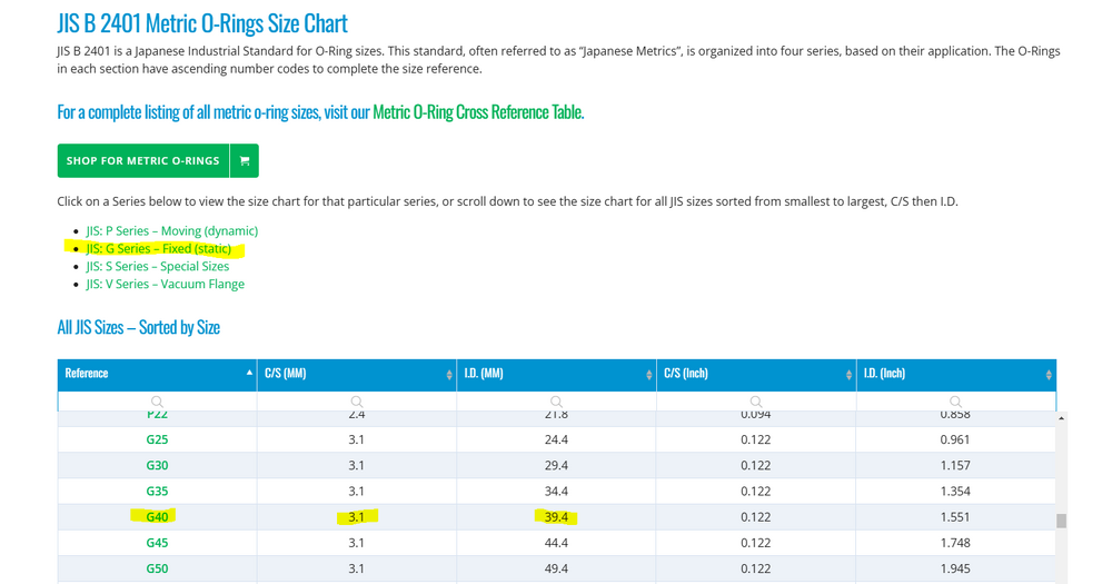

Here are the measurements of the O-ring groove from #957's 2400 valve cover. It uses a true metric O-ring, not SAE.
Groove OD = 1.860" (47.24mm)
Groove ID = 1.604" (40.74mm)
Depth =  0.095" (2.41mm)
O-ring ID = 1.551" (39.40mm) uninstalled
O-ring C/S = 0.122" (3.10mm)
Definitely metric as expected. The closest SAE size is a 3/32" O-ring that has a cross-section (C/S) of 0.103" (2.61mm).
The O-ring in my car has a small stretch fit on the ID of the groove. I can't confirm that it is actually correct but it is a good fit. Here's a few pics:

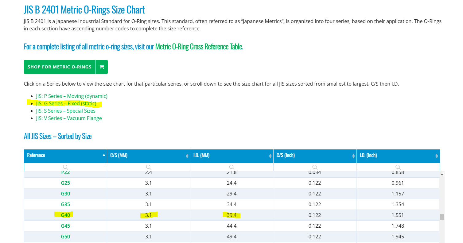

Here is some info on JIS true metric O-rings that I googled. I believe the correct size is G40
https://www.globaloring.com/jisb-2401-metric-orings-2/
