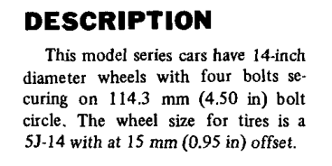

Looks like you answered your own question.  Center is center, not clear why one method would be better than another, besides perception.  Since Nissan did not use the hub as a surface meant to fit another surface then there would be no reason to have a tight tolerance on the machining process.  So you might find that each of your adapter/spacers will have to be custom-fit.  Don't forget the longer lugs or longer lug nuts.  Don't know what type of nut the Konig's use, tapered seat or shanked.  15mm is substantial.  Or maybe it's 25mm.  Nissan either made a typo or can't do math.  Probably supposed tobe 0.59.

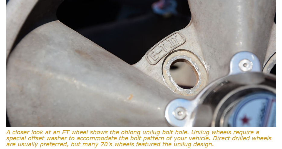

The only aftermarket wheels I ever bought that were only lug centric were those American Standard wheels of the 70-80's that were in many cases slotted to allow fitment to a couple of close bolt patterns. Those do not use a cone seat. I had definite balance issues with that style - one had to torque the lugs with the wheel unloaded to avoid vibration.

Found a picture of a similar wheel.
https://inthegaragemedia.com/rolling-stock/

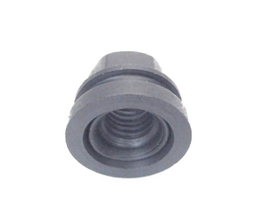

Here's a Ford hub centric lug nut.  The hub centers and helps out but the nut and lugs do most of the work.
This is aftermarket, the Ford nuts have a spinning seat with some grip texture on the face.  Still flat.
