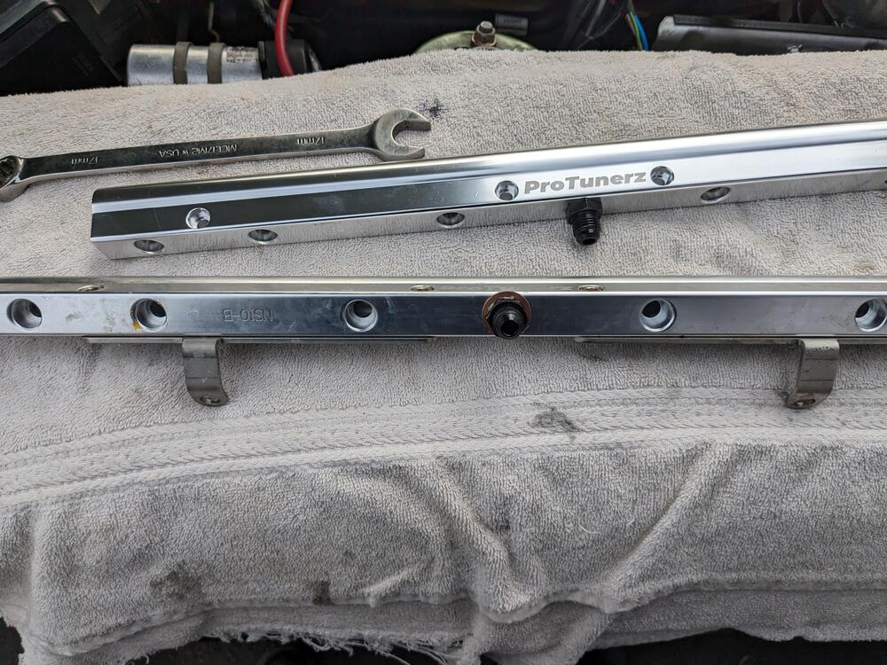

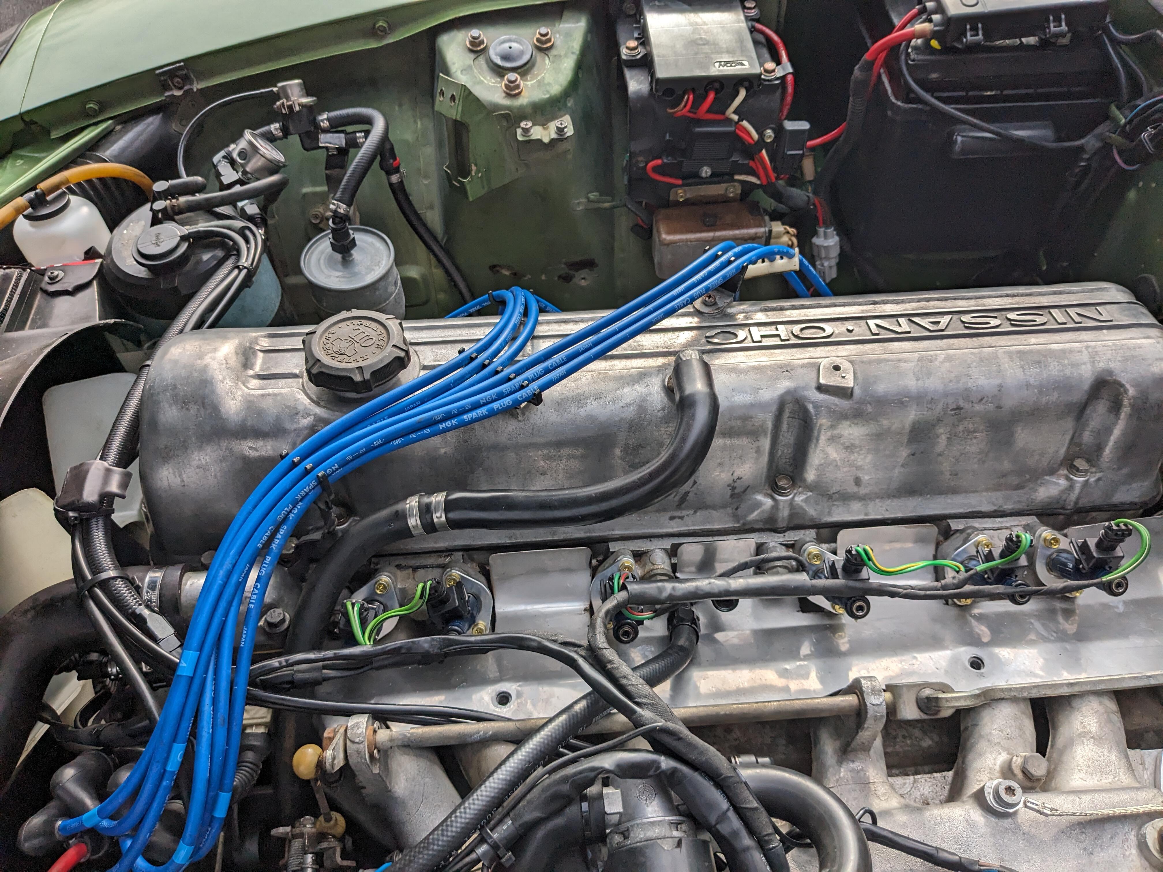

Swapped out the ProTunerZ rail today. Old one in foreground
Easy swap out. Injectors stay put. 2 -6 AN fittings and the 2 hold downs on the intake.

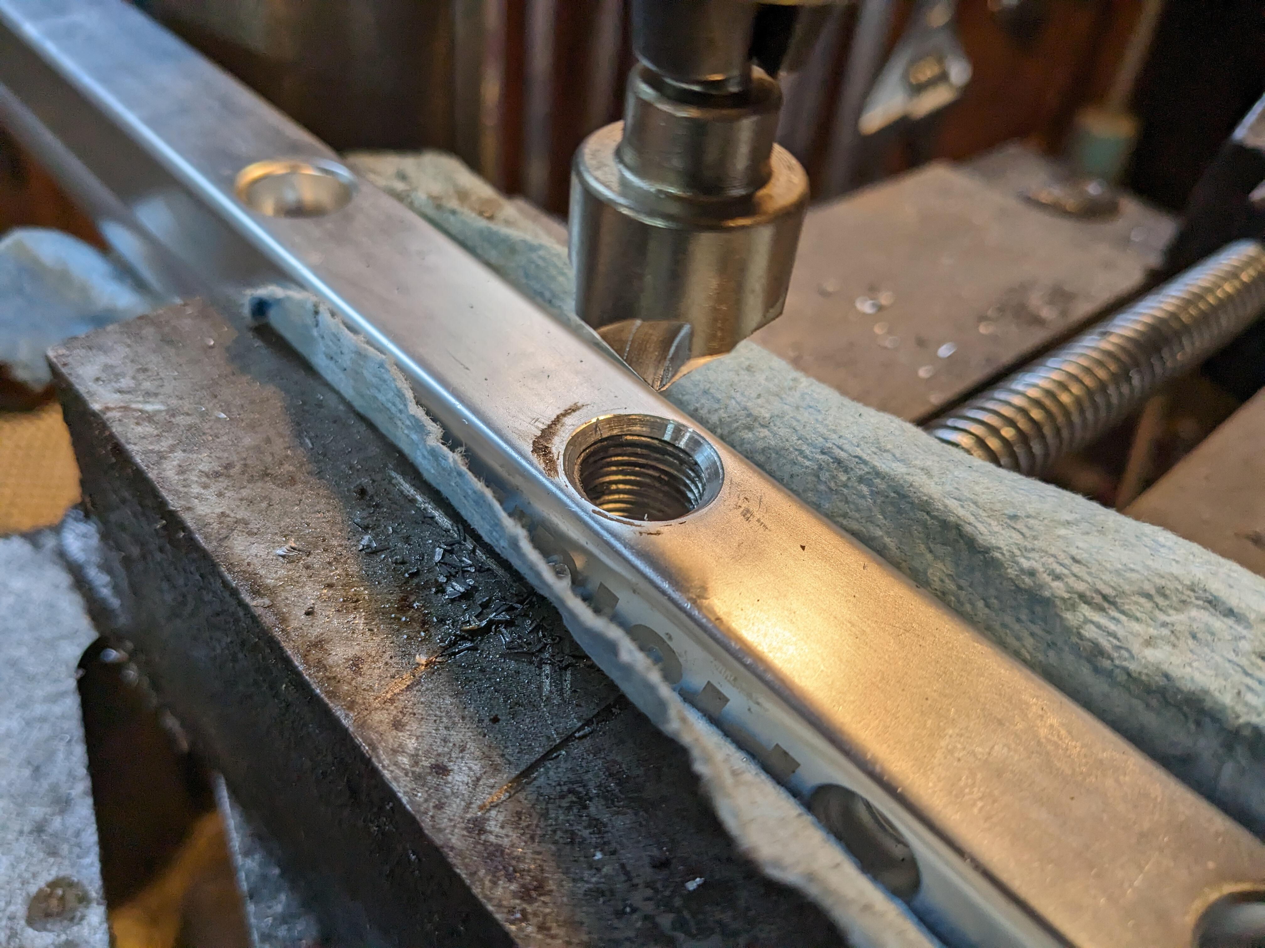

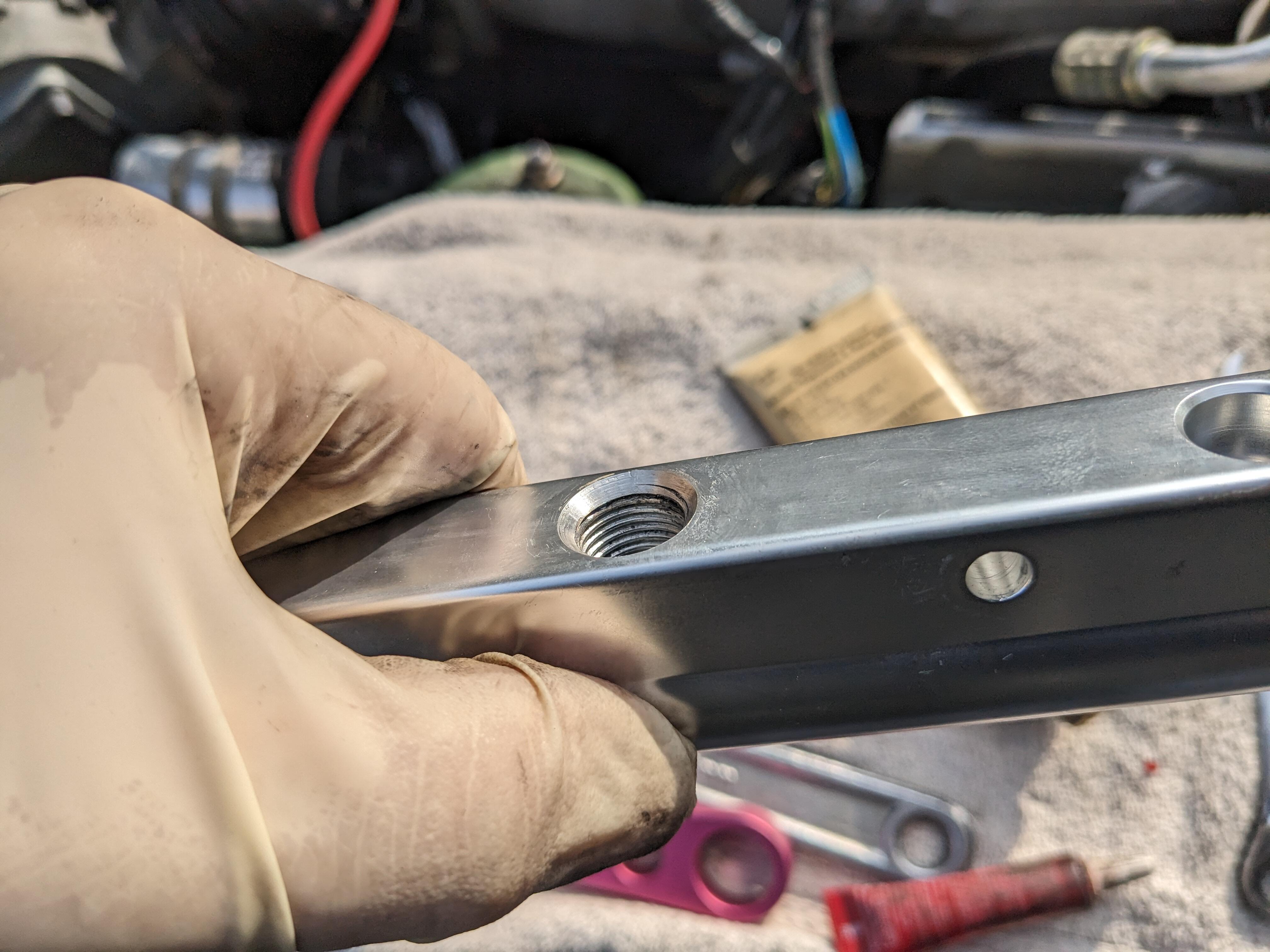

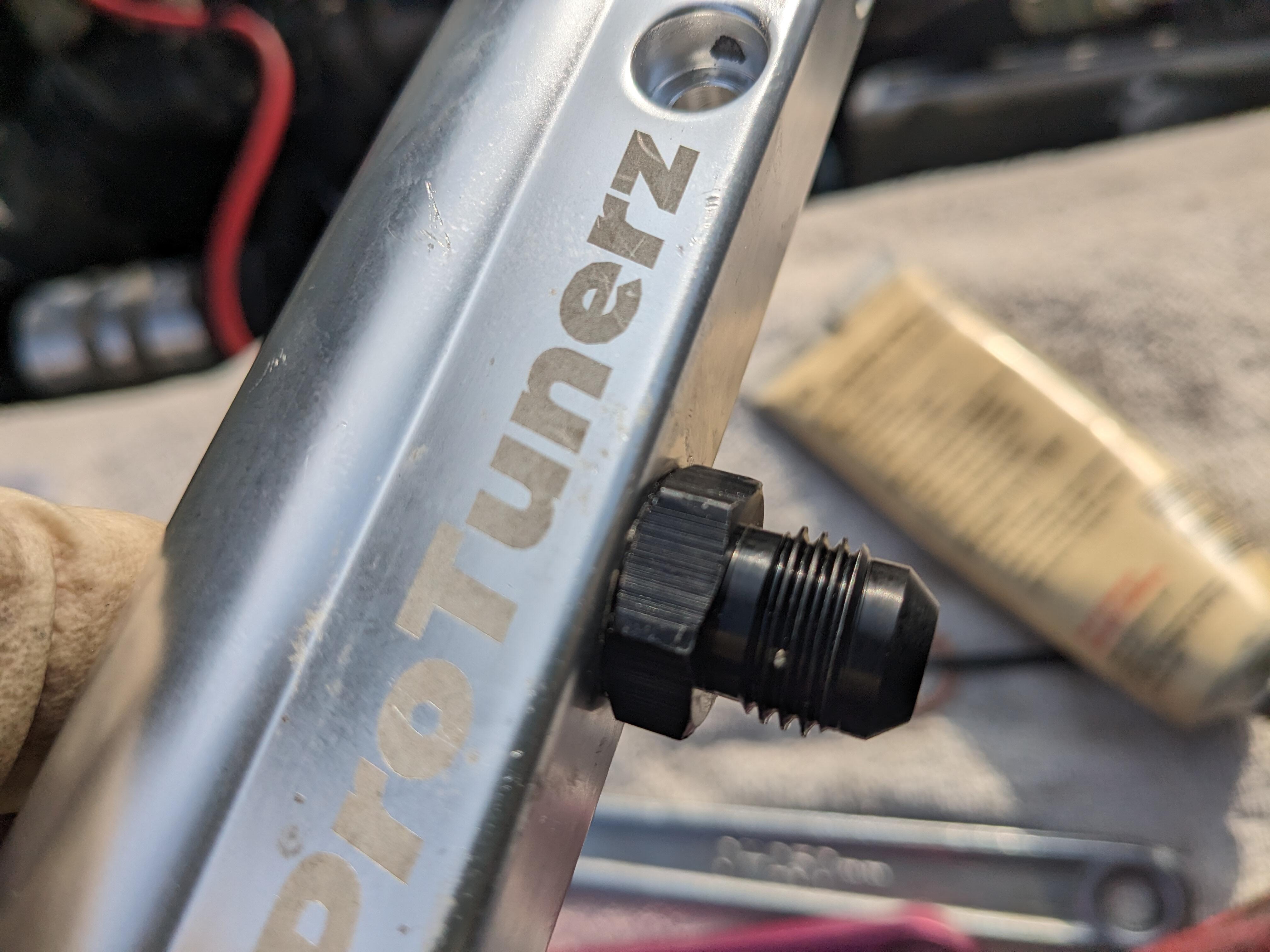

Countersunk the first one (hand cut, no chatter or burrs) ProTunerZ didn't want it back.
Oring seats properly now (in the old one)
Edited by HusseinHolland
My protunerz fuel rail has the same shallow o-ring surface for the CSV line. @HusseinHolland what is the name of the drill bit you used on yours? It looks like a deburring bit (45 degree?). I am heading out to Home Depot, will look for one. Thanks!
Sorry didn't see this earlier. It's a countersink bit,  I think they are typically 82º, so not aligned with the 37º JIC fittings, but it still works
