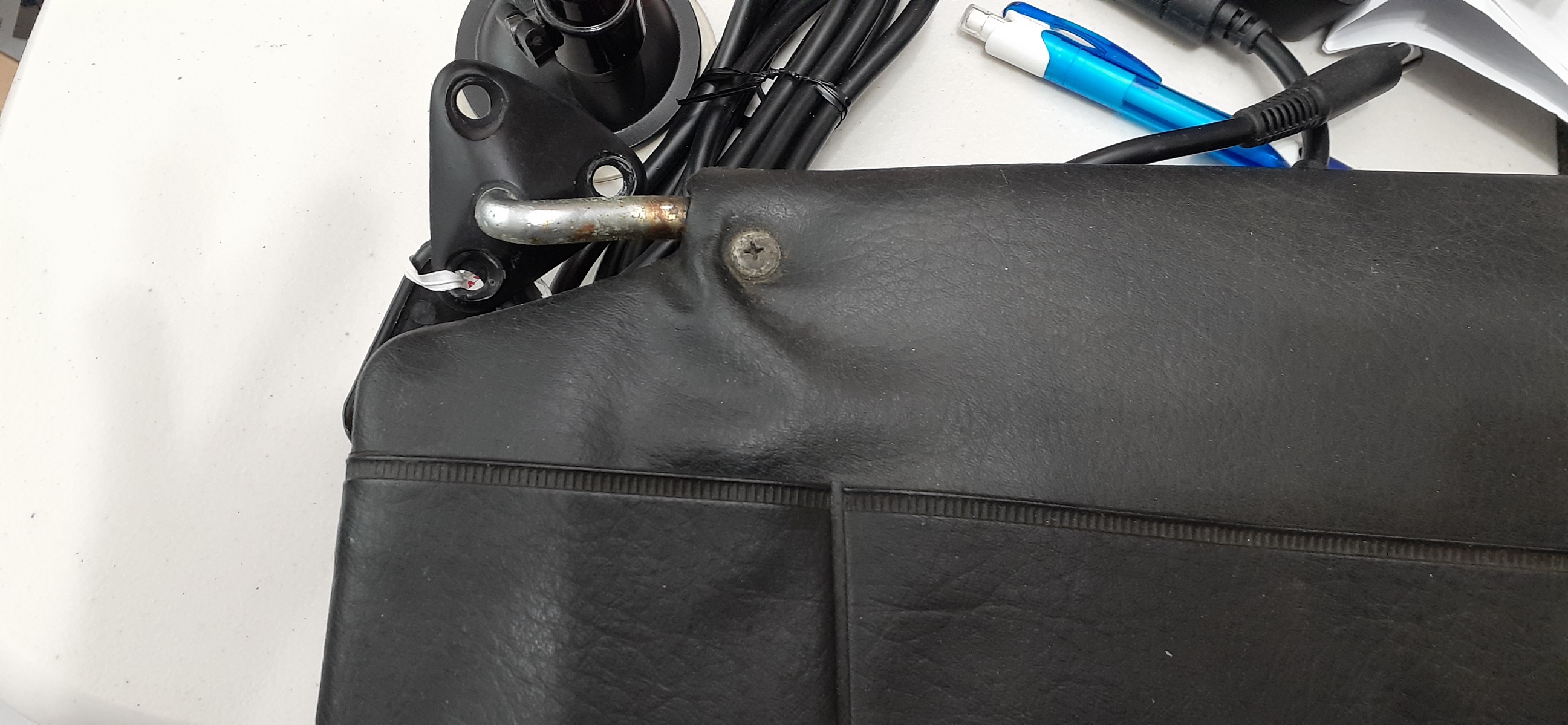

April 21, 20231 yr comment_652844 2 minutes ago, kenward1000 said: Which screw? This one Link to comment https://www.classiczcars.com/forums/topic/68286-droopy-sun-visor/#findComment-652844 Share on other sites More sharing options...
April 21, 20231 yr Author comment_652846 Hmmm, neither of my sun visors have that screw. Link to comment https://www.classiczcars.com/forums/topic/68286-droopy-sun-visor/#findComment-652846 Share on other sites More sharing options...
April 21, 20231 yr comment_652847 Nissan didn't use fuzz. You know where it is... Link to comment https://www.classiczcars.com/forums/topic/68286-droopy-sun-visor/#findComment-652847 Share on other sites More sharing options...
April 21, 20231 yr comment_652849 Fuzzy visors mean only one thing; you're screwed if you can't find the screw. And even if you can, you'll need a fuzzy screw driver or you'll screw the fuzz while you're screwing. I would say screw U to the fuzzy visors. Link to comment https://www.classiczcars.com/forums/topic/68286-droopy-sun-visor/#findComment-652849 Share on other sites More sharing options...
April 21, 20231 yr Author comment_652850 6 minutes ago, 26th-Z said: Fuzzy visors mean only one thing; you're screwed if you can't find the screw. And even if you can, you'll need a fuzzy screw driver or you'll screw the fuzz while you're screwing. I would say screw U to the fuzzy visors. What can I say? I haven't replaced the sun visors. Though my 5/71 240Z isn't a series 1 car (based on the chassis serial number), it has a number of series 1 parts, like the center console, hatch vents, vertical defroster wires, skinny fuel evap container, etc. Maybe just have to buy replacement visors. Link to comment https://www.classiczcars.com/forums/topic/68286-droopy-sun-visor/#findComment-652850 Share on other sites More sharing options...
April 21, 20231 yr comment_652853 I don't know anything about your car's history. I'm just pretty pretty pretty sure that Nissan did not use fuzzy fabric on the visor. I could be wrong. You can probably feel the screw under the fabric if you squeeze in the right spot. Cut a tiny hole and stick a screwdriver in. Looks like somebody just sewed new fabric over the old vinyl. Probably made it heavier, so more droop-prone. Link to comment https://www.classiczcars.com/forums/topic/68286-droopy-sun-visor/#findComment-652853 Share on other sites More sharing options...
