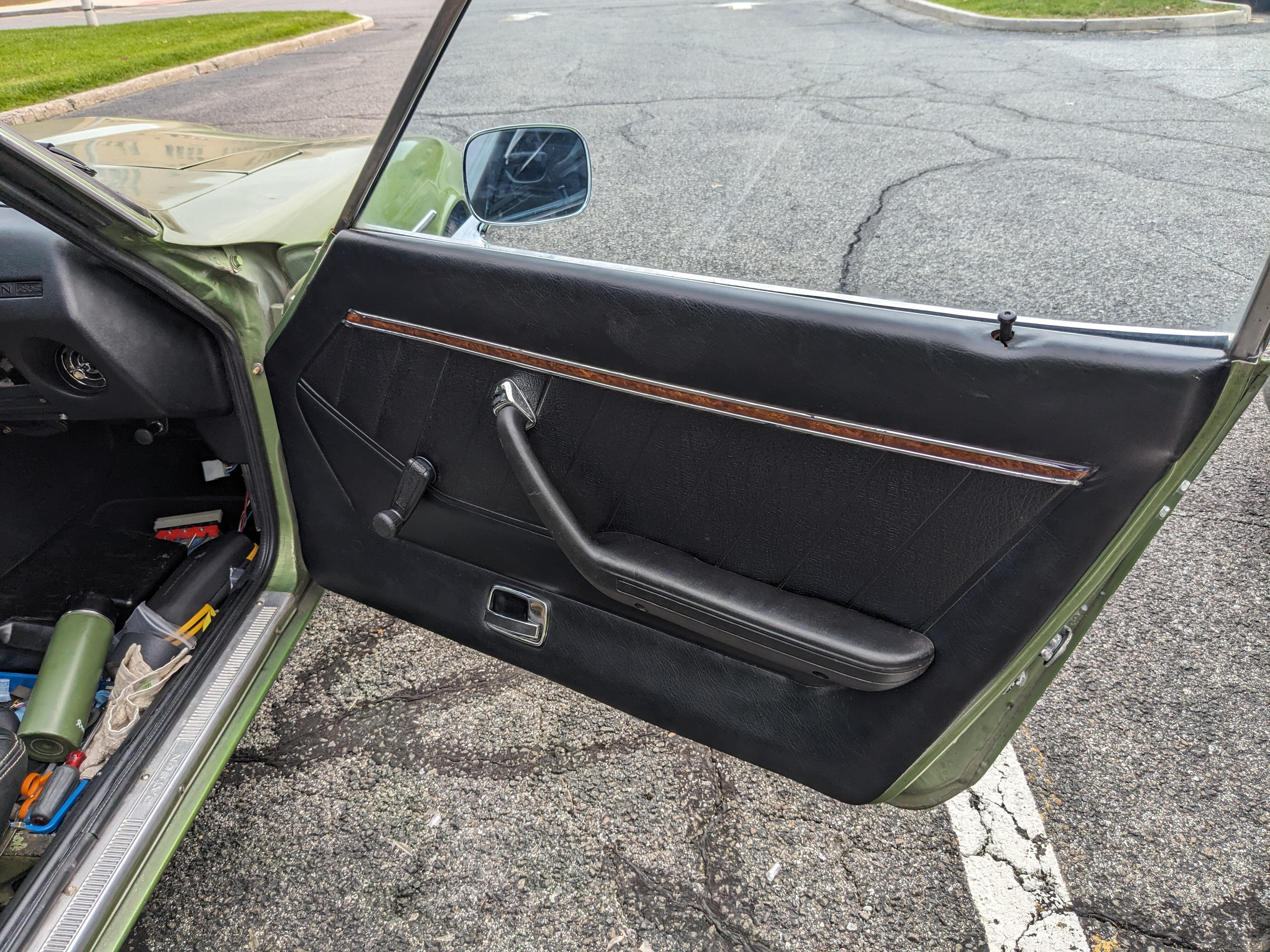

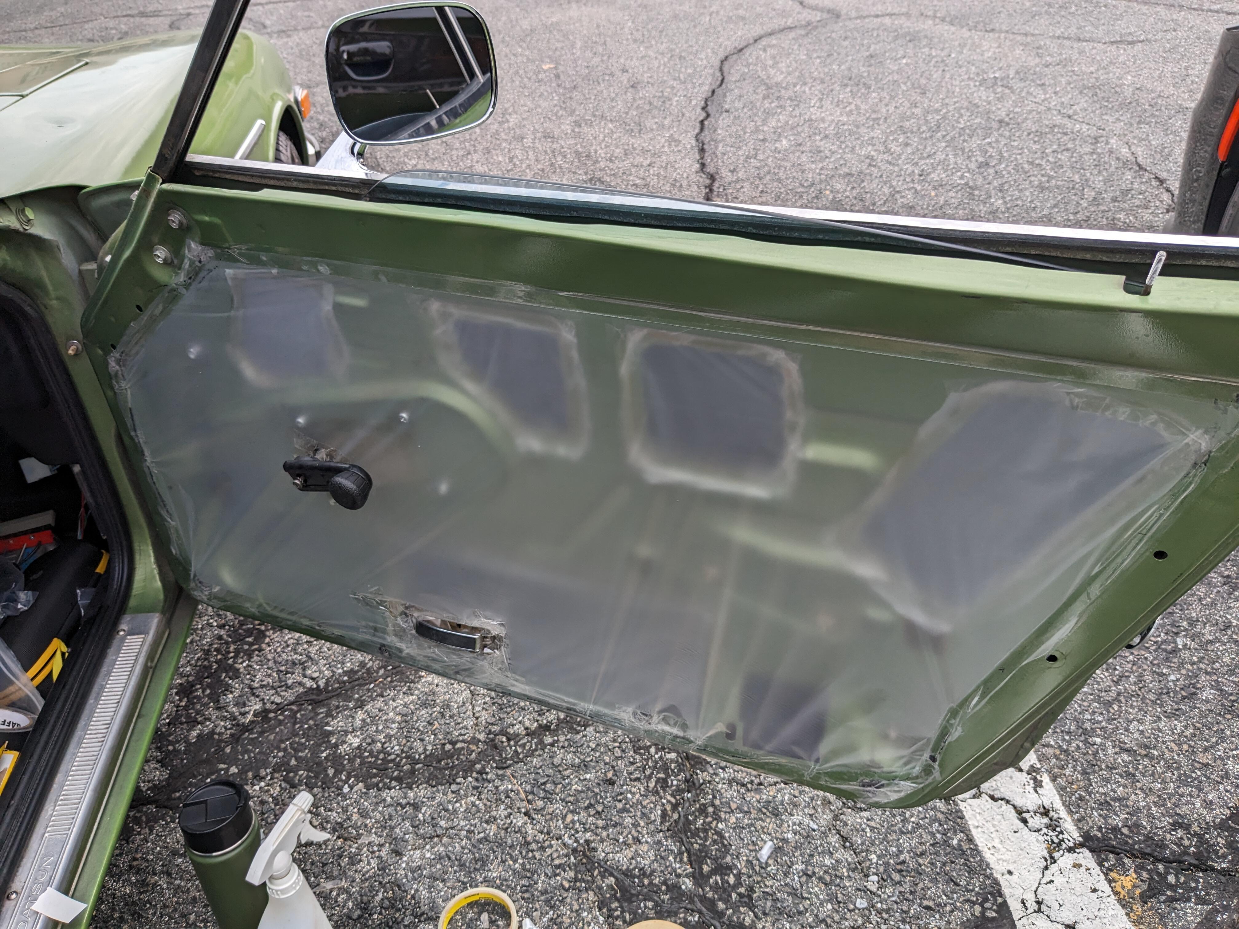

Took the passenger door apart. Didn't have time to document much on this side, it took me about 2 hours, and the Mrs was getting testy
Have to put the interior panelling back together tomorrow
also drilled & tapped the window winder M5 x.8 to accept the Volvo 240 crank handle. The Volvo shaft has twice as many splines, but it fits snugly on the shaft, so I'm not going to have to cut & weld as I did with the DS

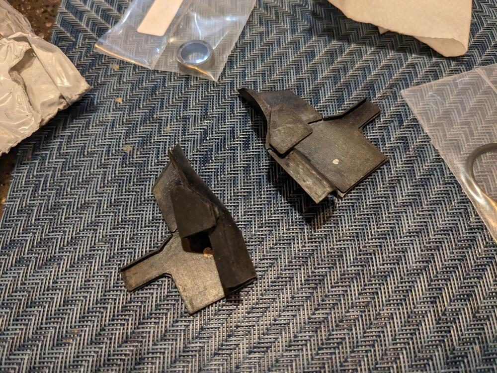

EDIT - I did shove the rear molding in place between the frame & door - but I couldn't tell from the form factor exactly how it was supposed to fit. Any chance someone has a pic with theirs in place?

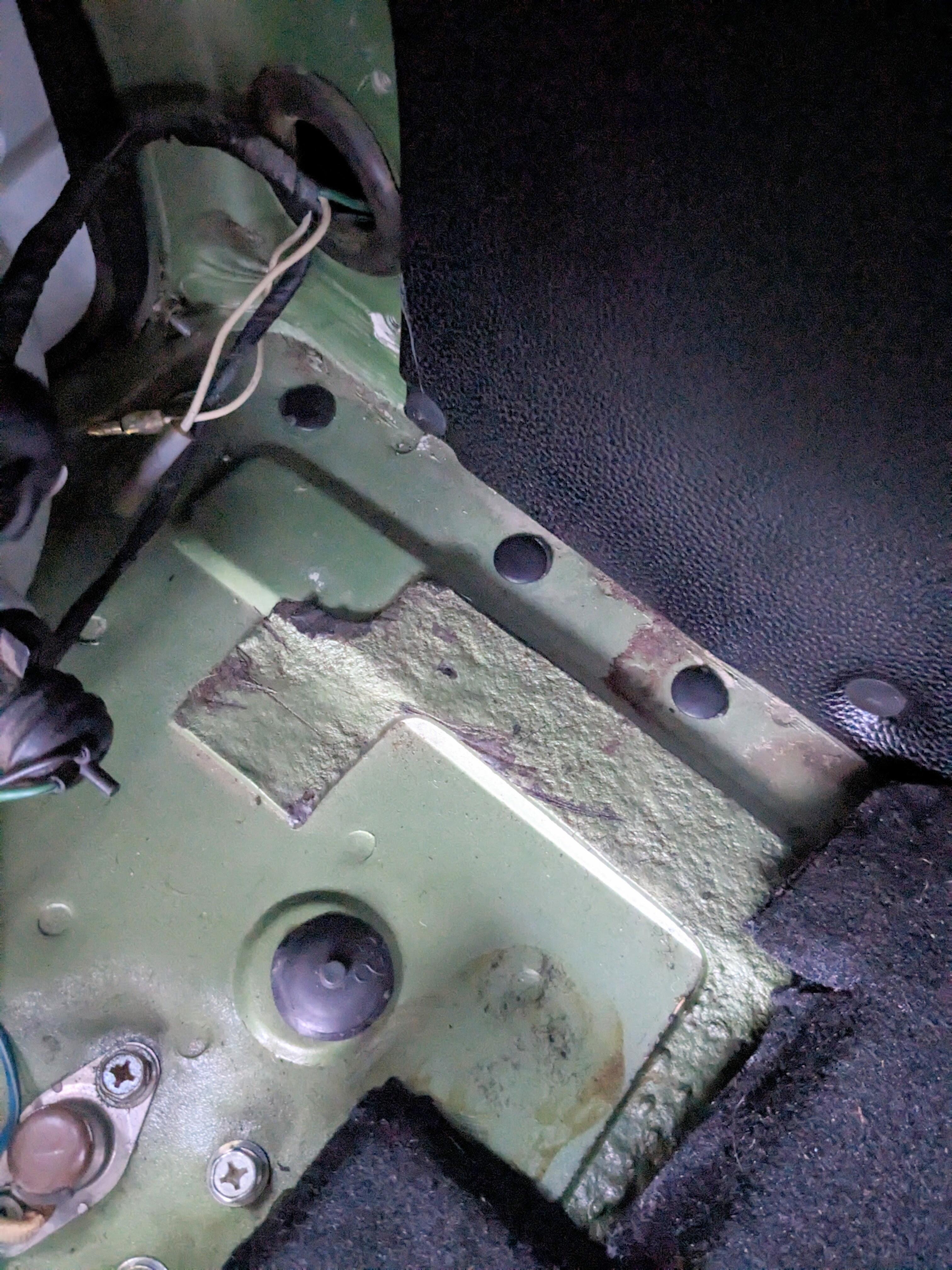

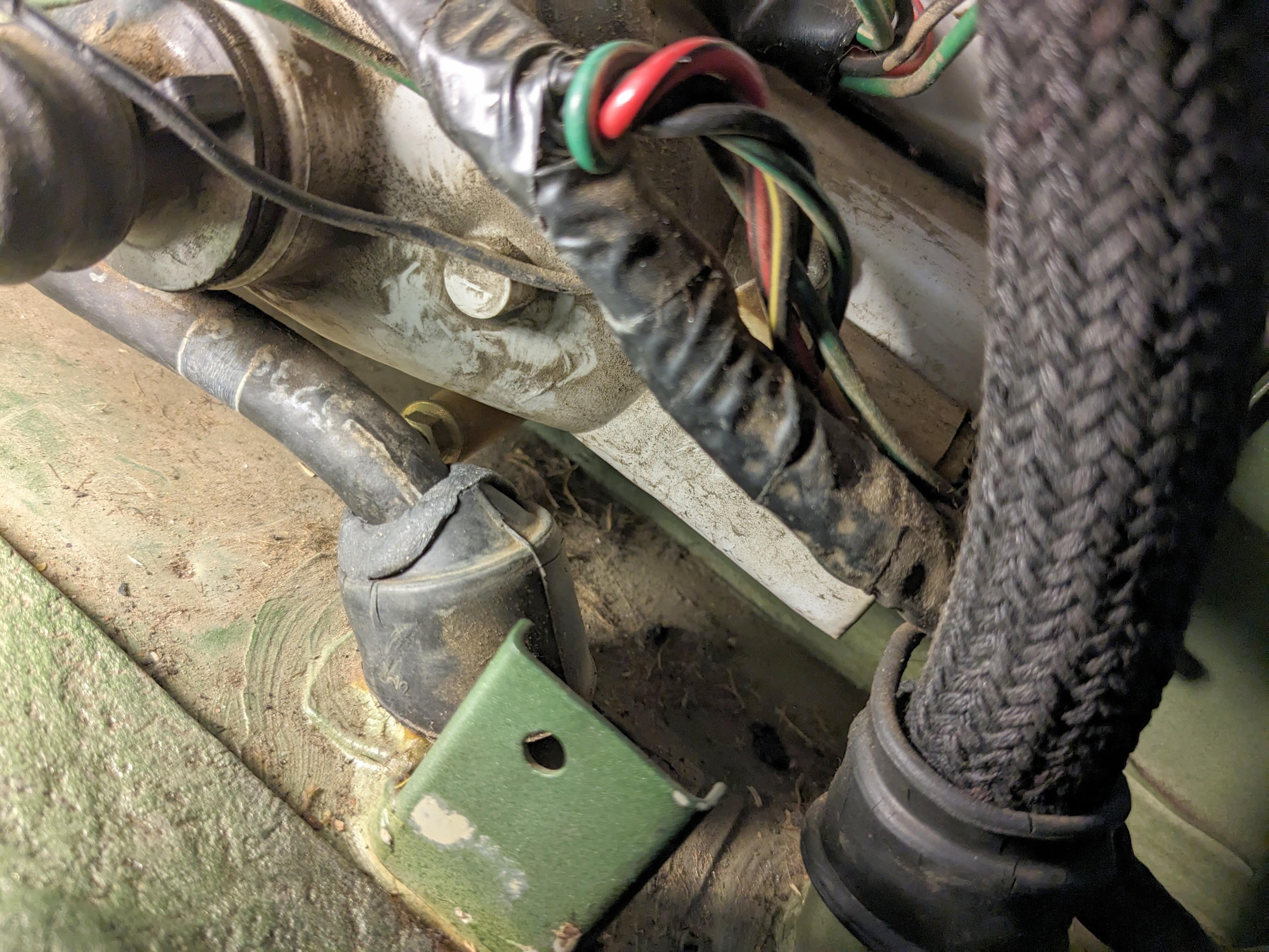

Thank you - the antenna drain I plugged sometime ago, the PO put in a manual antenna mast. I'll look at where the EVAP lines come through the floor, and the harness grommet. T/light gaskets are coming...
Today I got the door sealed back up & put the door card back on. I need to find a grommet for the lock button

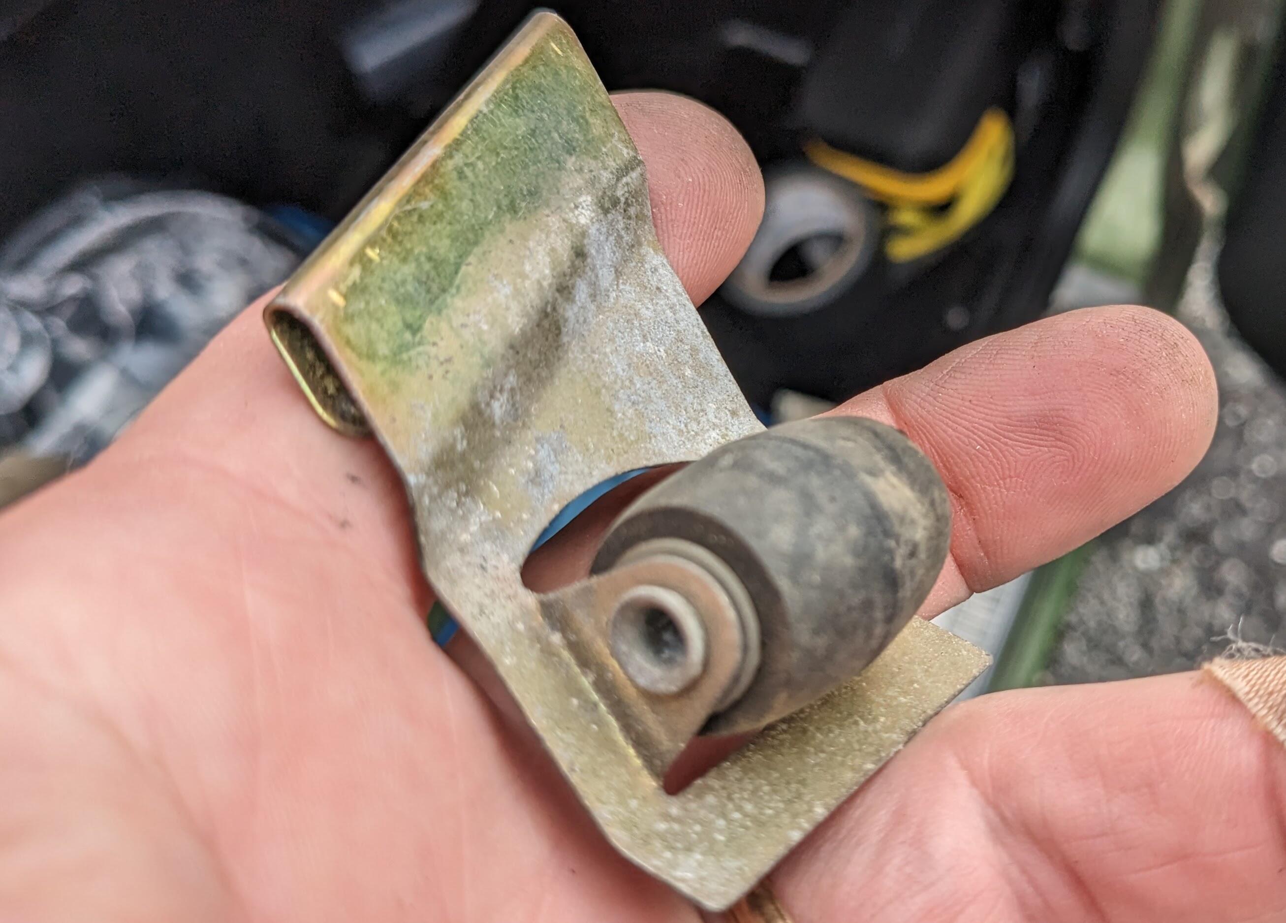

Found this in the bottom of the door yesterday - the tab has no tension anymore, so just as well I bought complete new ones

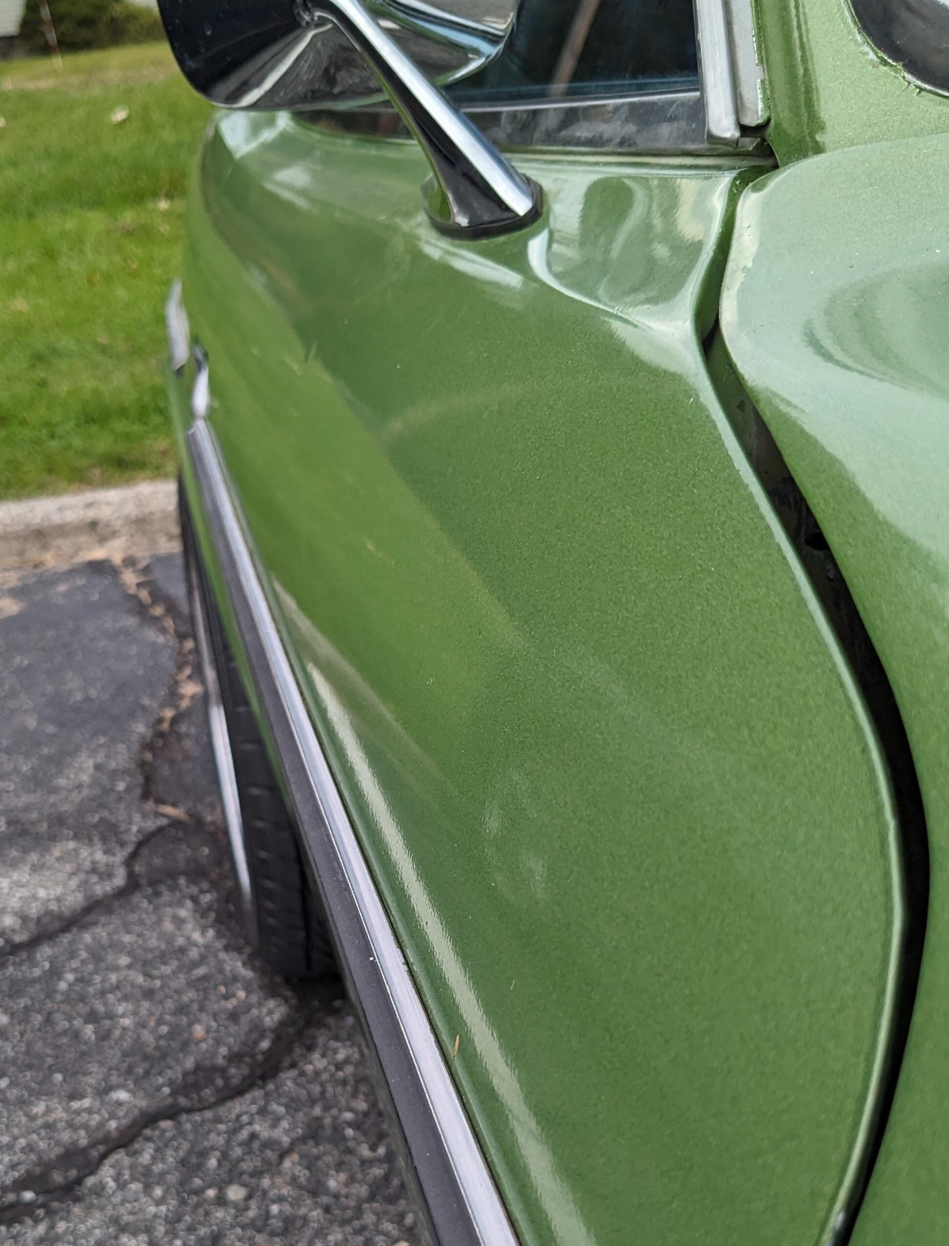

Before I put the door all back together I massaged the two dents as best possible, used a heat gun on the outside & a screwdriver handle to work the metal from the inside. Lower dent was between the visible dot & the belt molding
Fitted the Volvo 240 crank handle, and a replacement armrest - this one I found in black, so I didn't have to paint it/

I did find that the smaller vent hose grommet was torn - so I sealed that for the time being
Also, I had removed the bumper shock & bracket on the DS, that left 3 holes that fed directly into the muffler cavity. Filled them with sealed plugs

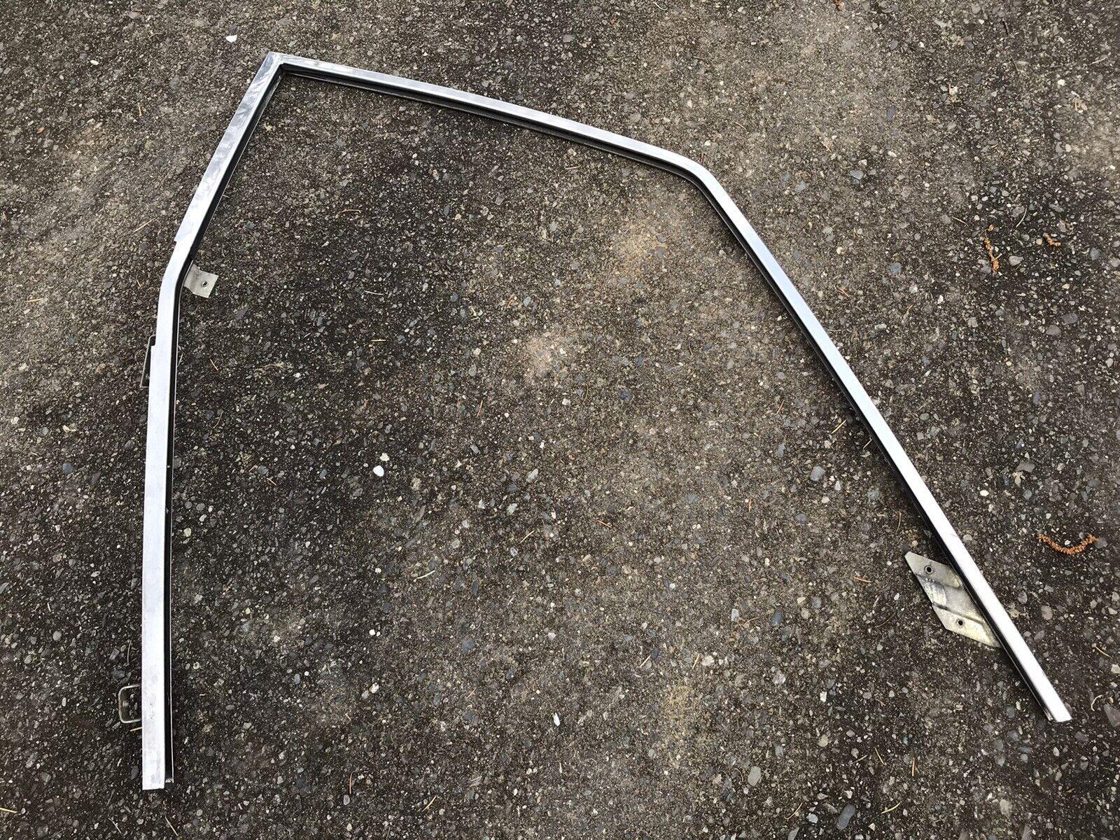

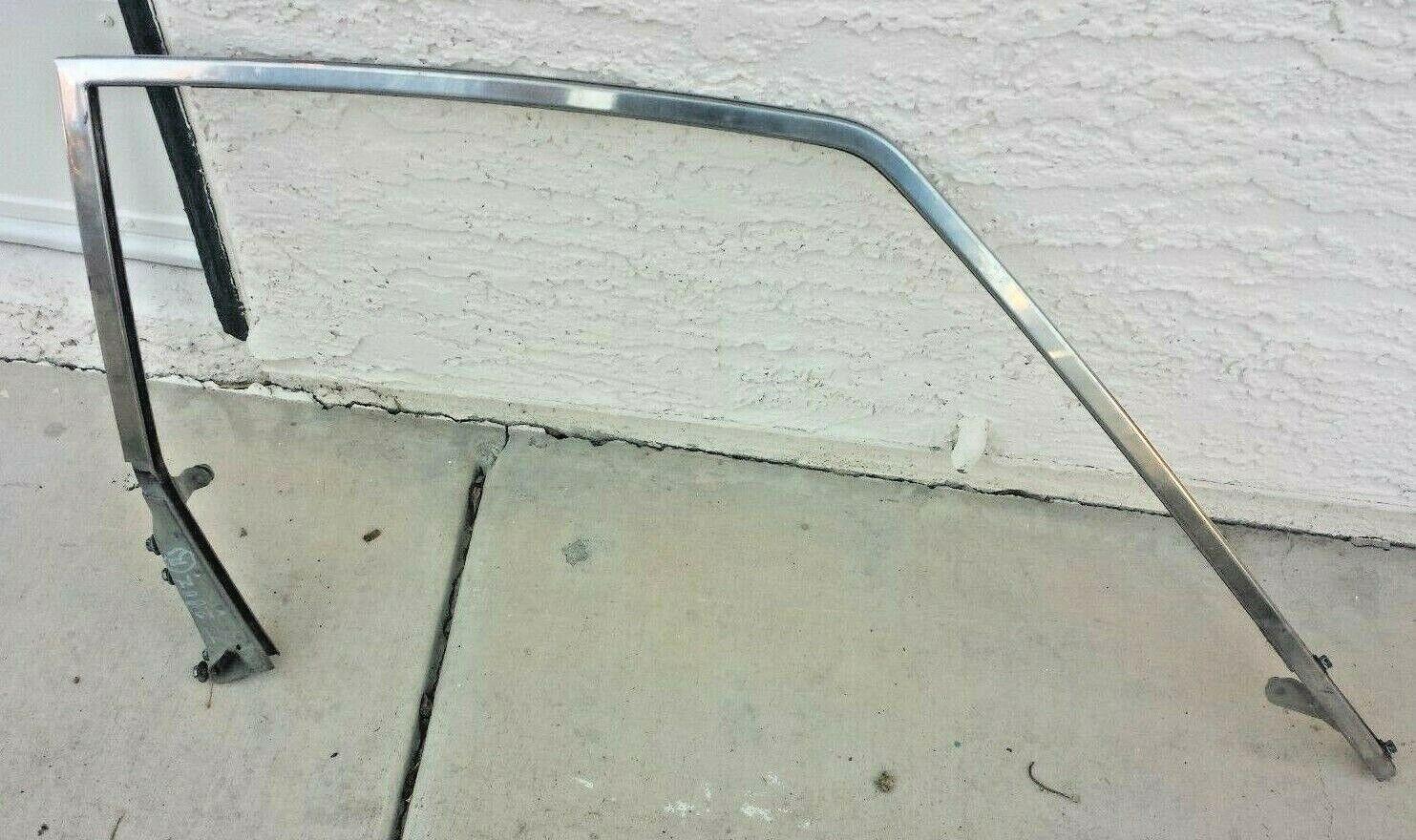

Starting in 77 they included a groove along the top of the stainless window trim to accept a piece of rubber stripping. I don't have any pics handy, but can snap one if you want to see it.
Just another reason that the 77s are better.   ROFL

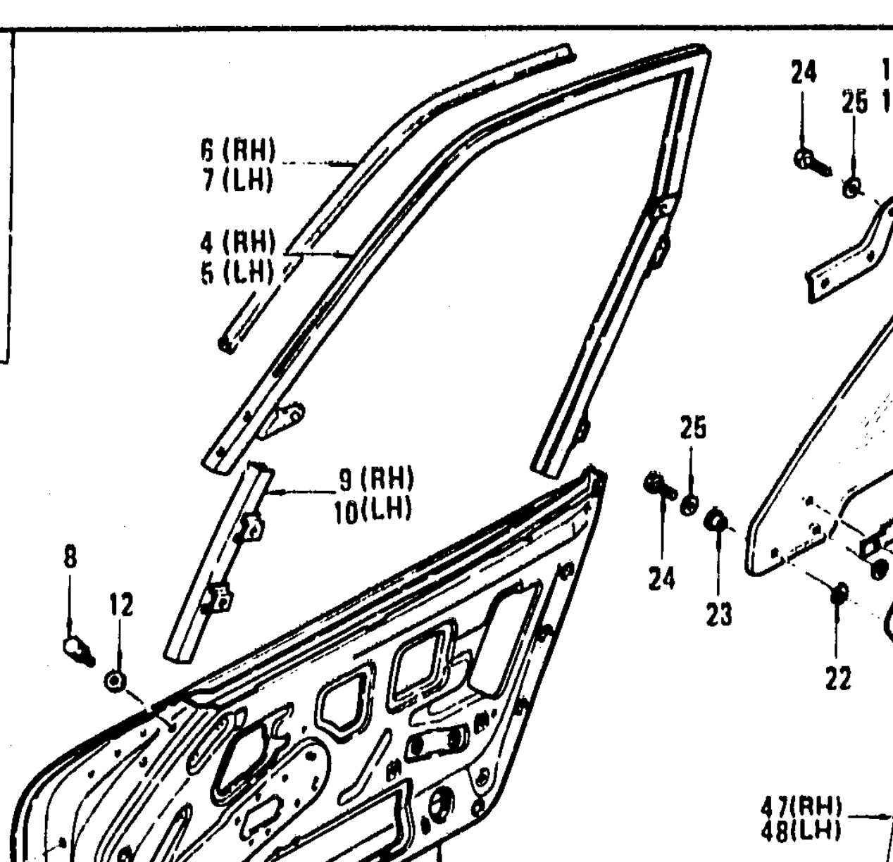

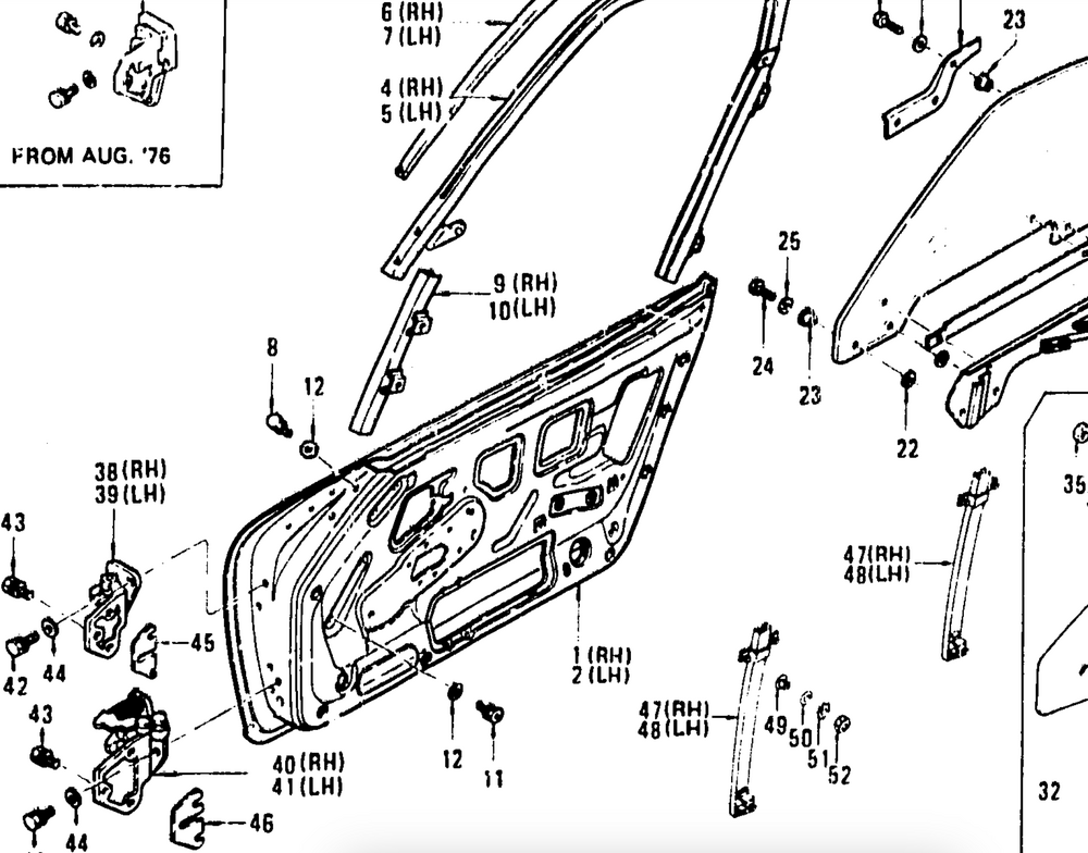

Question - will the later frames fit the 75 door? Same attachment bracketry built in the the frame? (4 mount points at the front, 3 at the back vertical, 1 facing inward top rear of door skin) I'd just as soon update mine to the later version, especially since the coating on mine is compromised & has surface rust. If the frame with physically fit the door, and it's just the brackets that are different, I could always cut them off the old frames.
Also, if you have a pic that shows the channel w/seal - can't tell from the part manual exactly where it goes. The seals I bought don't appear to be long enough to go the full length

I will take a look at the trim mounting scheme and take a couple pics of the later design. I don't know if the 77-78 design will fit other years, but maybe we can figure it out.
I do know that the 77-78 doors are very different in a lot of ways, but I'm not sure if the window trim is one of them.

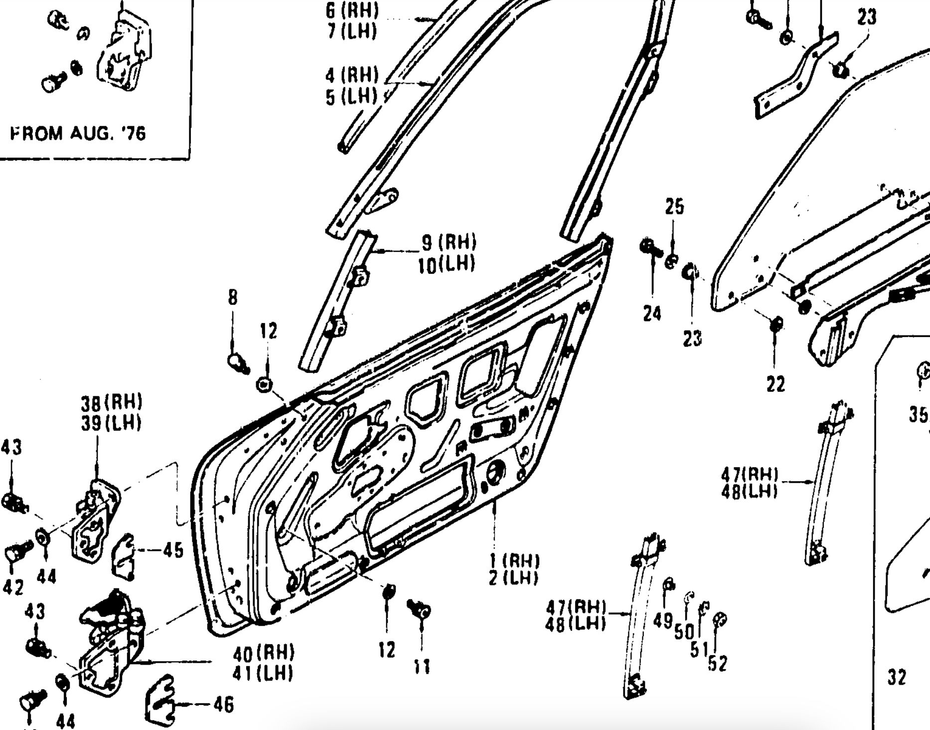

OK - looking at pics of a 77-78 frame and the earlier frame - the later frame has a separate lower section #47 & #48 in the catalog
Only one bolt at the front inner instead of two on the earlier style. Rear ends a few inches below the 2 vertical mounts that likely align with the 2 on mine, and has two additional horizontal bolt points. If I can get the later lower guide channels maybe I can make it work
