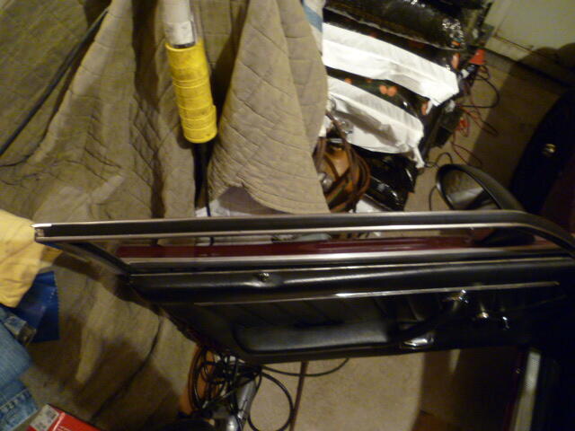

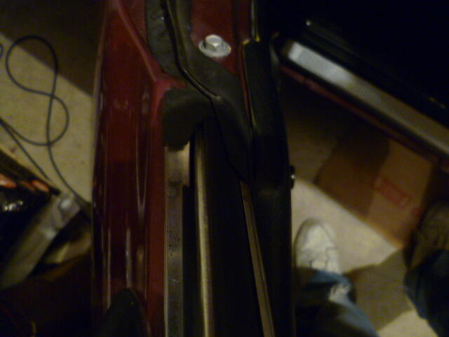

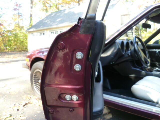

I finally had the opportunity to snap a couple pics of my later version window trim (sash?) mounting points. Certainly too late to help much now, but here's what I got.
This last shot is a wide headed Phillips screw behind the door panel up at the door lock corner of the panel.

I'll add reference pics of my door for comparison. Looks like the leading edge is the same, the rear inner, mine also has a dogleg anchor.

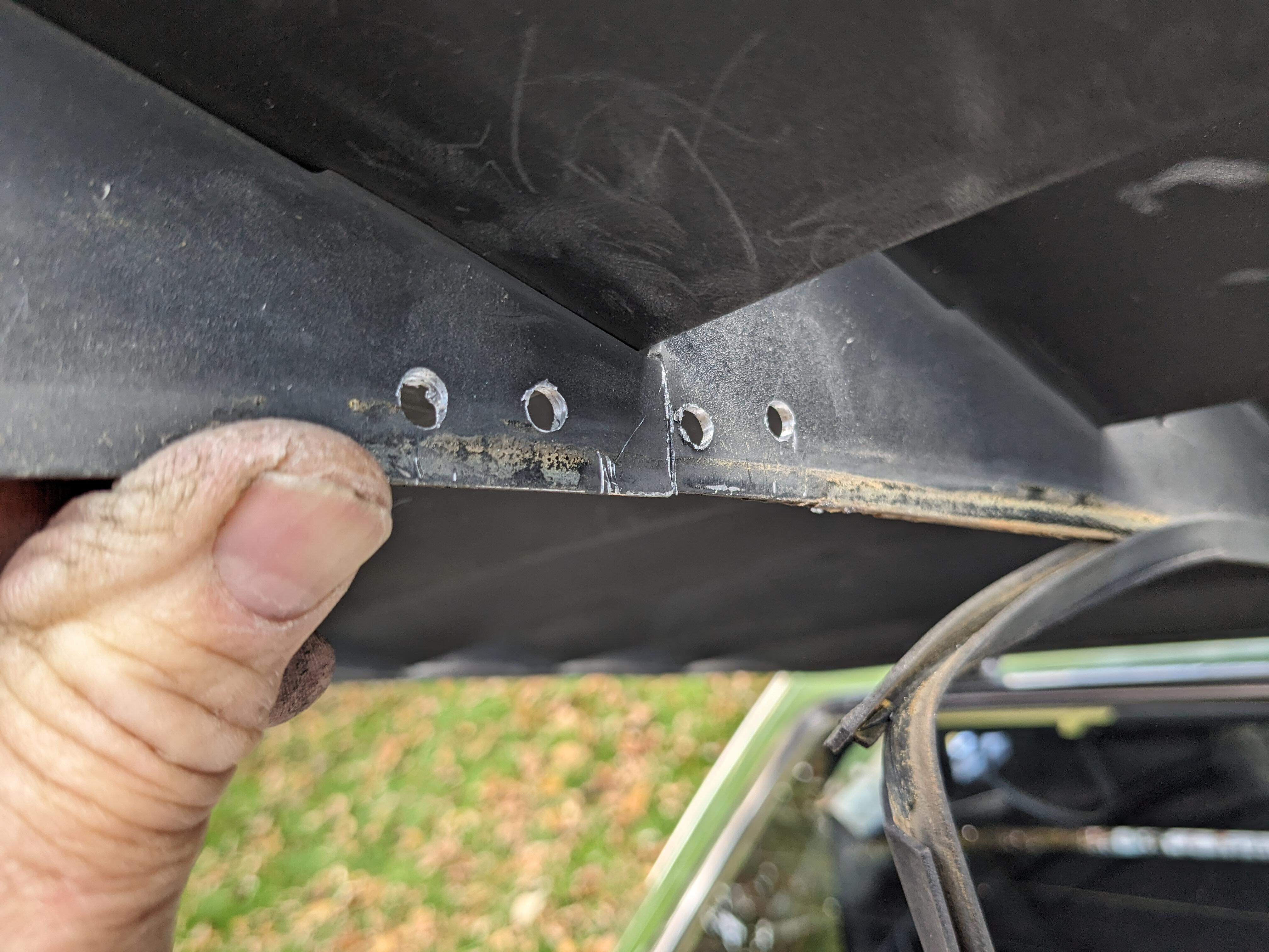

8 hours ago, HusseinHolland said:
I would also like a pic of the top of the frame showing where the top seal is located
Not great pics because it's in the dark garage, but hopefully these will help. If not, let me know and I can take some out in the sun next time.
Sorry for the dark. This is the front leading edge.
Rear trailing edge trying to show the channel that the weatherstrip fits into. My corner is torn off:
Those help - thank you - I can see it runs the length of the trough - that's what I wasn't sure of.

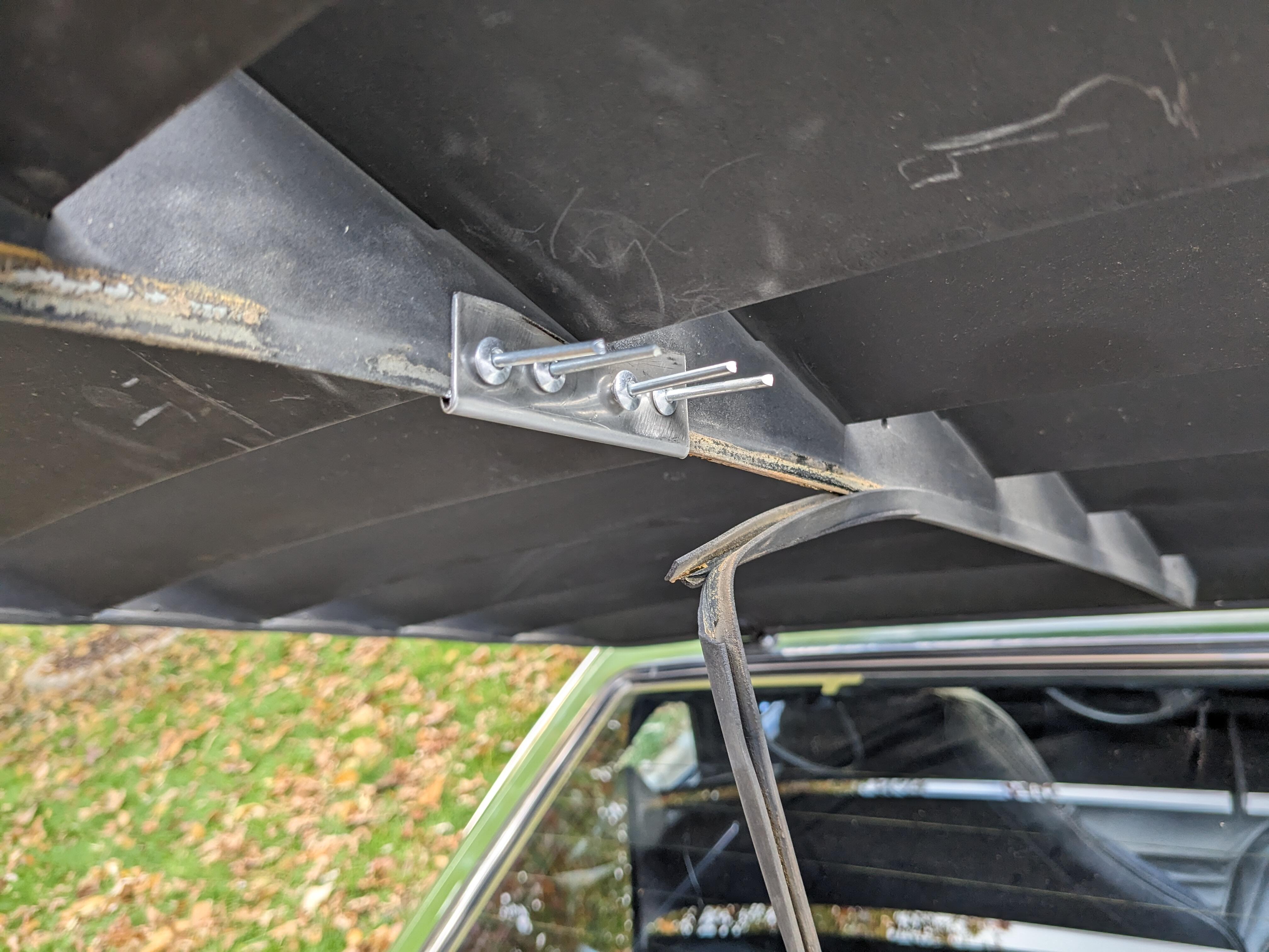

Now that the hatch doesn't need to be slammed shut, I fixed the broken louvre center rib. I made a SS plate U channel to bridge the fracture & riveted it in place. Added channel isolator afterwards to prevent further damage/scratching of the rear glass.  One less annoying rattle to listen to.

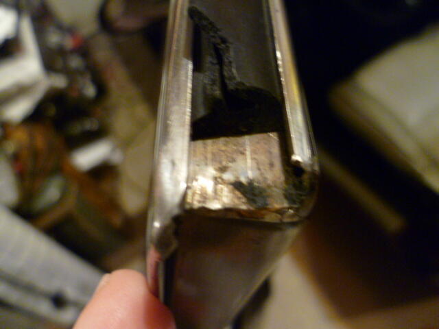

Cleaned up the 78 window frames (sashes) I bought. Certainly not 'excellent' condition - multiple scratches from storage. Hopefully I can polish most of them out, never tried before. He didn't pack them with any buffer between them either. Have to figure what compound may work without removing the coat. My existing frames are worn thin & have surface rust on the seal surface, which is why I want to replace them
Stripped all the old inner & outer seals
