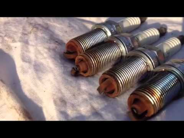

May 6, 20231 yr comment_653389 On 5/4/2023 at 10:02 AM, SteveJ said: Stock motor with stock compression - go with 87 or choose 91 if you like to burn money for no gain. If you have higher compression, go with 91. What's your thinking on cars that stay in the garage mostly? I know people reccomended adding octane boost for cars that sit for awhile between driving. I've gone on the idea of more octane fuel added would kind of keep me on plane with additives without the exta effort but I learn something everytime I read classiczcars.com. Link to comment https://www.classiczcars.com/forums/topic/68307-fuel-recommendation-for-a-73-240z-with-rebuilt-engine-and-su-carbs/?&page=2#findComment-653389 Share on other sites More sharing options...
May 6, 20231 yr comment_653390 On 5/6/2023 at 10:28 PM, siteunseen said: What's your thinking on cars that stay in the garage mostly? I know people reccomended adding octane boost for cars that sit for awhile between driving. I've gone on the idea of more octane fuel added would kind of keep me on plane with additives without the exta effort but I learn something everytime I read classiczcars.com. Octane boost fouls plugs. I had someone come over for a tune-up. I pulled a plug, and asked, "Do you run octane booster?" He was surprised I knew, but the plugs ratted him out. Example: Image shamelessly stolen from https://www.e90post.com/forums/showthread.php?t=1162289&page=2 Stabil is a fuel stabilizer and doesn't foul plugs AFAIK. Edited May 6, 20231 yr by SteveJ Link to comment https://www.classiczcars.com/forums/topic/68307-fuel-recommendation-for-a-73-240z-with-rebuilt-engine-and-su-carbs/?&page=2#findComment-653390 Share on other sites More sharing options...
