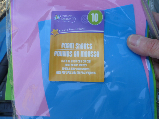

Craft foam sheets from the local arts and crafts store? That's what I did on my family truckster when the taillights started leaking on that one. Leave the original gasket in place and augment with a thin layer of auxillary foam. And maybe some seal-n-peel as well?
Something like this:
doesn't have to be neat... Just enough that it won't show from the outside:
