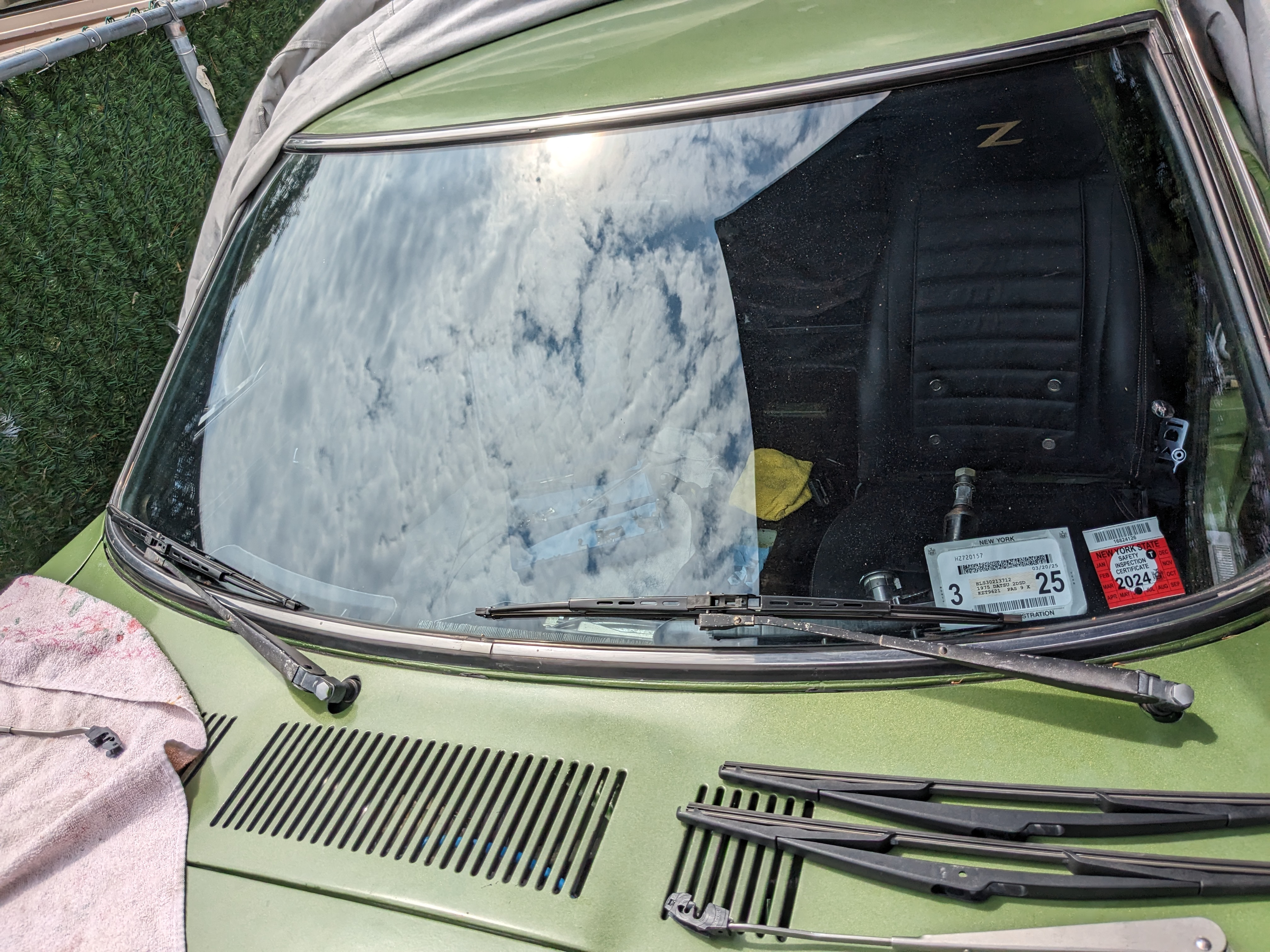

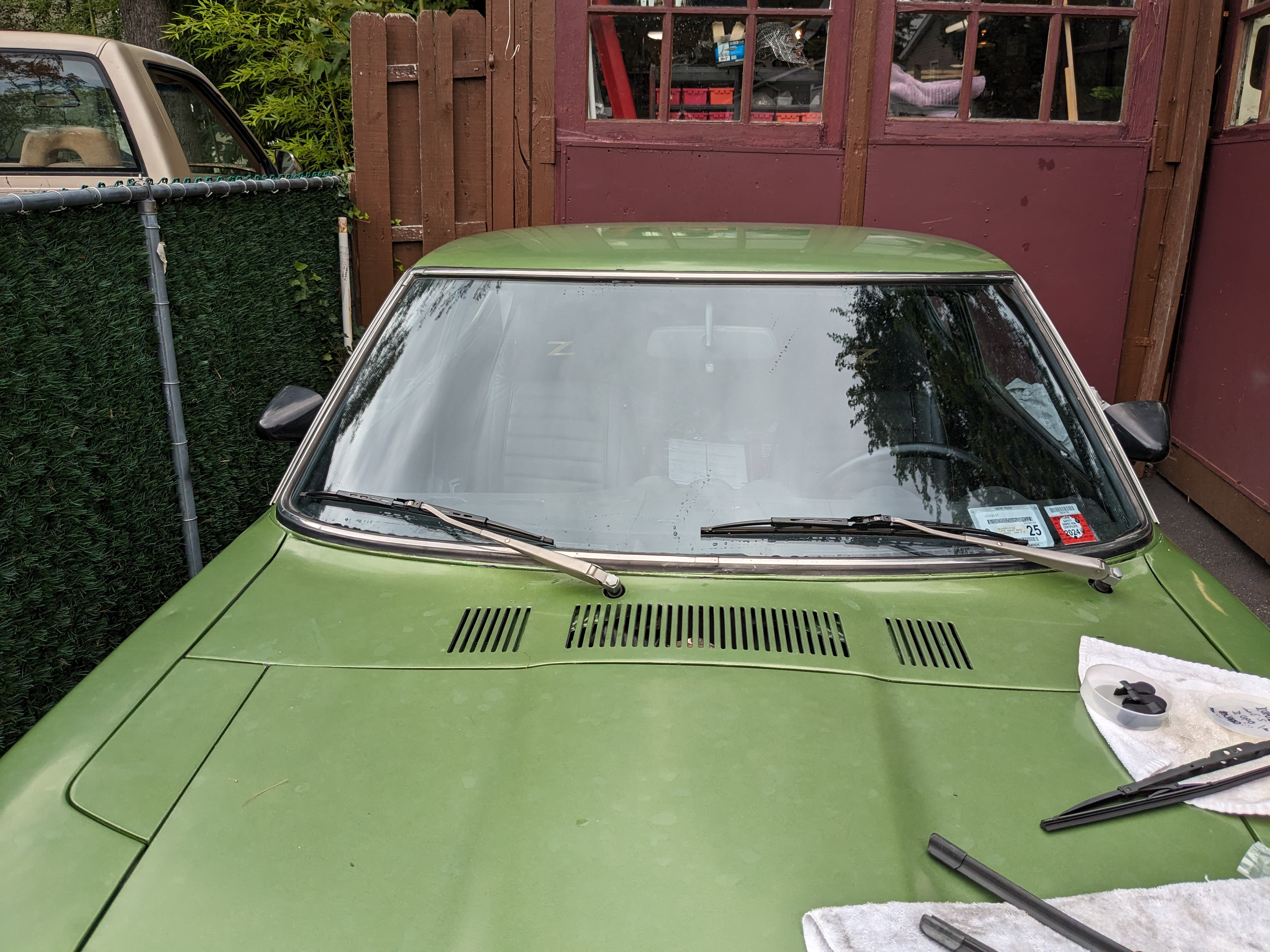

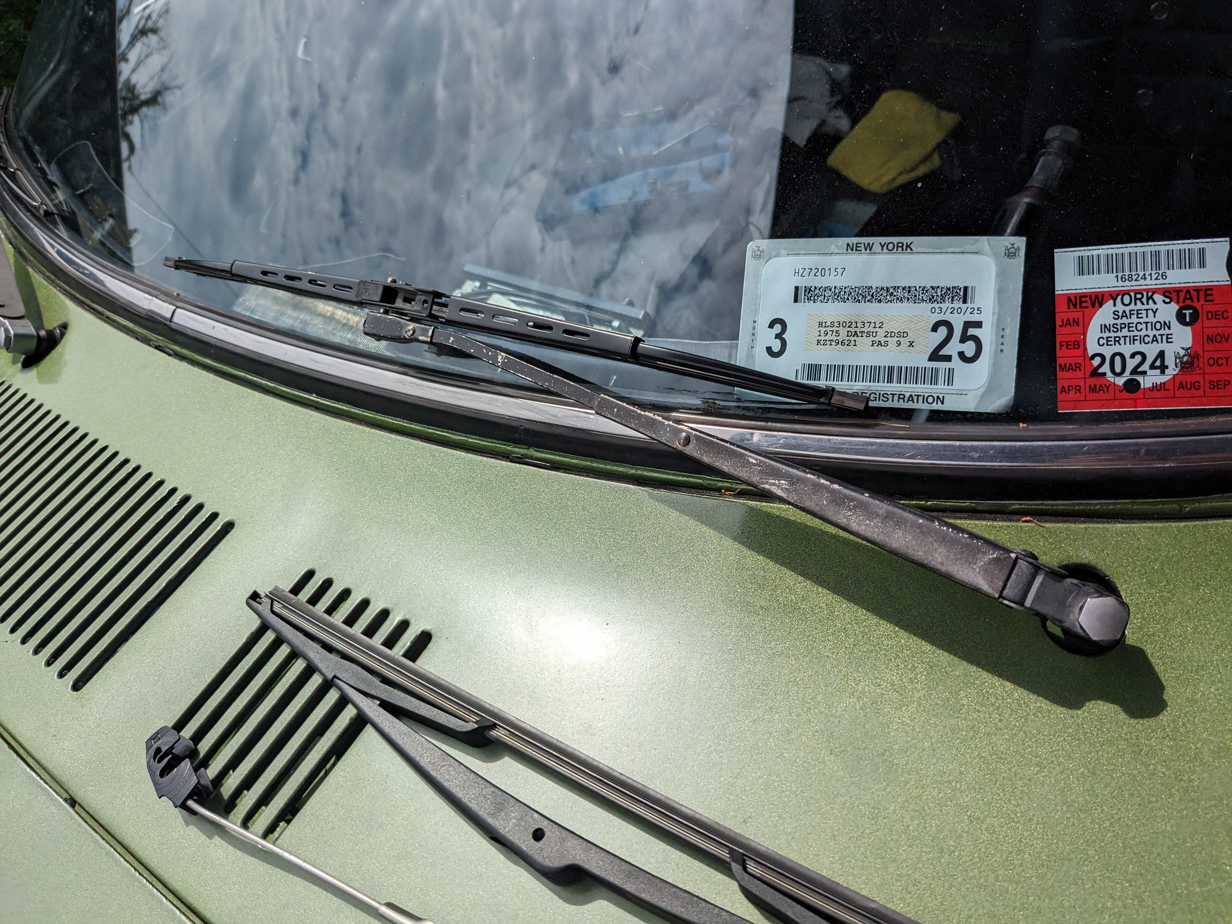

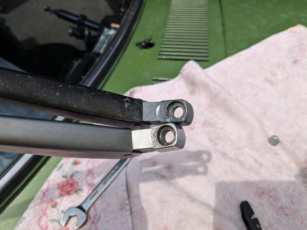

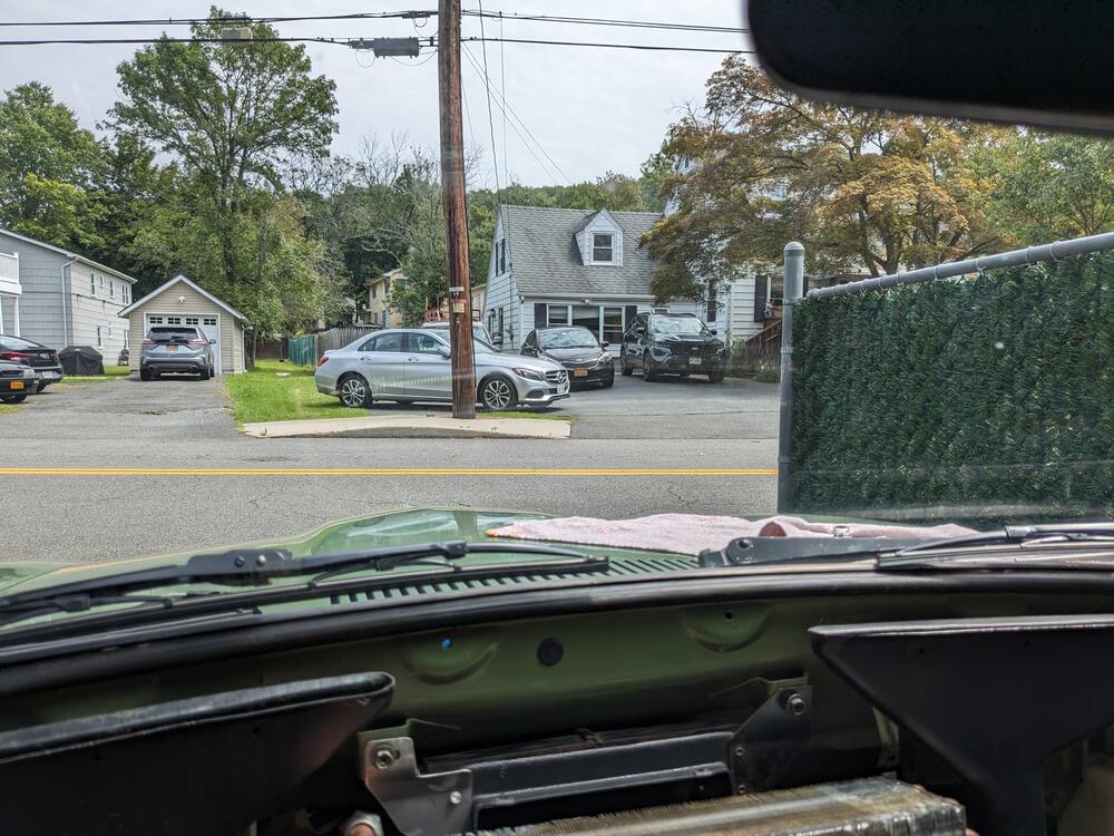

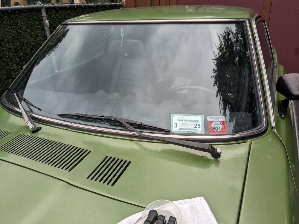

Now that I have the dash out & easier access to all the fuse/relay panel wiring, I'm going to revisit the interval relay. The other thing I disliked about the wipers is how high the arms & blades sit - when I'm driving the blades/arms interfere with seeing the nose of the car. So, I tried doglegging the stock arms to drop them - that did work to some extent, but not ideal. I also tried doglegging the arms off of a Volvo 240, that was better. Then a friend found arms intended for a 240 that are made in Japan (Trico, like the OEM), so the base mount is identical to the Datsun arm, however the blade attaches to an offset pin instead of to the arm directly. That allows the arms & blades to sit lower than the other options I've messed with. Much happier now
(Bosch) 240 arm, doglegged
(Trico) 240 arm (left)
base comparison
Just have to refinish them
view of hood

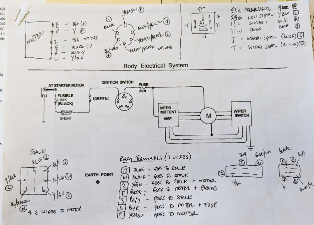

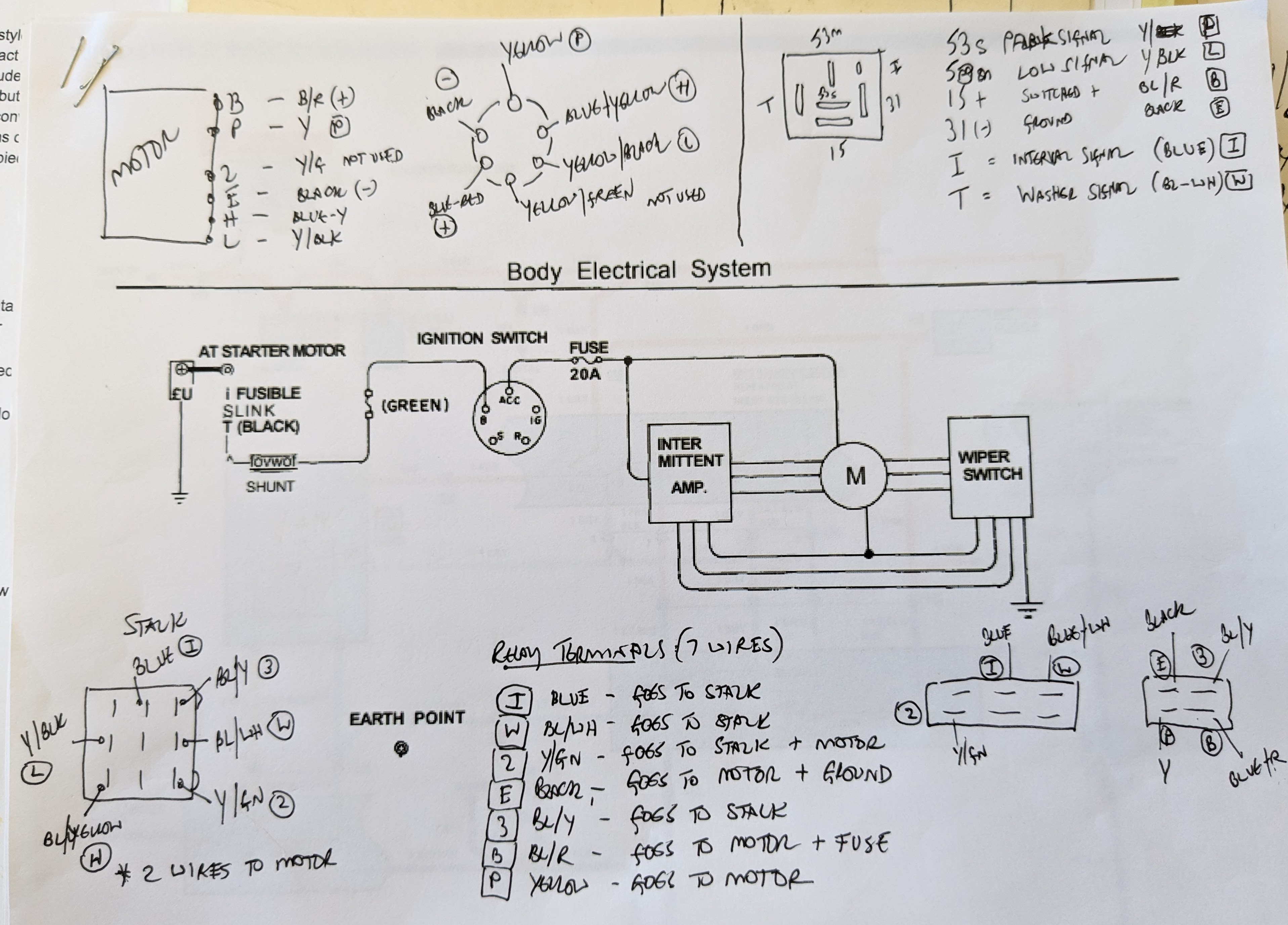

@SteveJ - I tried to quote your post & move it here - didn't work, so I copied your notes:
"P = Park
M = Motor
3 = High
E = earth/ground
B = Battery
I = Intermittent
W = Washer
2 = Low
Notice that the 3 isn't shown on this diagram and is also unused on the 75.
Oops, I made an error. The 75 wiring diagram shows the 7 terminals being used. I think I made the right corrections above. The weather is cooling off soon, so I may be in the garage more in the near future. I can do some testing I've been wanting to do."
So, what gets confusing is the use of the alpha & numeric terminal locations. The motor diagram shows H & L, so having 2 also represent Low makes no sense.
I made a sketch with the motor &  plug, the stalk & relay, so I can figure out which pins to use for the VW delay relay.
2 (yellow-green) isn't even used with the Honda motor, so it clearly has no current bearing on any operation.
