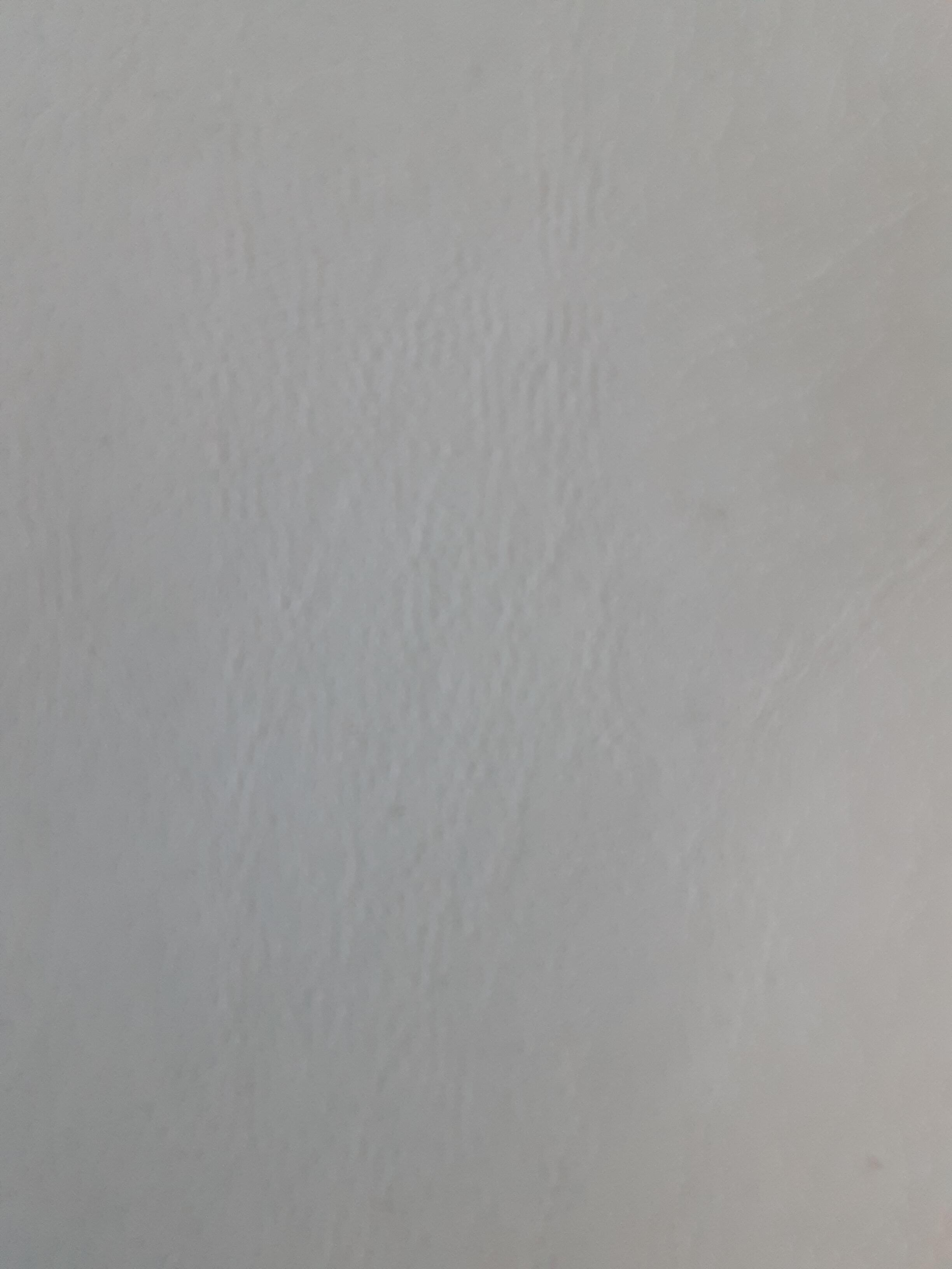

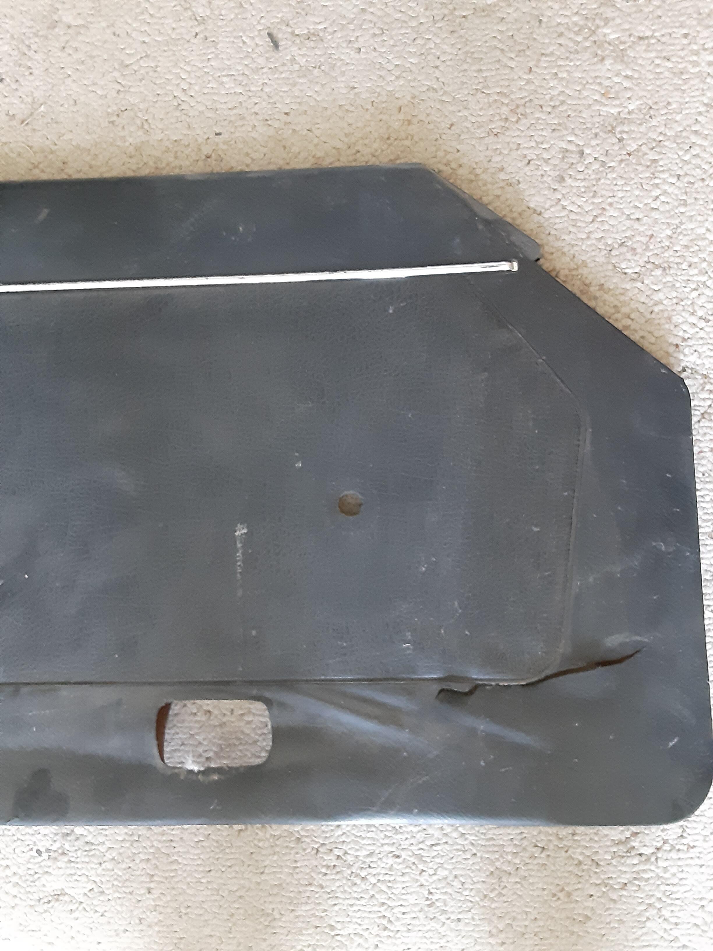

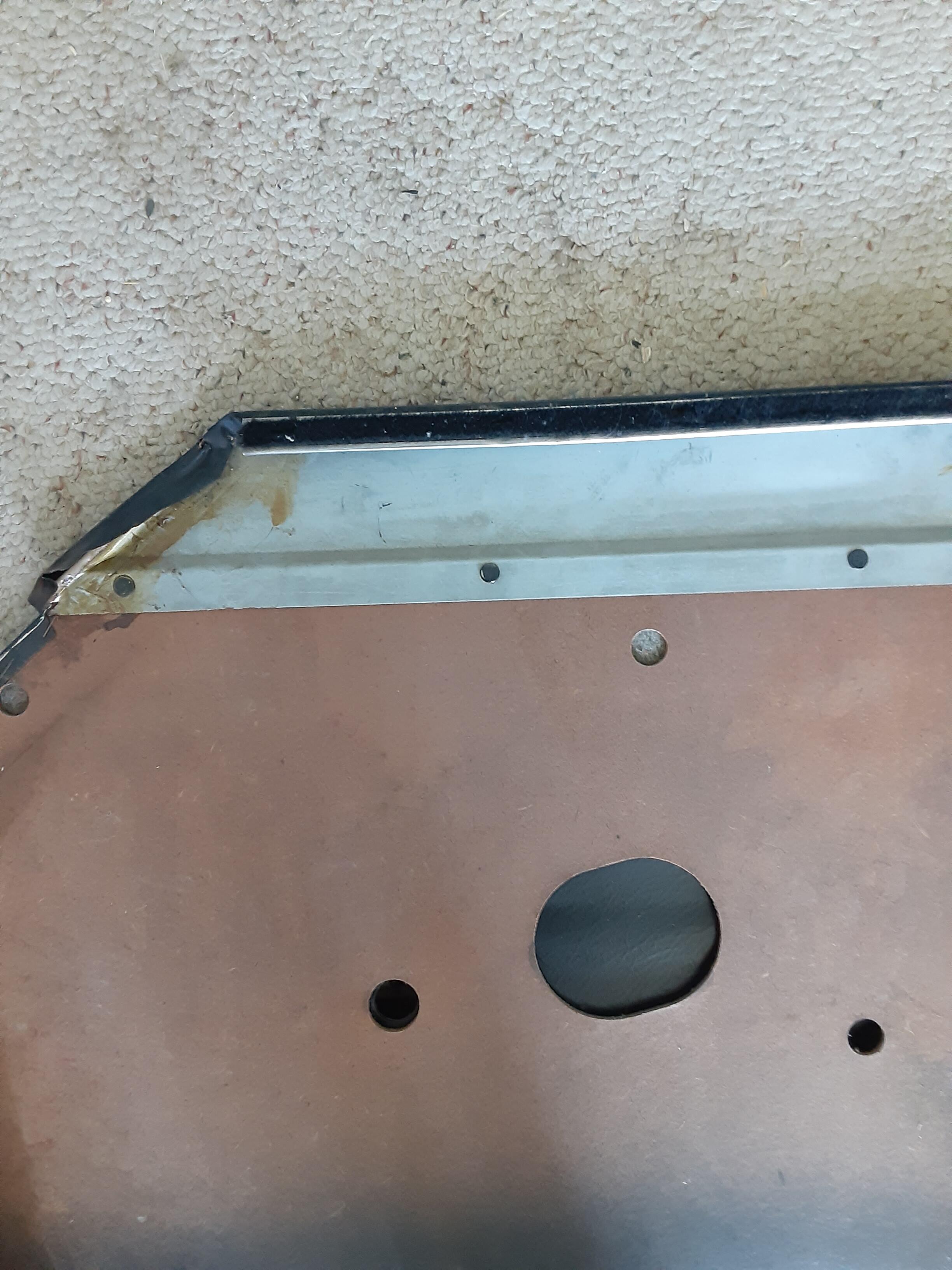

May 10, 20231 yr Author comment_653501 My OEM door card pressboard innards are in pristine condition and have absolutely no water damage at all. All the holes for the spring-like "bayonet" clips are solid. It isn't so much that I need to follow any pattern on the new vinyl as it is very lightly grained (see photo). The only significant difference will be the lack of that indentation that marks a change in texture from the outer edges to the inner portion on the OEM panel (see photo). My biggest issue is how to remove and preserve the chrome strip along the top of the panel. It looks to be riveted from the back side (photo). Making it even more interesting, the right-side panel rivets are different from the left-side panel rivets. Has anyone ever removed and reinstalled this piece? Link to comment https://www.classiczcars.com/forums/topic/68331-total-internal-reupholstery/#findComment-653501 Share on other sites More sharing options...

May 10, 20231 yr Author comment_653507 I was thinking of using a Dremel to cut away the flanges on the rivets and leave posts that I could later thread to accept nuts upon reassembly. Link to comment https://www.classiczcars.com/forums/topic/68331-total-internal-reupholstery/#findComment-653507 Share on other sites More sharing options...
May 11, 20231 yr comment_653512 I believe the chrome strip molded to the vinyl on the panel. I don't believe it will come loose with the rivets Maybe Cantech can verify. Link to comment https://www.classiczcars.com/forums/topic/68331-total-internal-reupholstery/#findComment-653512 Share on other sites More sharing options...
May 11, 20231 yr Author comment_653514 Well, if it's "glued" on that almost makes things easier, wouldn't you think? Link to comment https://www.classiczcars.com/forums/topic/68331-total-internal-reupholstery/#findComment-653514 Share on other sites More sharing options...
May 11, 20231 yr comment_653526 I think its heat welded. It may make it difficult to maintain a crisp edge when removing the chrome trim. It is also easy to make the chrome peel Link to comment https://www.classiczcars.com/forums/topic/68331-total-internal-reupholstery/#findComment-653526 Share on other sites More sharing options...
May 11, 20231 yr Author comment_653527 OK, in that case, if the chrome strip cannot be removed without its disfigurement or destruction, I might just buy two pieces of 3/16" x 3/16" x 36" 304 stainless bar stock from Grainger, cut them to length, radius two adjacent edges, polish them up and glue them in place. I'd use half-round but I can't find any that small. I might even be able to drill and tap the backside of those bars to accept jewelers screws coming through the metal plate. Sure, SS isn't chrome but because I'm going "custom" that won't make a difference. Link to comment https://www.classiczcars.com/forums/topic/68331-total-internal-reupholstery/#findComment-653527 Share on other sites More sharing options...
