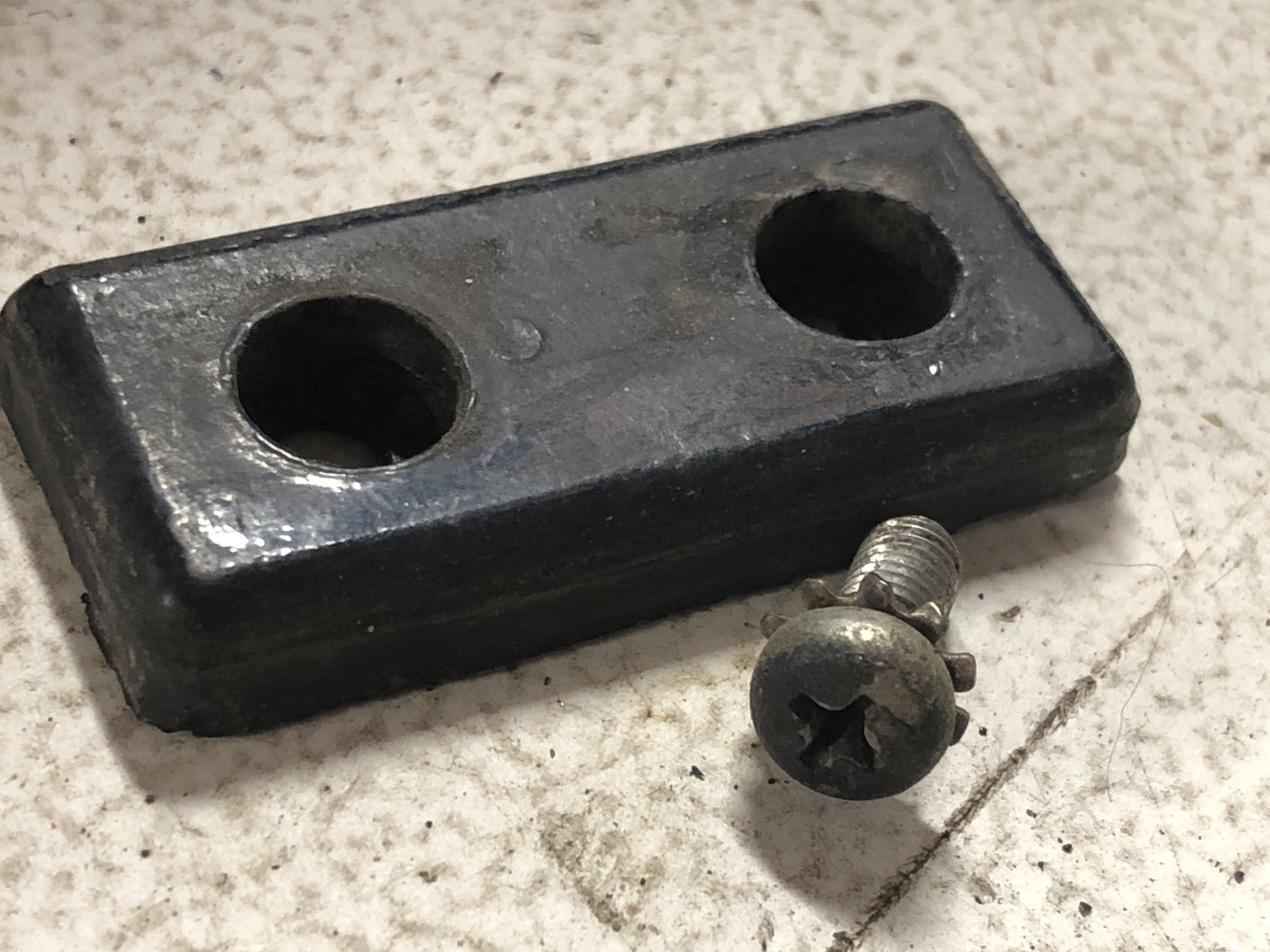

yes, those are the ones!  they were no longer available at msa.  they did not know the thread size after I ordered the new bumper stops yesterday. thanks for the help.
  On 5/17/2023 at 3:00 PM, zKars said:
the screw is M5x0.8 thread, round pan head, phillips, star washer, 10 or 12mm long.
Nope... not a phillips.. it's a JIS headscrew, many screws get damaged by working with a phillips head screwdriver! It's JIS! google for some perfect fitting screwdriver.
Lots of screws in a s30 are JIS.
yes, I do know that most screws are jis but I do not have any screws that will match.  I was looking for the thread size so I can purchase some from the hardware store. these screws are no longer produce from Nissan. thanks
