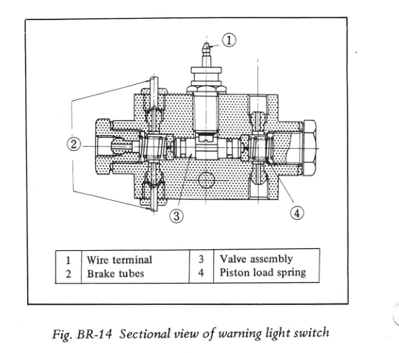

May 24, 20231 yr comment_653848 49 minutes ago, 240z70 said: ANOTHER QUESTION: The brake indicator light is always on on the tac. I have not been able to shut it off. I checked the handbrake switch and it works, and there is no wire connected to the distribution block on the firewall. That is the only two connections that the light is supposed to have... Ideas? The two switches just complete the path to ground for the light. The wire that goes to the warning light switch is probably shorted to ground somewhere. You'll have to find it. It's not a distribution block, it's just a switch. Link to comment https://www.classiczcars.com/forums/topic/68344-booster-mc-compatibility/?&page=2#findComment-653848 Share on other sites More sharing options...
