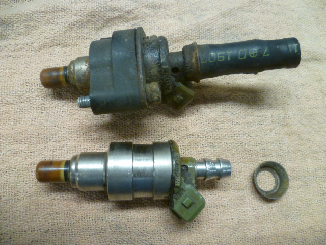

Here's a pic of injectors with and without the hose. I used the old standby method to get that hose off (in pieces), and I'm looking for a better option. Before and after the cutting/slicing approach to hose removal:

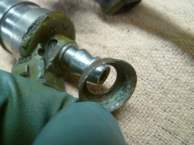

If I destroy these ferrules, are replacements available? Note that you can see some scratching on the hose barbs from the removal process:

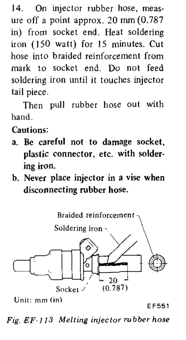

Answer to question not asked - I had a vague memory and found its source.  It's in the FSM Engine Fuel chapter.  One of those old wood-burning tools would work too, I'd guess.

Zed Head, Thanks!  I don't remember ever seeing that soldering iron technique in the FSM. I had always remembered the recommendation to grind the ferrule off and then peel the remaining rubber. Interesting thing is... The 75 manual recommends a grinder, but after that (76 an later) recommends the soldering iron. It's not like I spent a lot of time pouring over the 75 manual, but I couldn't find any other mention of doing it that way.
Anyway I'll give that a try, and if that doesn't work, I'll try burning it like it floats.  LOL   Thanks!

Well for me, the "old standby" method is using a razor knife to cut a slit into the rubber hose allowing it to be pulled off the barbs. That and a lot of swearing. The swearing is especially important when you get down to the bottom and are digging around inside the ferrule with the tip of the razor knife. But the problem with that old standby method is that no matter how much swearing is employed and despite how careful you are (I am?) with the razor, you always cut a little too deep and put cut lines into the barbs of the injectors.

As for the purpose of the ferrule? I'm thinking it's primarily there to prevent the tubing from being inserted too far onto the barb. It might also provide some support to the end of the tubing to prevent fraying and cracking over the years, but mostly for insertion depth. And as for how to get new tubing on? The service manual says to just put a little gasoline into the end of the new tube (as lubrication) and push it on. No clamp required.
So I will try the soldering iron method for removal. Since the reinforcing threads inside the tubing are polyester, it makes a lot of sense. I have high hopes.
