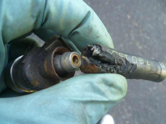

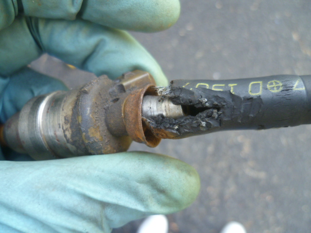

I don't think that material quality was very good back in the early days of fuel injection.  Nissan had a team of engineers create a document about changing hoses.  So, it was probably a thing back then.
