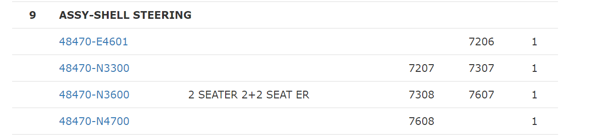

There are three distinct styles, 240, 260/280 to sometime in 76, then another in 77-78. The 280’s are different in the right side light/wiper stalk location, it is canted up 15-20 degrees on the 74 260 and onward, so the hole in the shroud is moved up, well the two halves of the hole, so the top hole is larger and bottom hole is smaller. The late 280 shroud is bigger and wider overall.
