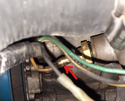

The sender for the water temp on my cars have a bullet connector. Anyway, the crimp on that female bullet connector can be subject to wear from the wires moving from the engine vibrations.

What Steve said, and - In both cases the connectors at the sensors are very often the problem. Neither are weather tight and although you don't drive in the rain - and Arizona - oxidation does happen. Sometimes wiggling the two connectors on the fuel level sender helps, sometimes they need to be taken off and cleaned. The posts on the fuel level sender too. You can never be absolutely sure but the connectors under the dash are far better protected than at the sensors so I always start there (sensors) and work toward the gauges checking the wiring.
Since your trouble is intermittent, I'd suspect the sensor connectors and/or associated wiring. It's more unlikely but certainly possible: Frayed insulator on wire, to-dash-harness connector, gauge connector, or inside the gauge itself.

The connector looked perfectly well connected - but I took it off and there was:
1) corrosion inside to clean out
2) play - It needed a little reshaping so that it held on more tightly.
Never a problem with it since.

To echo other commenters, grounds are often overlooked in cases like this, and also, the round slip on connectors at the sending units do get loose over time.
Seeing as the gauges share a common ground, it would be the first place to look. Clean to bare shiny metal, and use dielectric grease when reinstalling to prevent further degradation over time.
