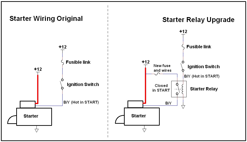

June 6, 20231 yr comment_654139 Oh, and adding a starter relay is a great idea regardless of the issue are having. I've seen burned up contacts inside the ignition switch caused by the solenoid current (which can be upwards of 8A or so IIRC). Link to comment https://www.classiczcars.com/forums/topic/68365-75-280z-starter-motor-intermittently-clicks-when-restarting-after-car-has-been-driven-for-several-milesin-town-driving/?&page=2#findComment-654139 Share on other sites More sharing options...
June 6, 20231 yr Author comment_654140 2 hours ago, Captain Obvious said: Oh, and adding a starter relay is a great idea regardless of the issue are having. I've seen burned up contacts inside the ignition switch caused by the solenoid current (which can be upwards of 8A or so IIRC). Thanks for the schematic - I was wondering if the starter solenoid trigger came through a fusible link - I couldn't ascertain that from the manual. I'm wondering if the link is contributing - one common denominator is that I typically dislodge the links/cover when I'm leaning over to check this stuff. I was wondering if I'm loosing current via the link under load. The green one does feel pretty warm to the touch. I was going to remove these & run the circuits via the fuses on the fused battery supply I added Edited June 6, 20231 yr by HusseinHolland Link to comment https://www.classiczcars.com/forums/topic/68365-75-280z-starter-motor-intermittently-clicks-when-restarting-after-car-has-been-driven-for-several-milesin-town-driving/?&page=2#findComment-654140 Share on other sites More sharing options...
