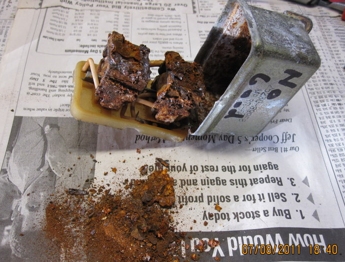

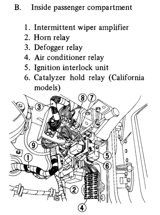

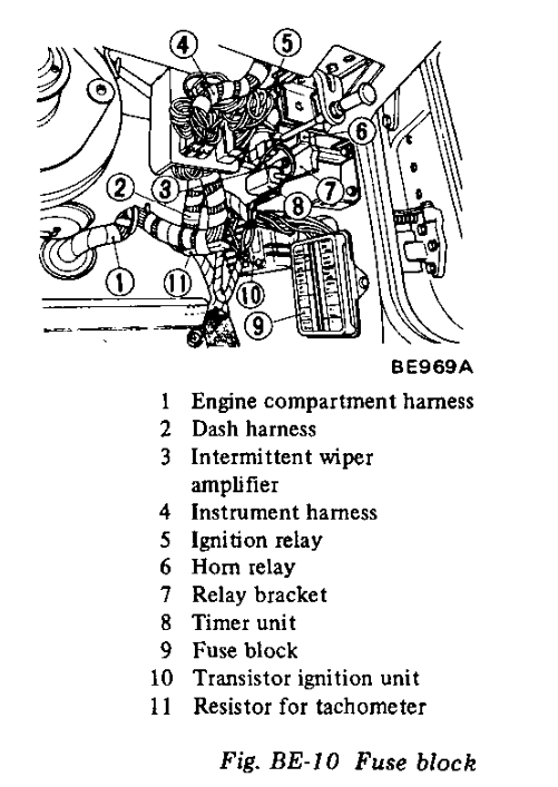

June 7, 20231 yr comment_654171 Nissan put the relays in an area that gets wet if the windshield leaks. If a crusty relay is causing excessive draw the extra bypass relay might just be delaying another problem. They're by the fusebox. I don't know if Nissan just changed names or did not use a standard ignition relay in 75. The 1976 BE chapter shows one but 75 only shows an "igntion interlock relay". They don't include the small diagrams either. 75 is one of the difficult years. This is the 75 drawing -  Here's 1976, where that rusty picture above came from -  Link to comment https://www.classiczcars.com/forums/topic/68365-75-280z-starter-motor-intermittently-clicks-when-restarting-after-car-has-been-driven-for-several-milesin-town-driving/?&page=4#findComment-654171 Share on other sites More sharing options...

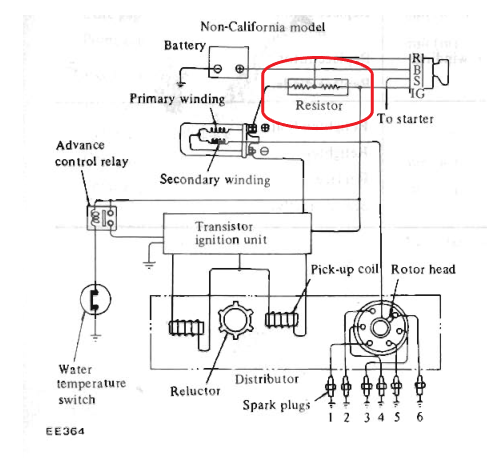

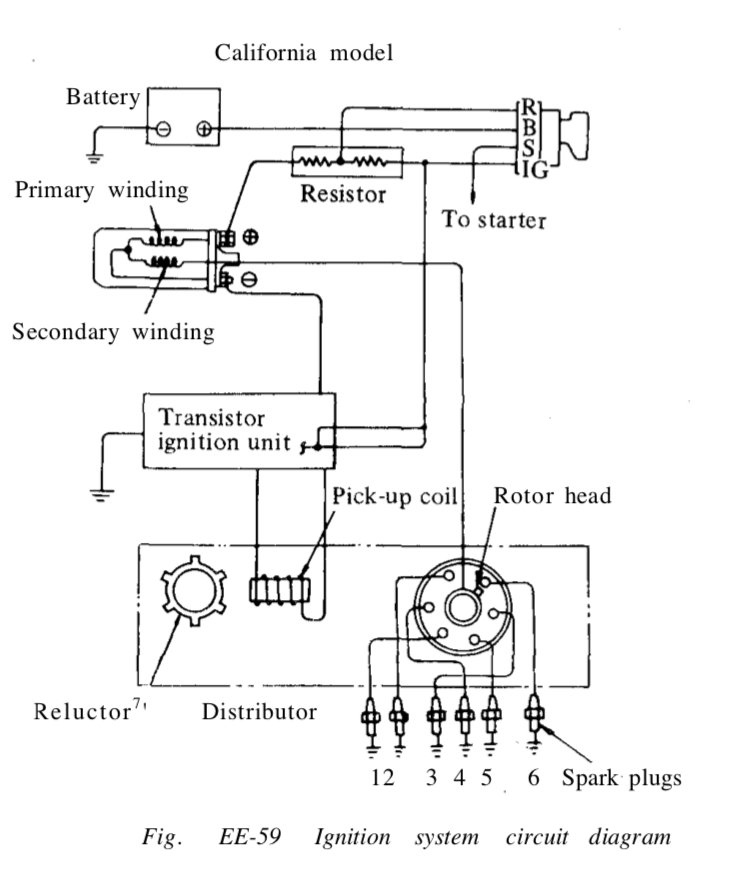

June 7, 20231 yr comment_654172 I missed the part above where you already installed the relay. Oh well. Don't overlook this part. Part of it is only in use at Start.  Link to comment https://www.classiczcars.com/forums/topic/68365-75-280z-starter-motor-intermittently-clicks-when-restarting-after-car-has-been-driven-for-several-milesin-town-driving/?&page=4#findComment-654172 Share on other sites More sharing options...
June 8, 20231 yr Author comment_654179 8 hours ago, Zed Head said: I missed the part above where you already installed the relay. Oh well. Don't overlook this part. Part of it is only in use at Start.  Unless I'm mistaken, that resistor's only purpose is to drop the voltage to the ignition coil. Mine is wired slightly differently further down the road, but the resistor itself is the same for CA versions.  I'll check the relays & panel. There is no evidence of any water ingress on the passenger side, I have all the carpeting out. Also, the car was never driven or left in the rain for the first 46 years of its life.  One of the reasons he never bothered to fix the wiper pivot when it seized 30+ years ago. He did say it saw a little snow when he used to ski, but that was also in the first 15 years of its existence. Edited June 8, 20231 yr by HusseinHolland Link to comment https://www.classiczcars.com/forums/topic/68365-75-280z-starter-motor-intermittently-clicks-when-restarting-after-car-has-been-driven-for-several-milesin-town-driving/?&page=4#findComment-654179 Share on other sites More sharing options...
June 8, 20231 yr comment_654180 The premise of the added relay is that something along the circuit to the starter solenoid is drawing so much current that the solenoid can not actuate. The circuit has worked just fine for over 40 years I'd guess. Something is different now. The wire from R to the resistor bypass circuit is one of the few things that are different during Start. You have a "key at Start" voltage drop problem. Just offering troubleshooting paths to check. As far as the relays, there are several pictures on the forum of burnt/baked relay coils. They just get old and crusty with time. It's not just water that causes problems. How has it been starting with the new relay? Link to comment https://www.classiczcars.com/forums/topic/68365-75-280z-starter-motor-intermittently-clicks-when-restarting-after-car-has-been-driven-for-several-milesin-town-driving/?&page=4#findComment-654180 Share on other sites More sharing options...

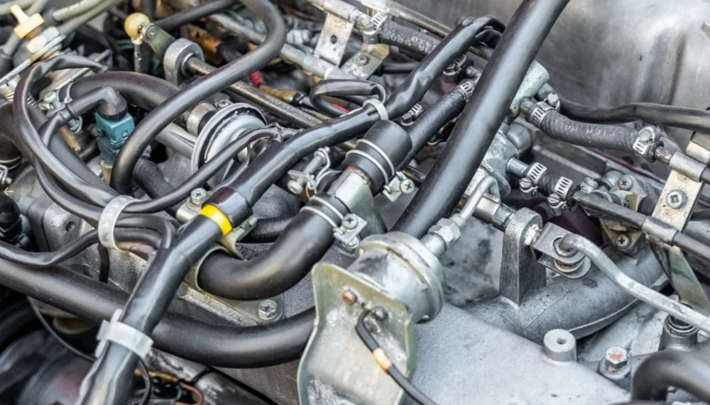

June 8, 20231 yr comment_654194 On a 76 one would be right around where the yellow is in this picture. An eyelet with a screw through it in to the manifold. The ground wire is in that harness. The alternator also has a dedicated ground wire which would provide grounding through the mounting points, assuming contact was good. Poking around with a meter is always fun. You could also use a headlight bulb to pull some amps through the various ground points. I like to measure things, but, adding a redundant ground wire won't hurt anything if you don't trust your measurements. https://bringatrailer.com/listing/1975-datsun-280z-45/ Link to comment https://www.classiczcars.com/forums/topic/68365-75-280z-starter-motor-intermittently-clicks-when-restarting-after-car-has-been-driven-for-several-milesin-town-driving/?&page=4#findComment-654194 Share on other sites More sharing options...
