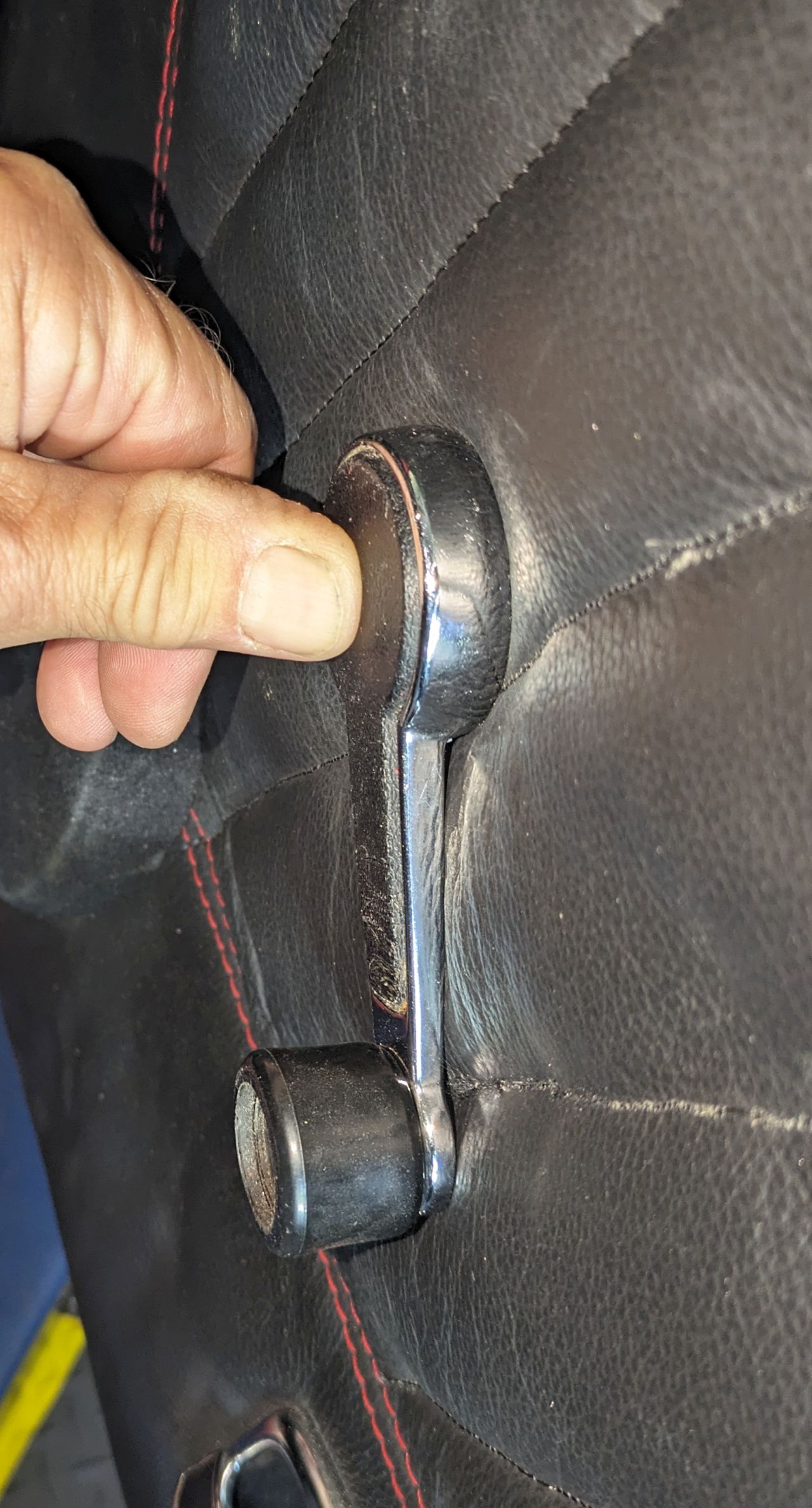

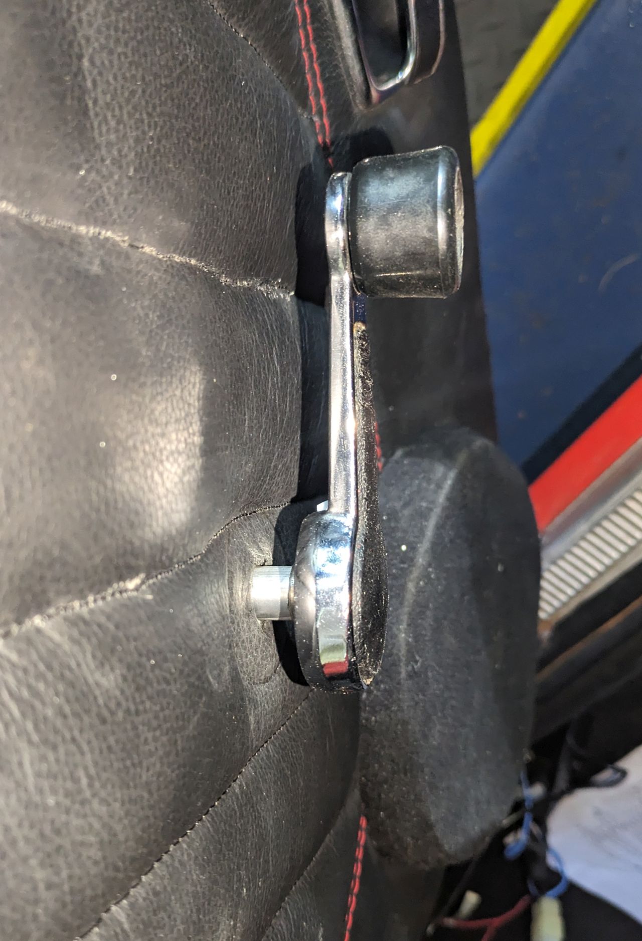

I noticed a comment from the aftermarket part manufacture that they could not make them any shorter and I understand the reason for that statement after I figured out how to make them. I only needed to extend the shaft a short distance to clear the padded leather covered door panel. Even after I modified the aftermarket design to shorten the length, the crank handle extended too far from the panel.

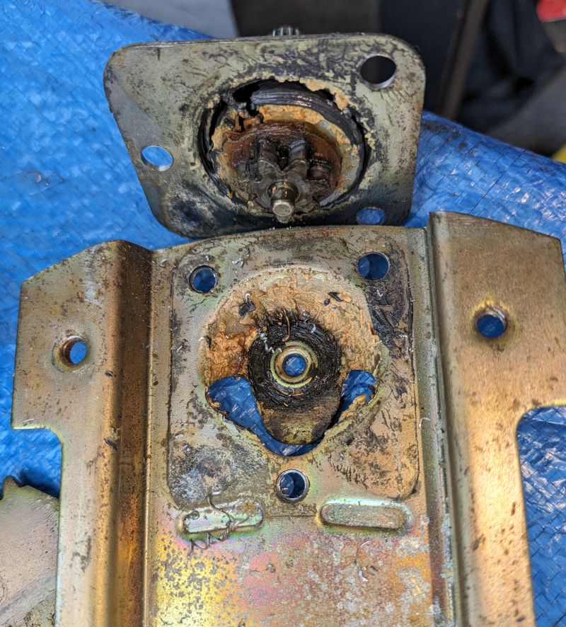

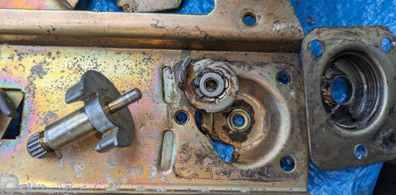

Well, I had nothing better to do so I took it apart to see what's inside. I used to do that a lot when I was a kid. I figure I can reassemble it with some nuts and bolts or a spot welder I hope I still have access to.

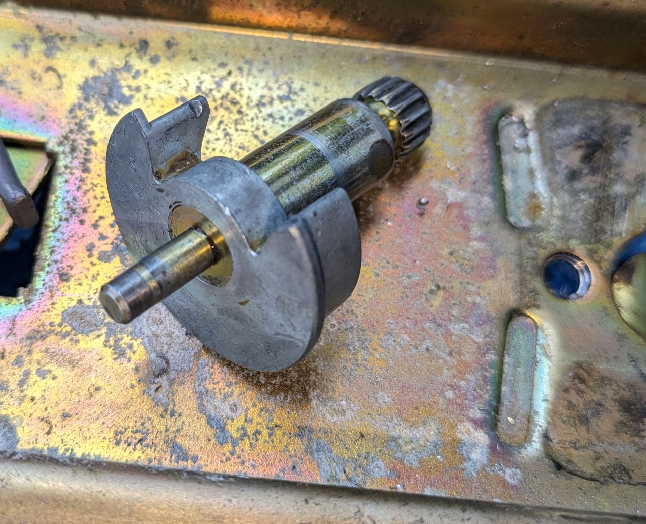

It looks like the spline shaft is press-fit to an aluminum collar that mates to a spring. My options now look like the following (assuming I can put this back together):
1) Cut the shaft and extend it by adding a little steel by welding the two parts
2) Attach a short hollow tube between the two parts that can be welded or fixed with set screws. The added diameter would not be a problem.
3) Extract the shaft from the aluminum collar and turn a new shaft.
The easiest might be #2 and the most elegant would be #3. Separating the shaft from the collar would be my primary concern.
Feel free to offer input. I'll try and get this to the makerspace in the next couple of days to see what's suggested.
My concern would also be getting the shaft out of the aluminum. Going to be hard to use any force without breaking the aluminum. I think I would just cut the shaft and add metal in between the halves with the welder. That seems like the path of least resistance to me. Probably quickest too.
