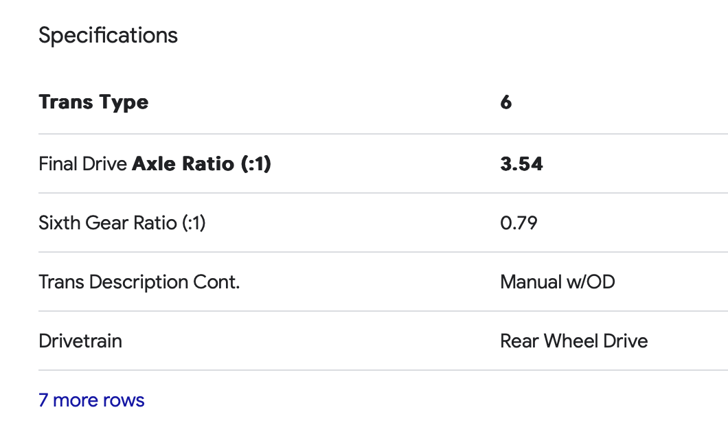

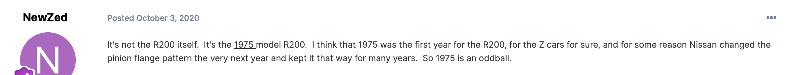

June 5, 2024Jun 5 Author comment_666205 Putting this here before I forget (again) Both cars have the 3.54 FD ratio. another tidbit from NewZed - 75 280 R200 has different flange than later years Link to comment https://www.classiczcars.com/forums/topic/68390-75-280z-preparing-for-06-350z-6-speed-drivetrain-conversion/?&page=2#findComment-666205 Share on other sites More sharing options...
