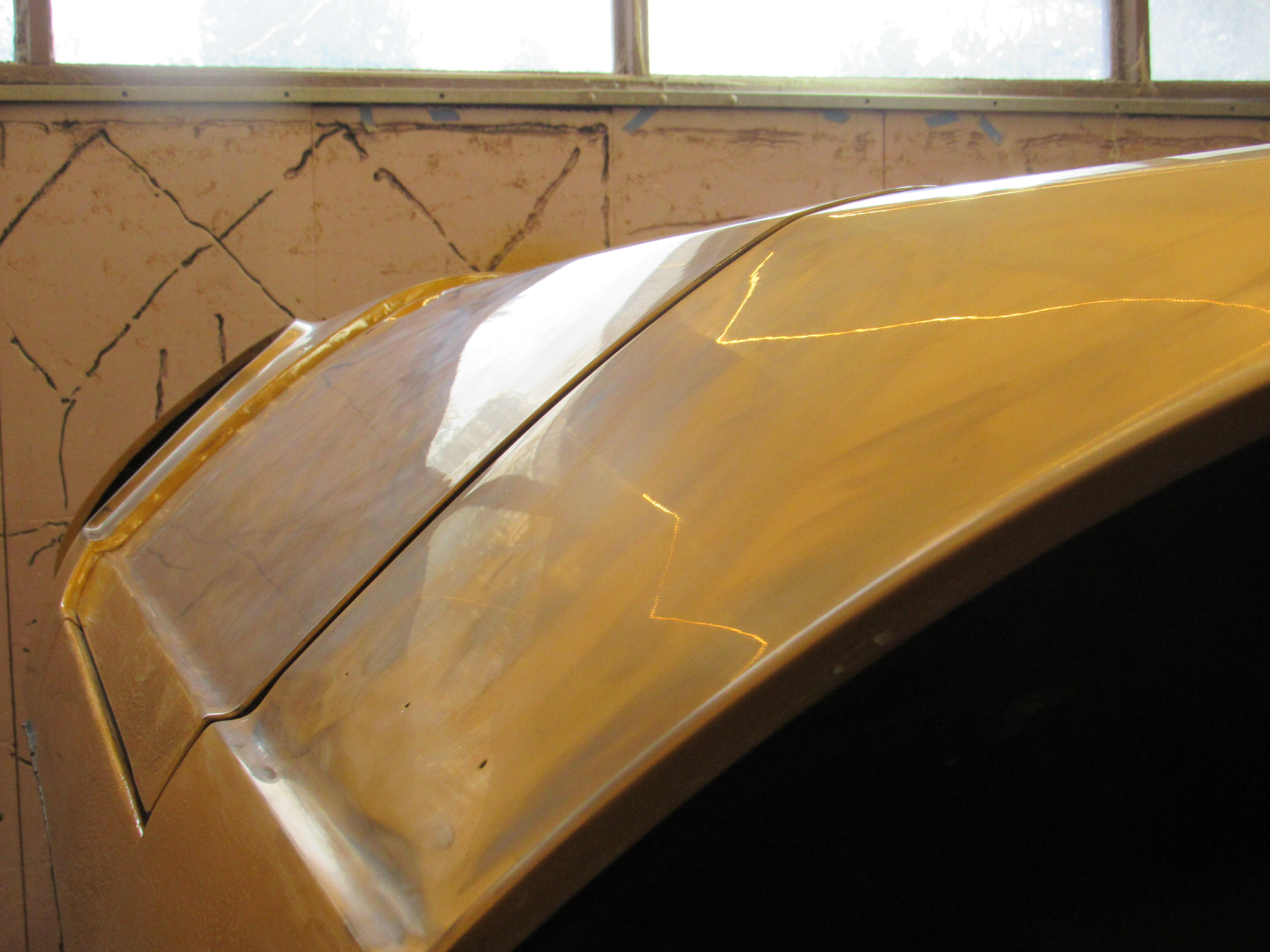

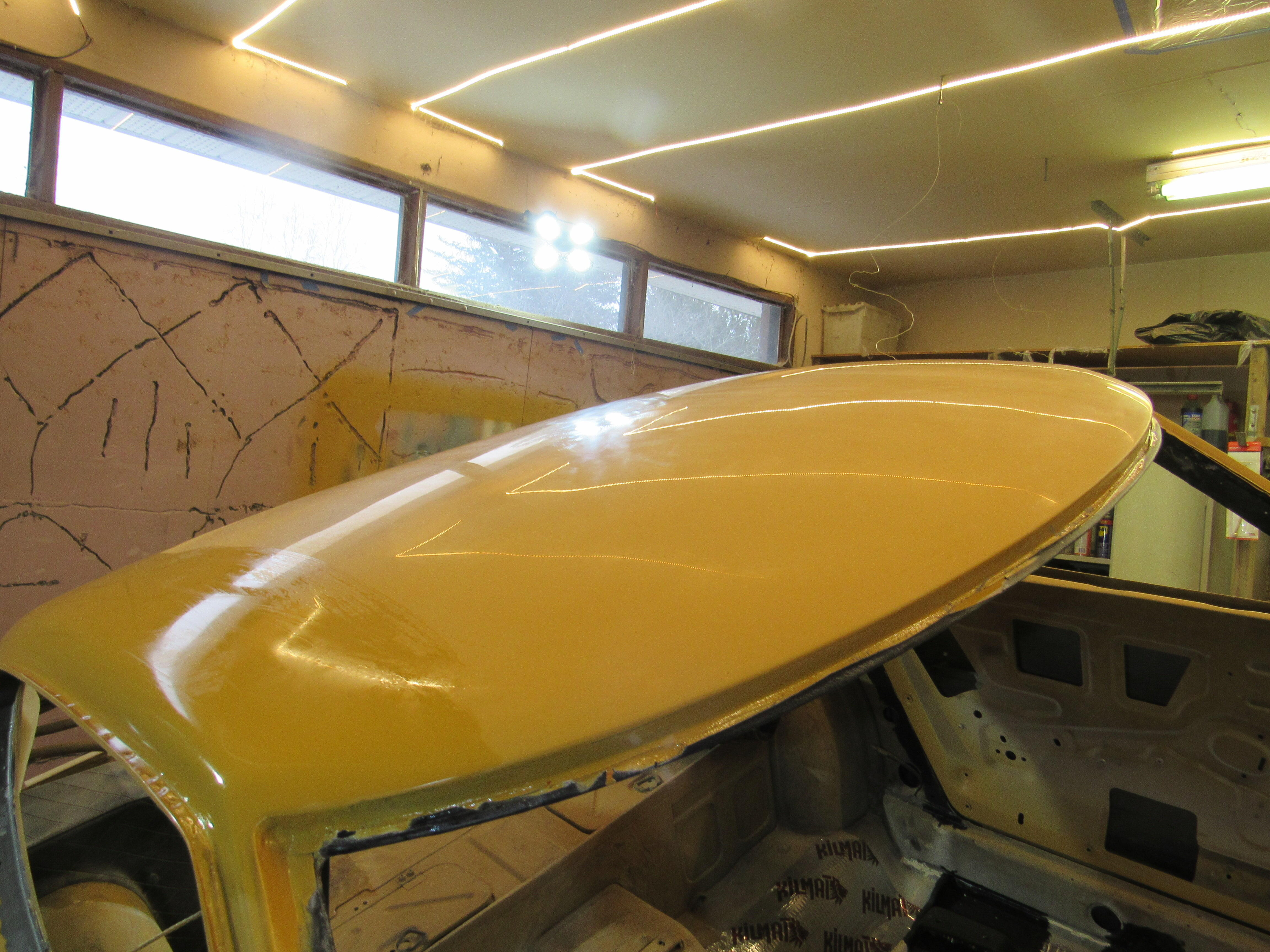

February 5, 20241 yr Author comment_661724 Completed 1500 grit yesterday, finished 2000 today and I'm all set up to start the final 2500 grit tomorrow morning, do a super clean up and with any luck I'll be buffing by Wednesday. These are pits that should have been sanded out with 1200 but some how got past me, I didn't notice them until I was into 1500. This is 2000, the shine is getting there. Even with guide coat it looks pretty good. Link to comment https://www.classiczcars.com/forums/topic/68400-dave-w-1971240z-rebuild/?&page=16#findComment-661724 Share on other sites More sharing options...

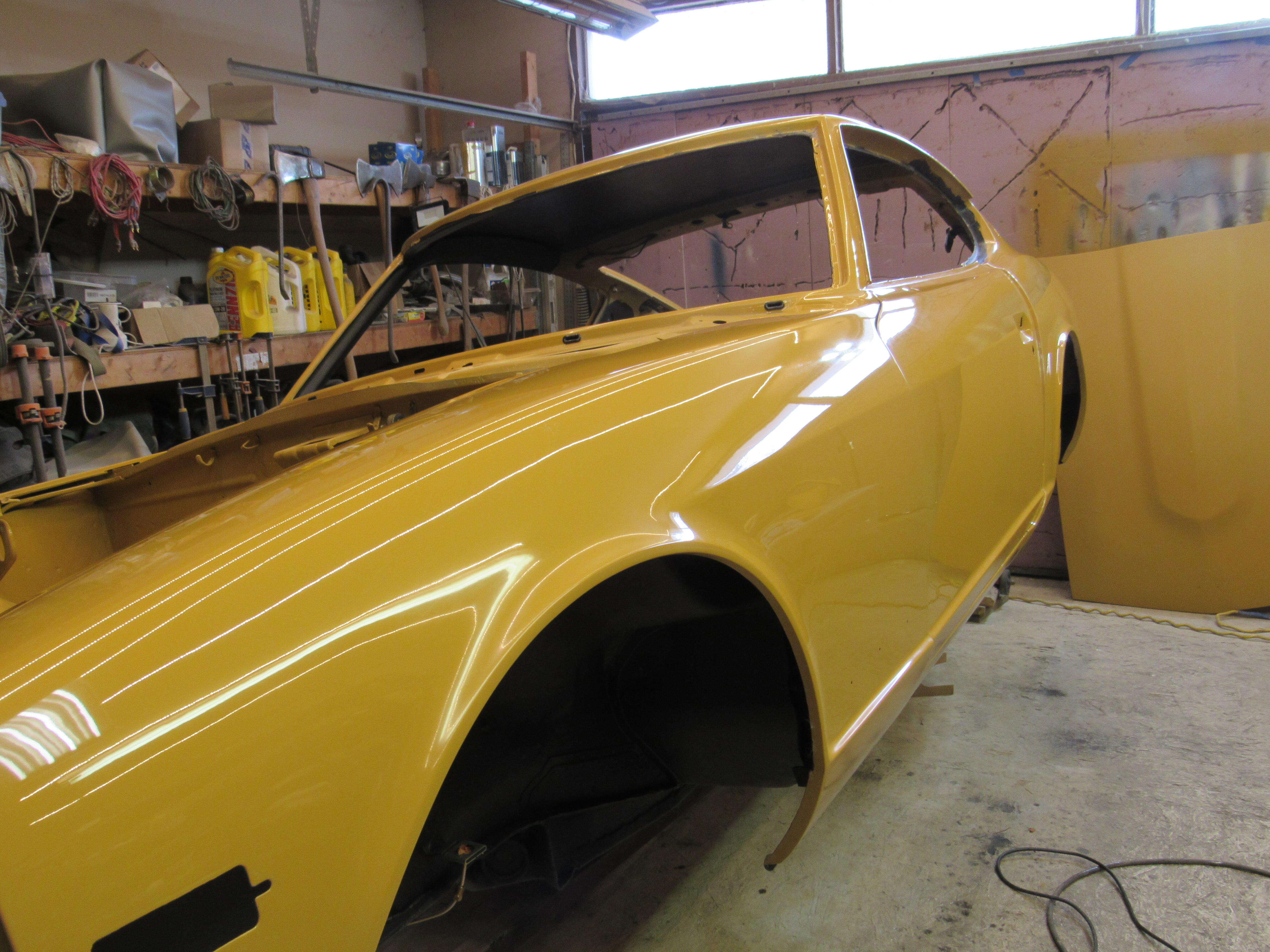

February 7, 20241 yr Author Popular Post comment_661826 I got the D/S, roof, hatch and all the smaller pieces done today, just have the P/S and hood to go. Link to comment https://www.classiczcars.com/forums/topic/68400-dave-w-1971240z-rebuild/?&page=16#findComment-661826 Share on other sites More sharing options...

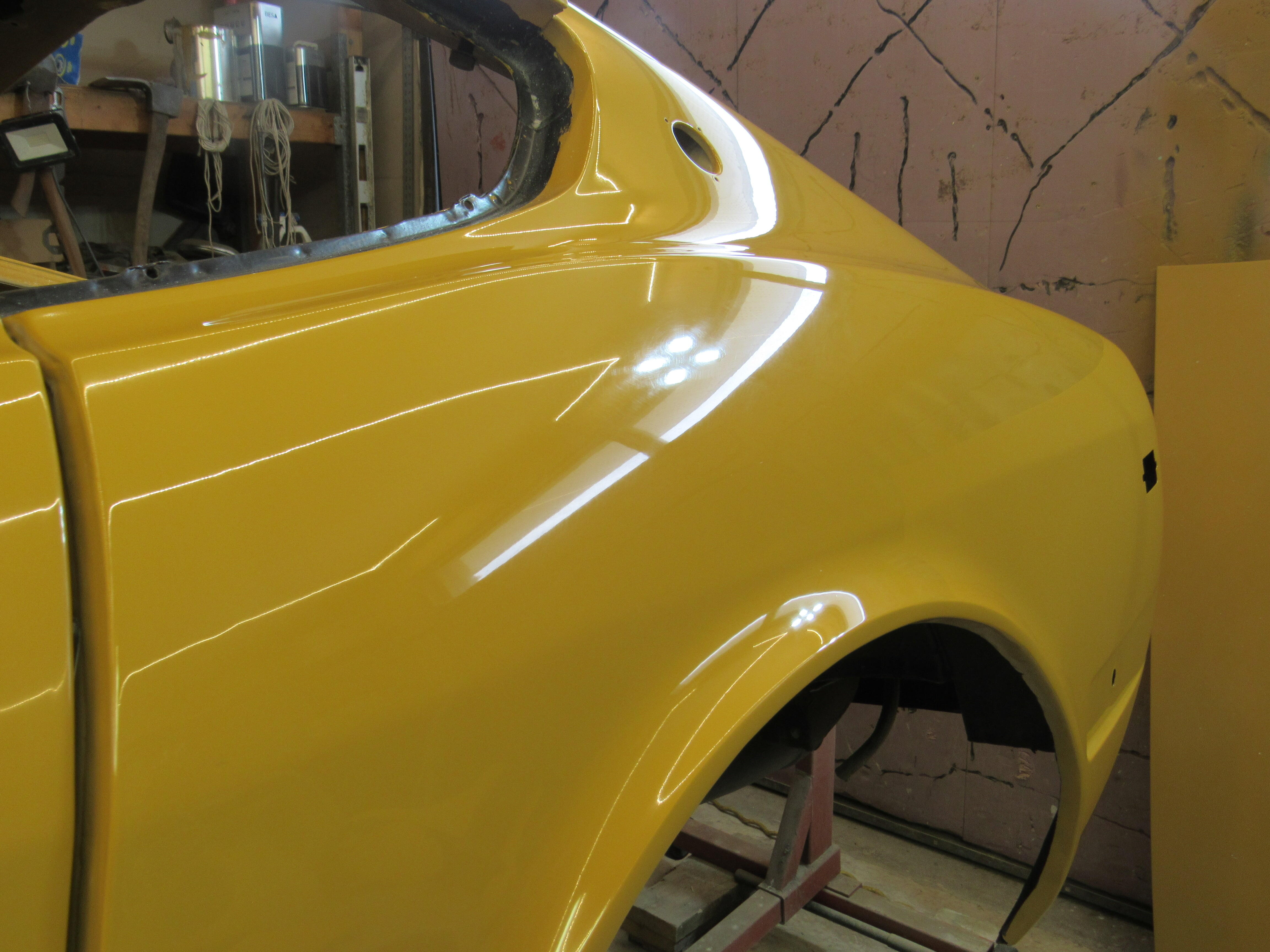

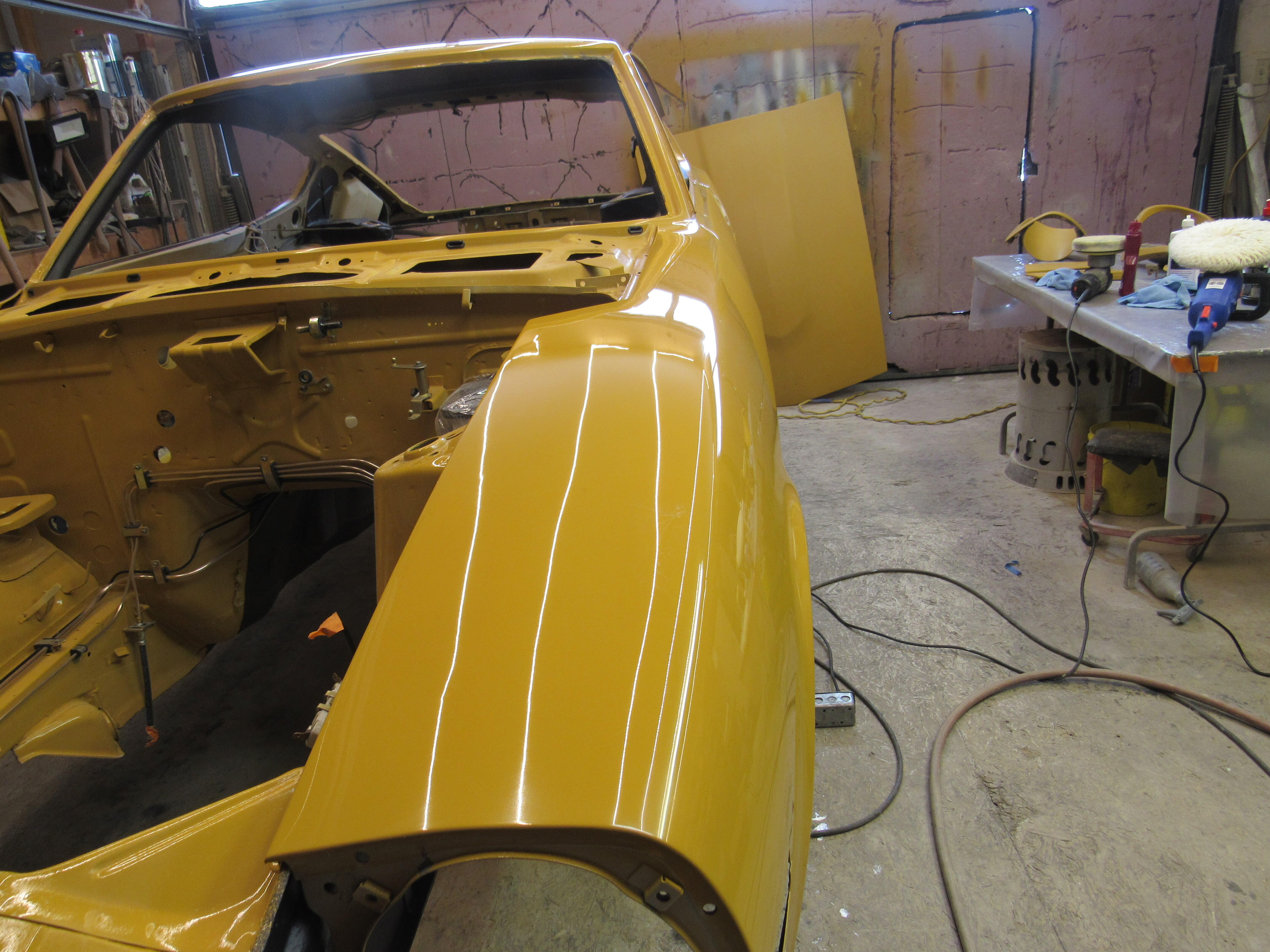

February 8, 20241 yr Author Popular Post comment_661856 I think I am pretty much done, some how managed to screw up the other sugar scoop so have to re paint that as well, but other than that the buffing and polishing is done. Now this is by by no means a professional buff job, there still some spider webs that I can't get rid of, so Dave I recommend you find a good buff guy to give it that last little bit of correction. I have never been able to get spider webs out and I don't want to try something more aggressive on someone else's car. It is amazing what a guy who does buffing for living can pull out. I got the car off the rotisserie and back onto jack stands, I think I will take tomorrow off, give my shoulder a break. Link to comment https://www.classiczcars.com/forums/topic/68400-dave-w-1971240z-rebuild/?&page=16#findComment-661856 Share on other sites More sharing options...

February 9, 20241 yr comment_661886 What do you mean by spider webs? Light scratching, sanding marks? Link to comment https://www.classiczcars.com/forums/topic/68400-dave-w-1971240z-rebuild/?&page=16#findComment-661886 Share on other sites More sharing options...
February 9, 20241 yr Author comment_661889 6 hours ago, Patcon said: What do you mean by spider webs? Light scratching, sanding marks? I have tried a few things but I can never get that clear glass look, they're only a few microns deep and they are all on the surface of the clear coat. Just haven't found the technique yet. Link to comment https://www.classiczcars.com/forums/topic/68400-dave-w-1971240z-rebuild/?&page=16#findComment-661889 Share on other sites More sharing options...
