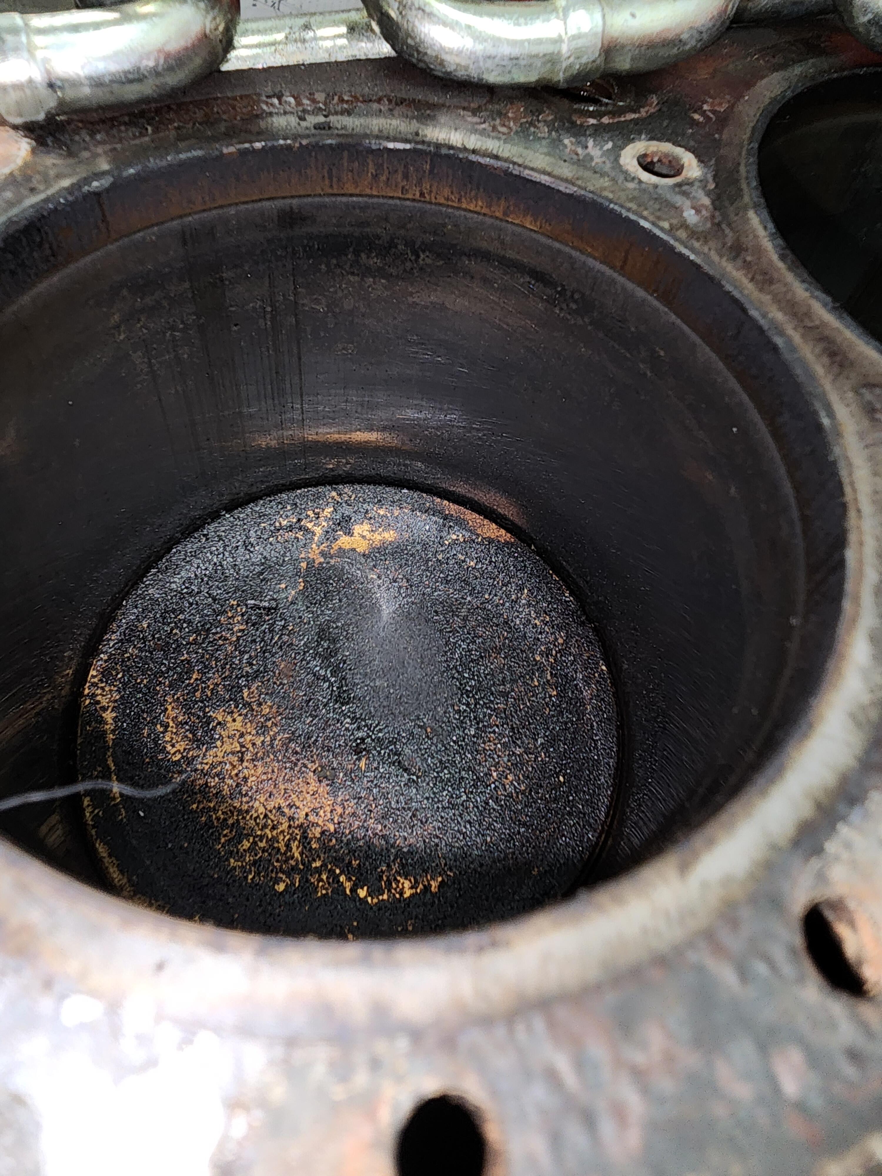

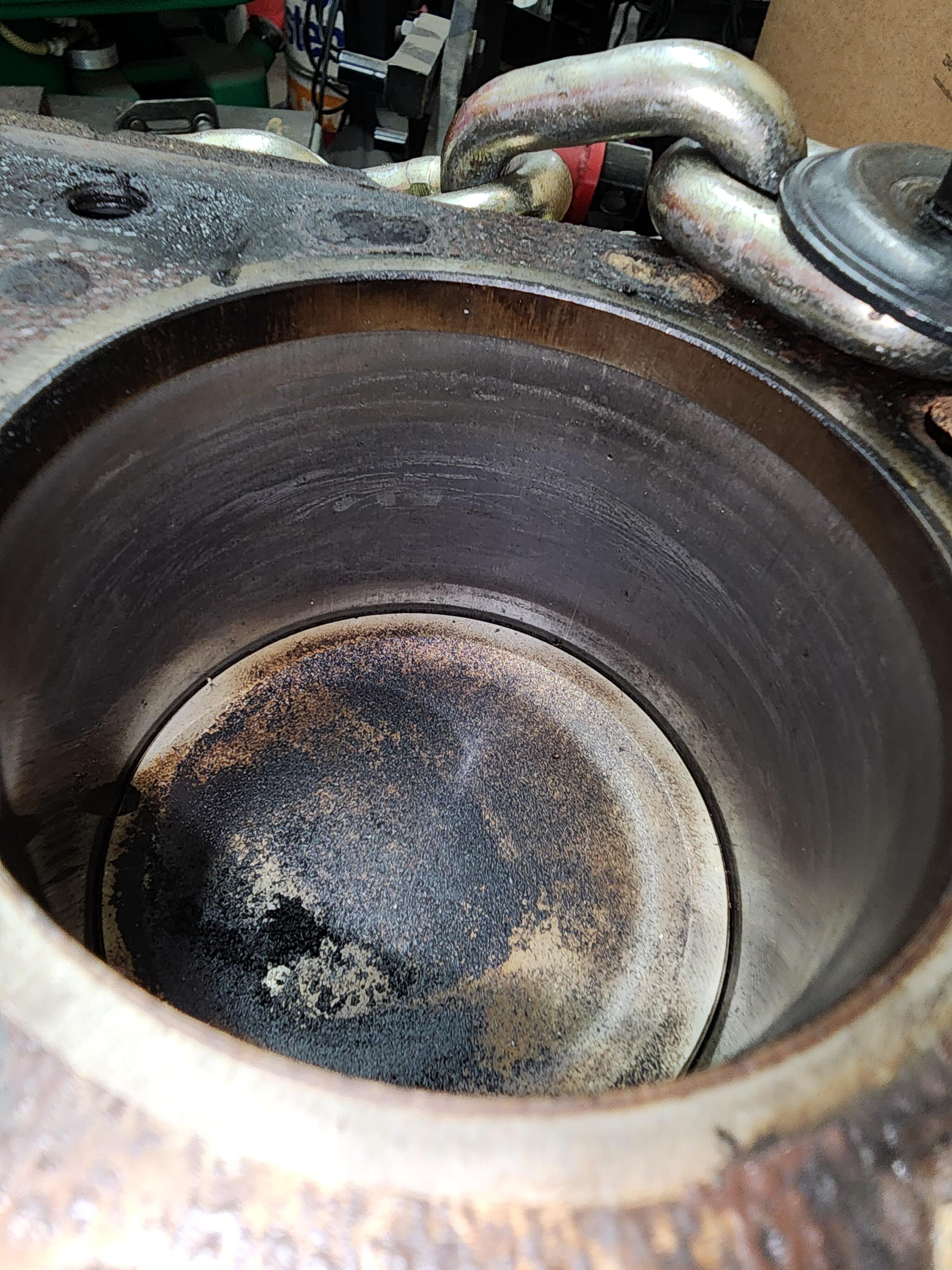

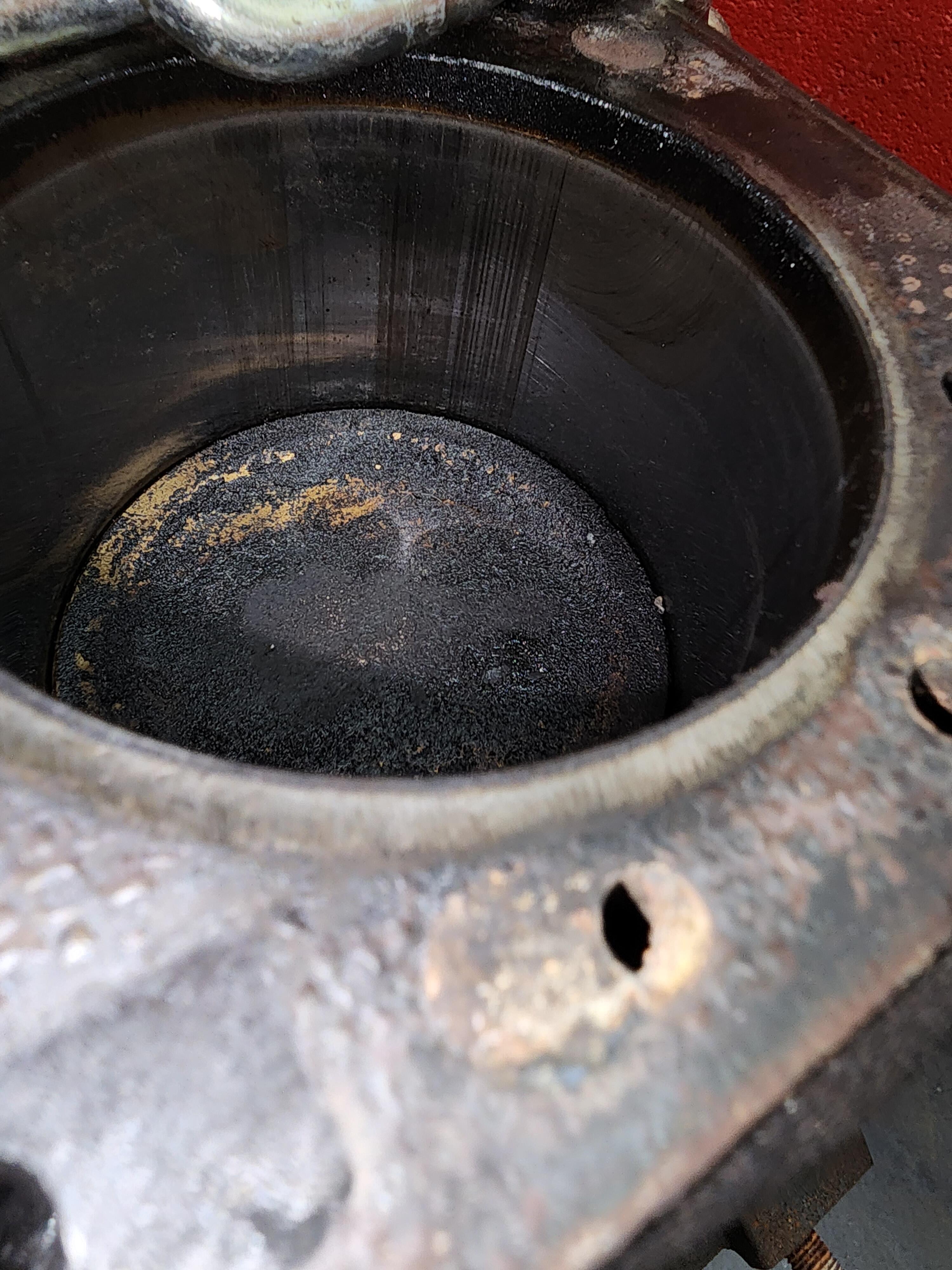

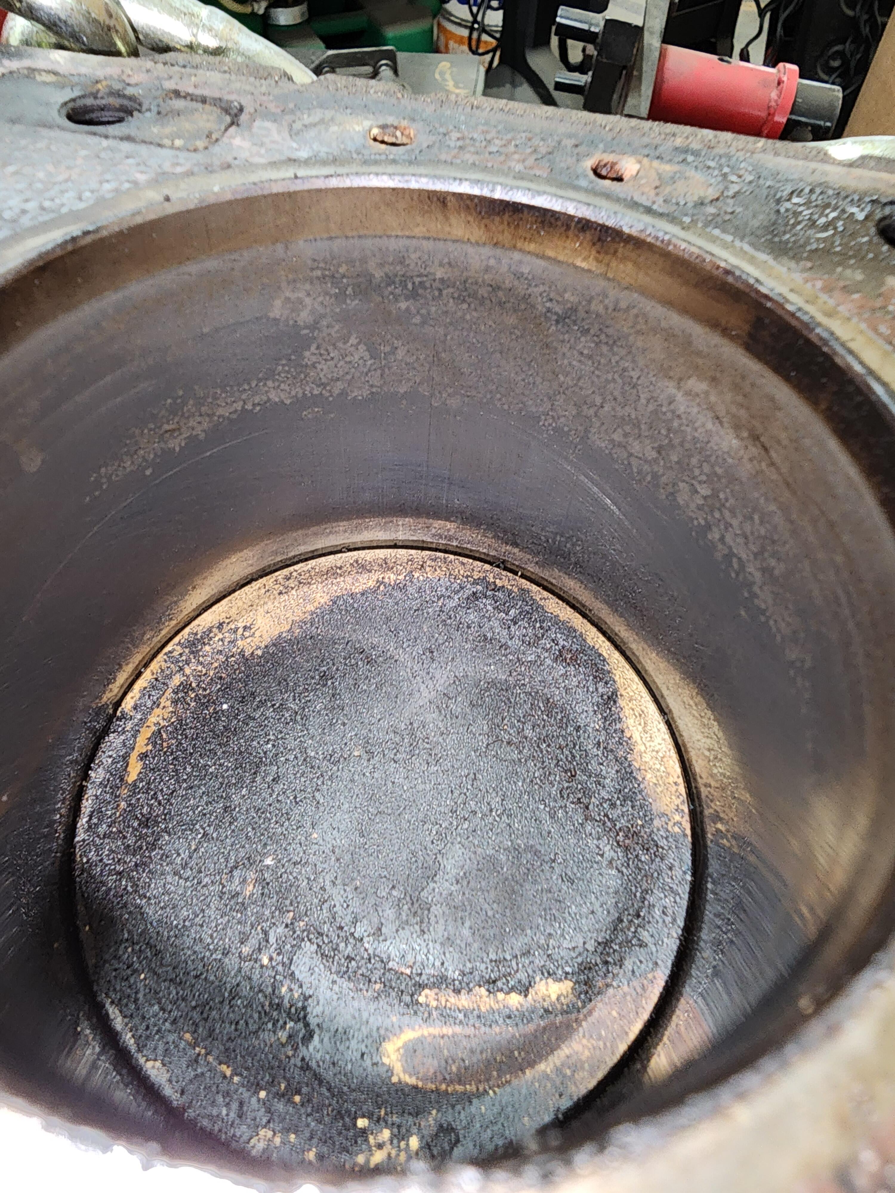

Posted June 23, 20231 yr comment_654427 Hey guys, I have an L28 Engine, N42 block and N47 head. My goal was to rebuild the engine and make it a reliable engine that can last a long time. I want to avoid having to pull the engine anytime soon. Power is not my biggest concern however I would like to be above the stock power numbers minimum with this rebuild since it's going to gain a little weight with aftermarket AC. For the most part I will be sticking to the stock efi for smog reasons and would like whatever I do internally to not mess with my ability to pass smog. I have almost all refurbished or new parts for the intake manifold too which should be a big help. The condition of the block is the cylinder walls are polished, slightly glazed but overall look good with no major signs of scoring or anything. I got a couple of quotes from three machine shops in my area and not a single shop wants to do just a hone job. One shop quoted me $3500 because he wants to put all new parts in it and grind the crank (Which is insane if you ask me for a stock rebuild and does not sound necessary), the other shops quoted me closer to $600 with no parts. Every single shop wants to bore the block which means I need new pistons at 87mm (I think because of how old the car is or they trying to get more money out of me?). As most of you know, pistons are hard to come by for these cars especially domed pistons which I need because flattops will put me at a CR of 10.2 according to OZdat which is too high for California 91 and sounds too high for stock efi. The only 87mm domed pistons I see are forged (overkill) and will cost me more than $1500 (overkill). My question is can I just ball hone the cylinder walls myself (or one of my co workers with experience honing) and be okay or keep trying to find a shop that will do just a hone and not worry or is a Bore absolutely necessary? Also if possible can anyone chime in and let me know how the stock efi system will react to 9.1 compression ratio? Thinking of potentially decking the block just to raise it if it'll even be worth it? The N47 head has one exhaust liner missing and decided to just leave it as is since someone had one missing and didn't notice a performance decrease with it and without it. I didn't plan on doing anything to the head but I would like to ask would I see any benefit to porting the head and doing a port match with the intake manifold on the Stock EFI? The head and internals for the most part however look really good. Thank you! Link to comment https://www.classiczcars.com/forums/topic/68401-l28-rebuild-help-for-1978-280z-honing-vs-boring/ Share on other sites More sharing options...

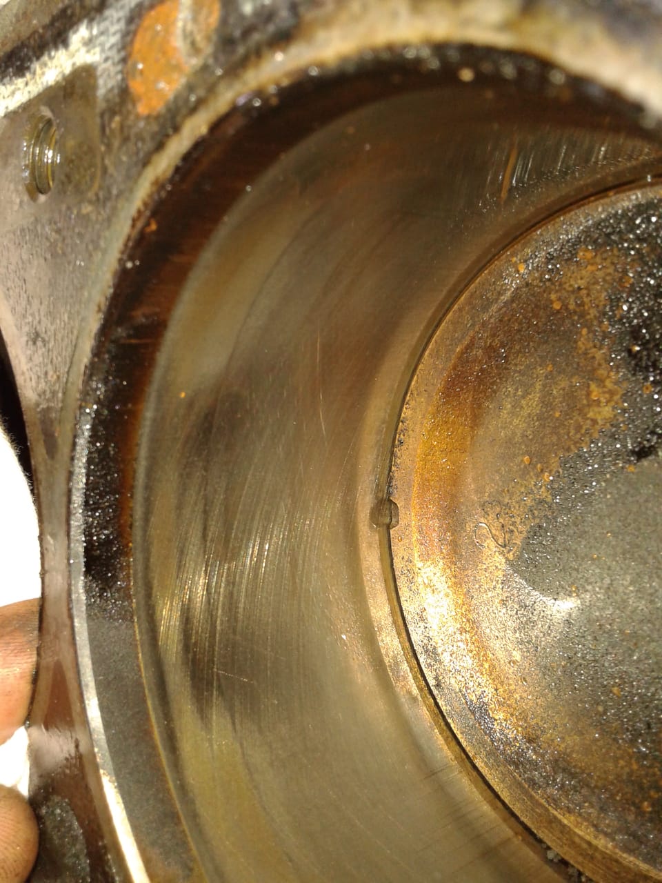

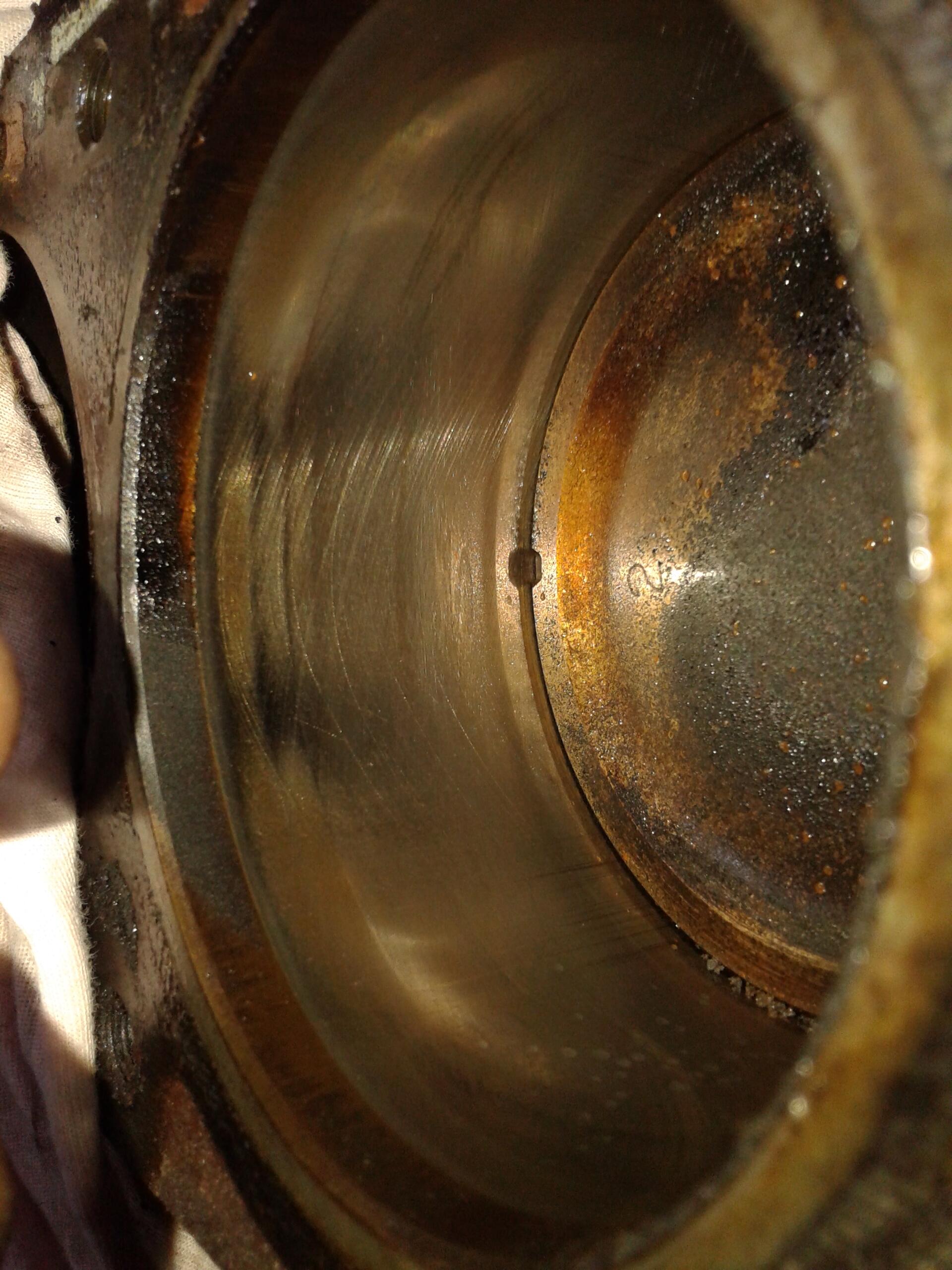

June 23, 20231 yr comment_654428  1 hour ago, Ownallday said: the cylinder walls are polished, slightly glazed Hi, That's not good, they should look like these.. this L28 is now 44 years old and these pic are 3 years old.. It has run 119000 km (i'm sure about the km's) and in excellent condition if you ask me..  When your cylinders are glazed and polished looking just a quick hone is not gonna help.. The walls are gone.. You could test the diameter of the cylinders first and look if they are perfect round, inportant spot to test is the lower diam. of the cyl. There where the skirt of the piston sits. if there is any oval you need a rebore.. and new pistons. and yeah it is/can be a expensive hobby. 😬 Have you also done a compression test, a leak test etc.. it can help a lot to know in what condition your engine is.. Maybe some pictures of your cyl.walls? and what you think the engine has run (Mls) ?  Edited June 23, 20231 yr by dutchzcarguy Link to comment https://www.classiczcars.com/forums/topic/68401-l28-rebuild-help-for-1978-280z-honing-vs-boring/#findComment-654428 Share on other sites More sharing options...

June 23, 20231 yr Author comment_654435 7 hours ago, dutchzcarguy said:  Hi, That's not good, they should look like these.. this L28 is now 44 years old and these pic are 3 years old.. It has run 119000 km (i'm sure about the km's) and in excellent condition if you ask me..  When your cylinders are glazed and polished looking just a quick hone is not gonna help.. The walls are gone.. You could test the diameter of the cylinders first and look if they are perfect round, inportant spot to test is the lower diam. of the cyl. There where the skirt of the piston sits. if there is any oval you need a rebore.. and new pistons. and yeah it is/can be a expensive hobby. 😬 Have you also done a compression test, a leak test etc.. it can help a lot to know in what condition your engine is.. Maybe some pictures of your cyl.walls? and what you think the engine has run (Mls) ?  Hello, basically what I'm fearing. What I thought would be a $500 job is turning into thousands 😔. To my eye it looks very slightly glazed. I know the engine was running prior as I bought the engine off a YouTuber and he had video of this engine running good. I will provide some pictures maybe you can give some insight based on the pictures. Have yet to remove the pistons so the measuring will have to wait another week or two depending on what happens. I have not done a compression test based on the fact that I recently bought the engine from someone but I just know it was running good based on what the guy showed me.  Link to comment https://www.classiczcars.com/forums/topic/68401-l28-rebuild-help-for-1978-280z-honing-vs-boring/#findComment-654435 Share on other sites More sharing options...

June 23, 20231 yr comment_654438 As mentioned, accurate measurement is paramount to deciding what needs to be done when reconditioning an engine. Disassembly, cleaning, and then measuring the cylinders, rods, pistons, crank, deck, bearing journals, cylinder head surface, valve guides, etc. I see some scoring in at least one cylinder, can you catch a fingernail in it? Also, the engine has a lot of carbon buildup on the pistons, and in other pictures there is evidence that this is a high mileage engine, and that it didn't see regular oil changes. Without actually doing the above, I cannot say what needs to be done, but it does look like the engine will require more than a ball hone on the cylinders and slap it back together. Â Find a good machinist who is familiar with the L series engine, and have a discussion about your expectations and budget, and what needs to be done. Â Link to comment https://www.classiczcars.com/forums/topic/68401-l28-rebuild-help-for-1978-280z-honing-vs-boring/#findComment-654438 Share on other sites More sharing options...

June 23, 20231 yr comment_654442 I agree with the others on the wall condition. Vertical lines would concern me. Possible ring scratches or skirt dragging. Also the mottling at the top of the cylinders concerns me. Not really sure what that is, possible corrosion damage? I absolutely agree with Racer, that its hard to tell what the engine really needs with out Mic'ing it. Also be careful on grinding the crank. I had a hard time finding over sized bearings on a L20 build Link to comment https://www.classiczcars.com/forums/topic/68401-l28-rebuild-help-for-1978-280z-honing-vs-boring/#findComment-654442 Share on other sites More sharing options...
