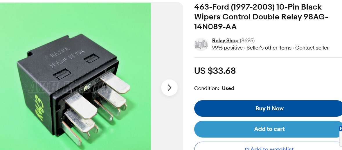

I mean, after all... The biggest improvement you could make to the original system would be to come up with an easy way to get variable speed intermittents, but that module has a fixed 7 second delay and would be no better than what we already have.

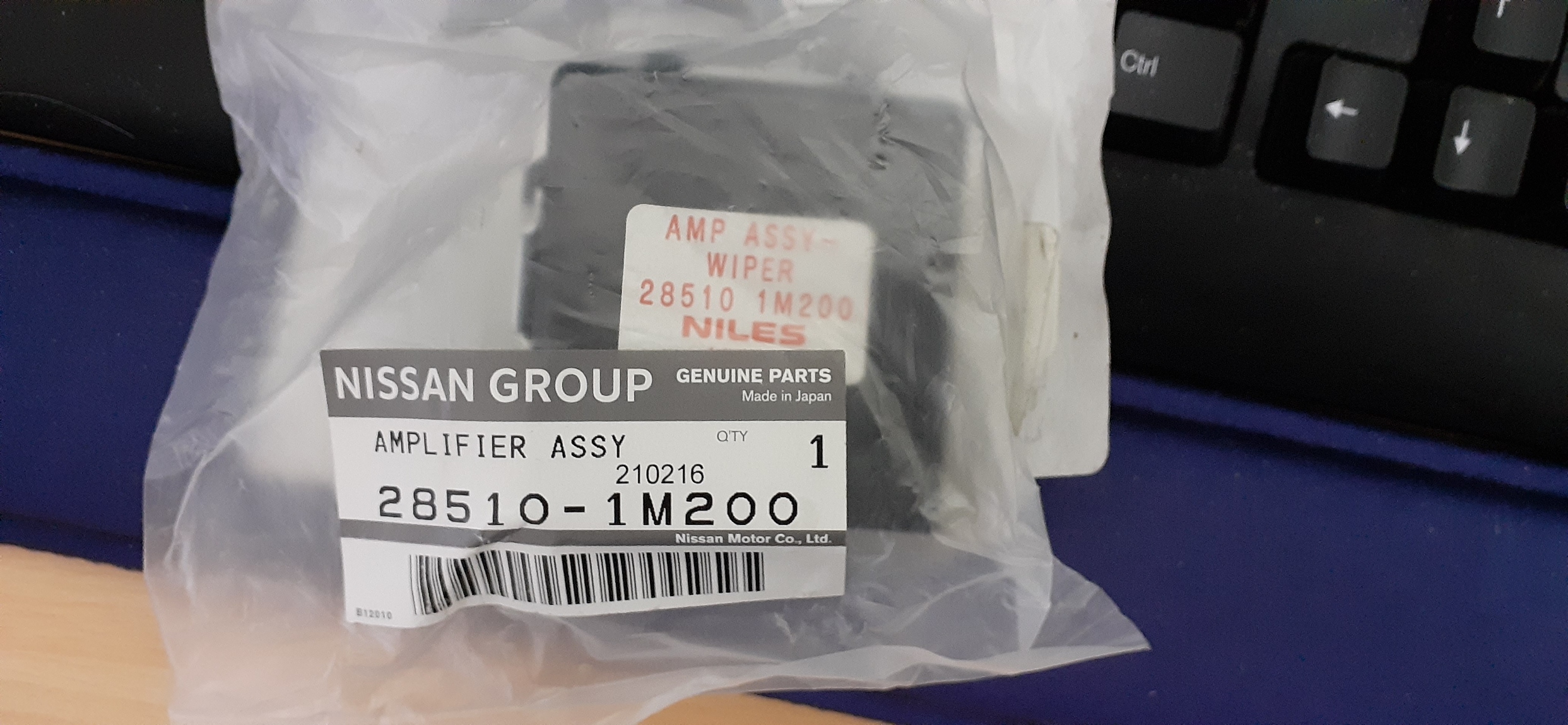

It doesn't have to be an improvement. It just has to work. I know of at least 3 Z cars in my area that are having problems because the amplifier failed. Since the original is NLA, if I can get this to work, people will have functional wipers.
I have looked at other intermittent relays, but this will probably be the best way to work with existing wiring.

https://www.ebay.com/itm/265485270180?mkcid=16&mkevt=1&mkrid=711-127632-2357-0&ssspo=pCKhnAvpQCe&sssrc=2047675&ssuid=&widget_ver=artemis&media=COPY

Yes, the plan is to make a harness go to between the factory harness and the amplifier.
