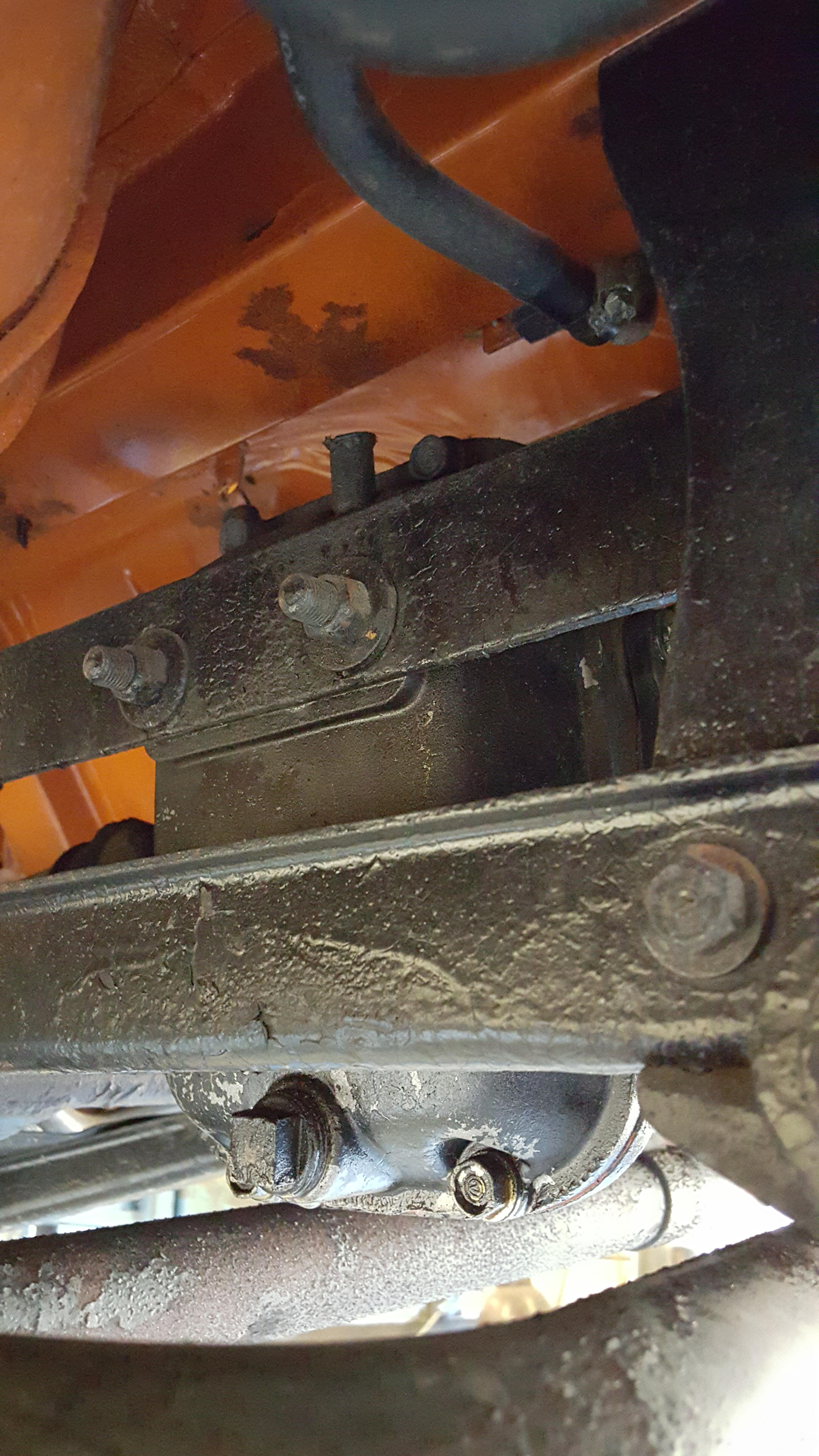

Hmmm. That's an open R180 where a 4.44:1 2-pinion LSD R192 should be.
Better make sure that's mentioned when it comes up for sale, otherwise your description that the car "...showcases originality and authenticity..." might not turn out to be as accurate as a buyer would hope.
