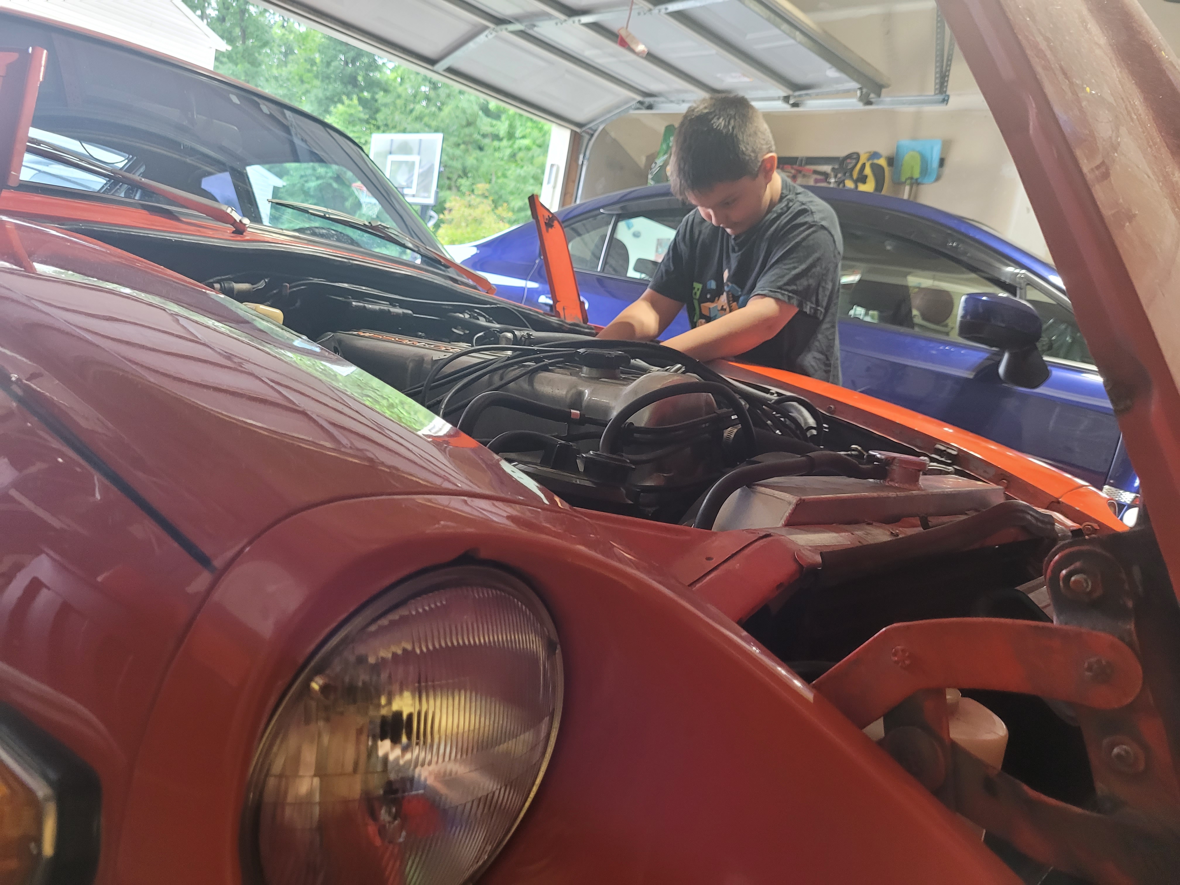

  On 7/1/2023 at 11:11 PM, Paulytunes said:
Looks like he is fiddling with the brakes.
Next thing he will be wanting to auto cross the car.
Looking forward to updates as your journey unfolds.
I think he was looking at the washer tank and was fascinated that the pump was located on the bottom of the tank.  Although he did as me about the brakes shortly after I snapped the photo, so he could have very well been looking and thinking about them at that point in time.  Yes, I am sure PJ will want to learn how to drive it and will likely want to drive it as soon as he is able.  I think if I do let him take it out, I will either need to have some sort of intricate surveillance equipment installed or I will just be on pins and needles.  Of course, he will need to learn how to drive stick first, but I am certainly not going to let him learn on the Z!

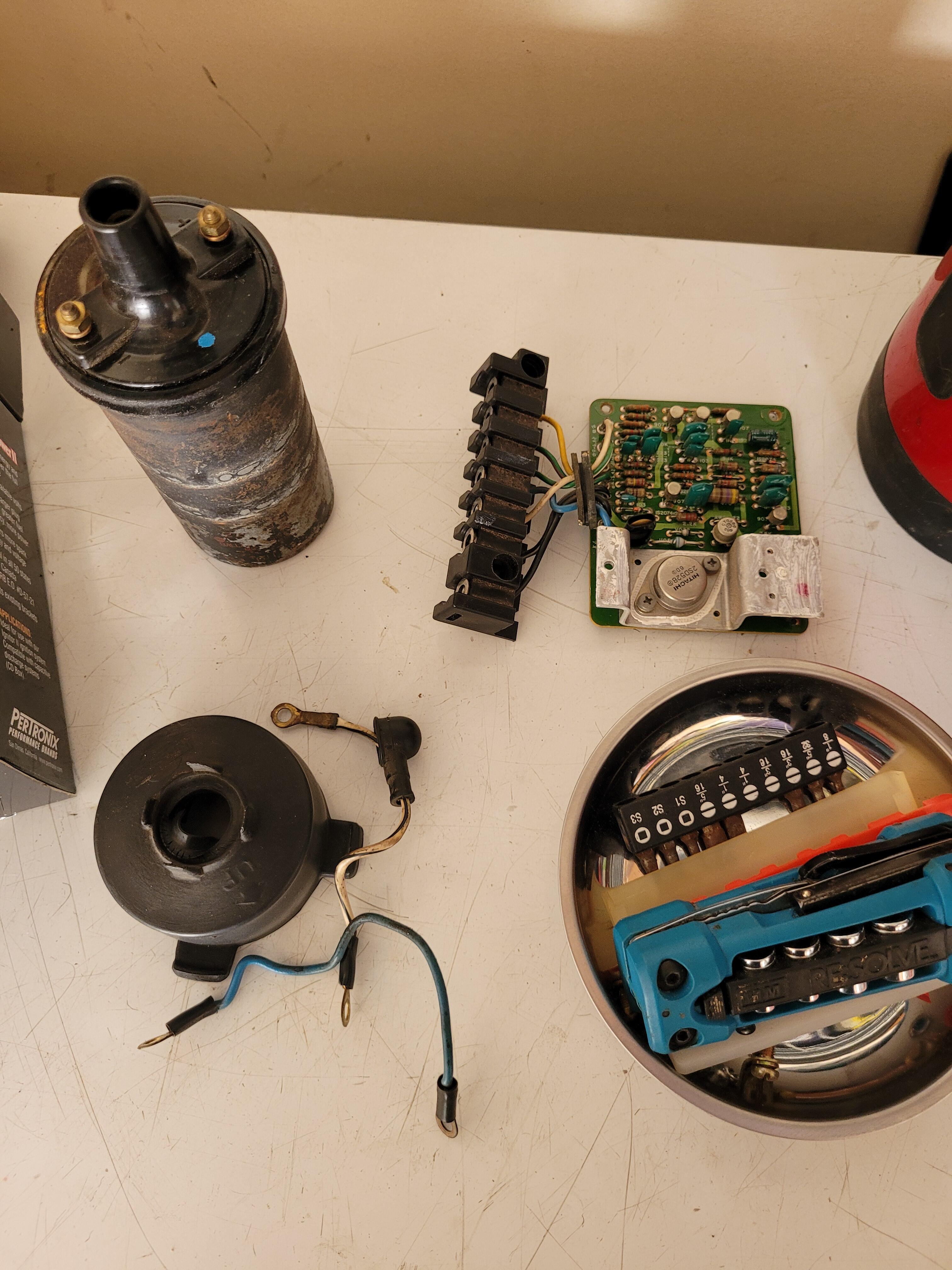

So today marked a huge milestone - I was able to fix my ongoing, intermittent hesitation and poor operation of my 280Z!  Many thanks to a lot of help from my new friends on this forum and a lot of persistent troubleshooting and eventual replacement of suspect components.  As it turned out, my ignition coil was bad - when I tested the resistance, I was getting high and inconsistent values.  I also ended up swapping out the TIU with an HEI module.  The final step was bypassing the resistor and connecting directly to the coil.  Now the question is what to do with the replaced and not reinstalled parts?  Maybe I will make a museum of my old car parts.  What started as a joke, I saved the idler pulley bearing that self-destructed and destroyed my timing belt in my 1986 Toyota Camry back when I was a poor college student.  I also saved a few of the broken lug nuts and stripped lug studs from my current WRX (don't get me started on these, it's an ongoing QC issue every time that swap my summer and winter wheels.  I am convinced Subaru used low grade, crappy aluminum lug studs as a cost saving measure and failed to instruct their dealer technicians to not to use air wrenches when rotating the tires or they could strip out the lugs.  Maybe I will finally be rid of this problem when I have replaced each and every one of the lug studs.).  I have never had this problem with any other car, present company (2017 Sienna, 1976 280Z) included, as well as previous Subarus.  Ugh.
