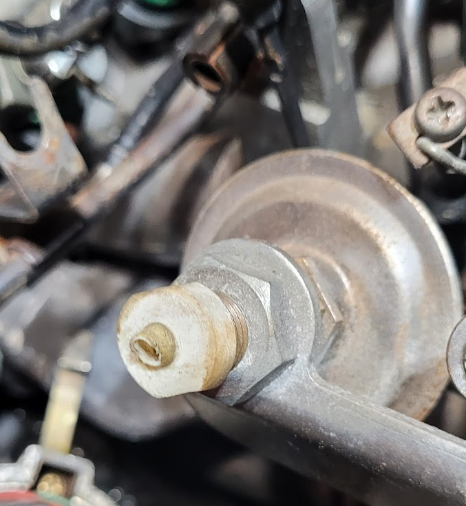

  1. I stupidly broke the plastic nipple on the stall dashpot while connecting the thermostat sensors and wiring:image.png
  2.  Idling is pretty high, around 2000rpm at cold start.  Occasionally, it will adjust down to 700 to 800 rpm and will sometimes stall.  Other times it will stay at 2000 rpm, unless I drive it and can force the RPMs lower with the gearing.  When I take it out of gear, it shoots right back up to 2000 rpm.  May be due to the temps here, which were between 55 and 60 degrees F today.
I was able to temporarily fix the dashpot and reconnect the vacuum hose to it using a smaller diameter tube to insert into the part of the intact plastic and the vacuum hose until I can source a new dashpot assembly.  I'll continue to diagnose the high idling and see if this is due to something I am overlooking or a symptom of my rebuilt ECU not performing up to OEM standards.

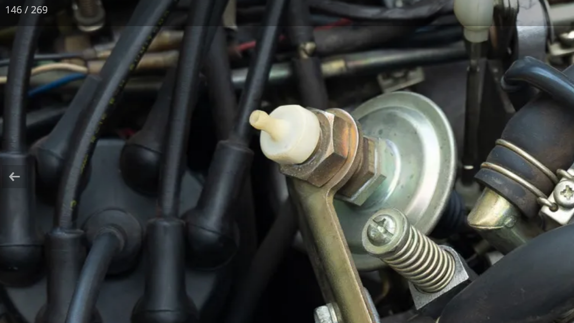

That nipple shouldn't have a vacuum source connected to it, it should be open to the air.  It's a common mistake.  Don't know why Nissan designed it that way.

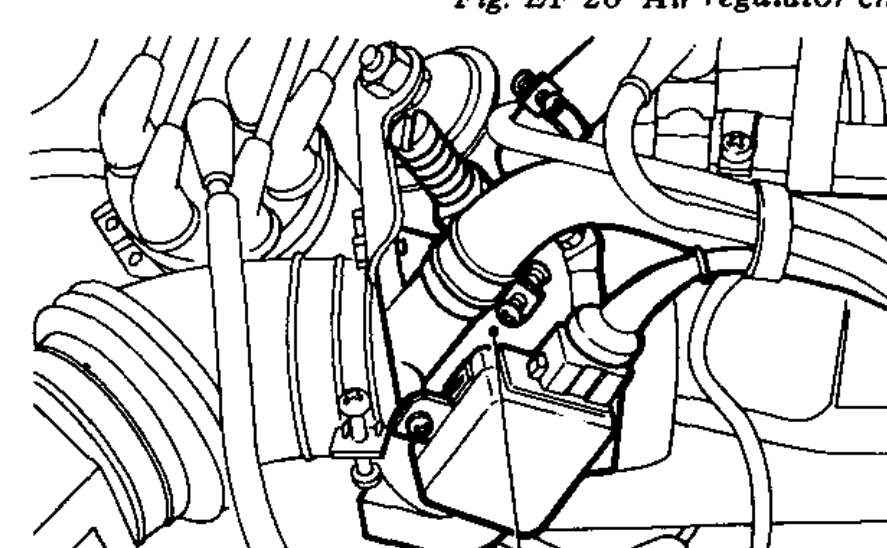

Here's a drawing of the dashpot with no hose connected.
Thanks, I'll look into that.  So should that vacuum house then be open to the air or connect to something else that I am not seeing?  There's a three way tee, which was always connected to the dashpot nipple, a vacuum port on the bottom of the AFM, and also to the charcoal canister vent on the other side of the engine bay.
The dashpot connection does indeed seem to be common, many other L28 engine photos online show it connected.
